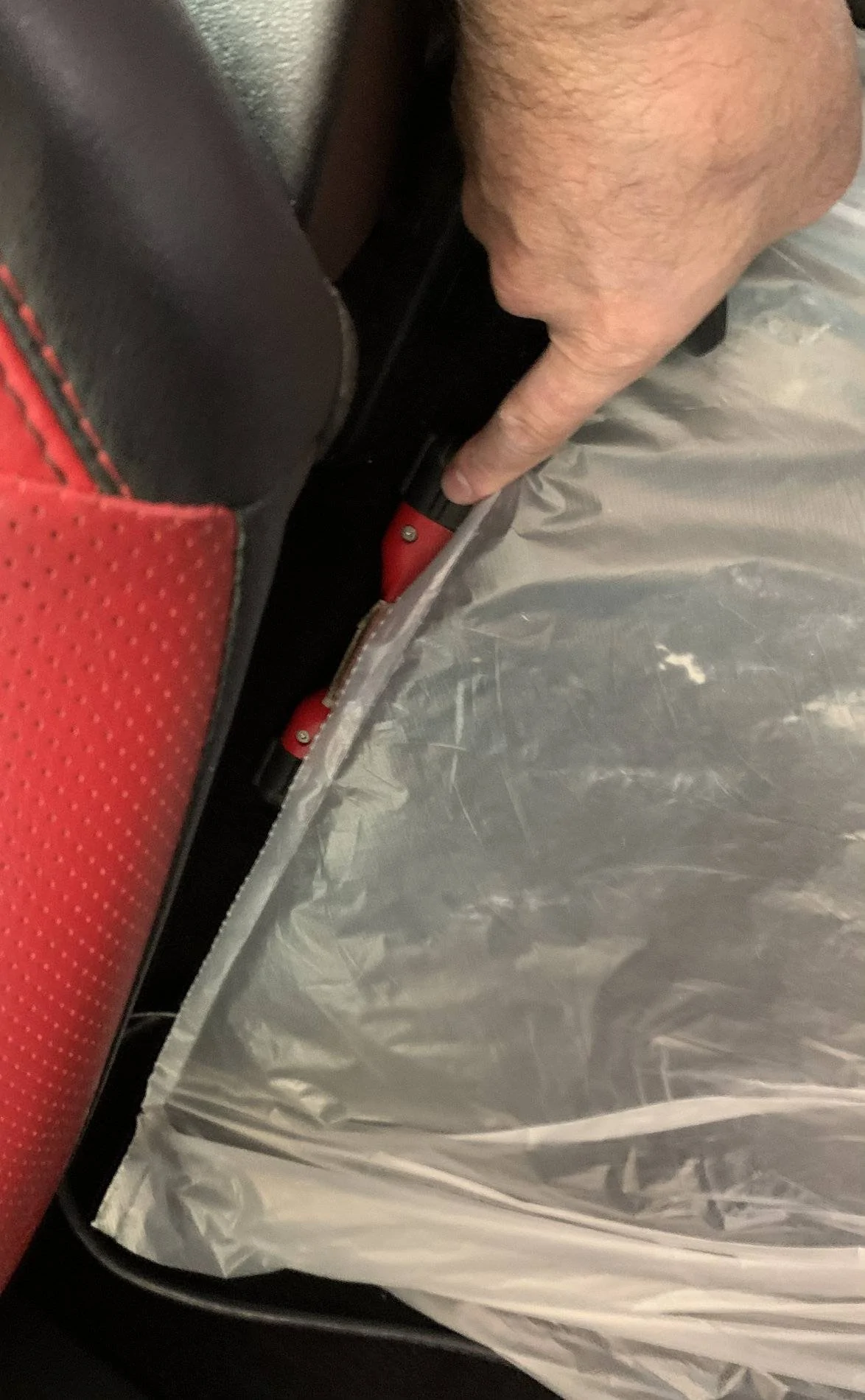

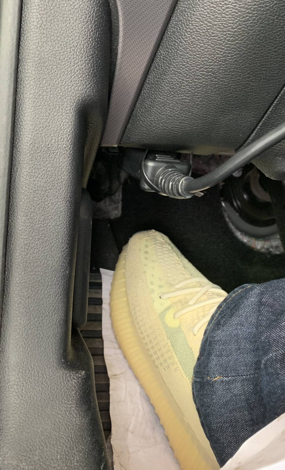

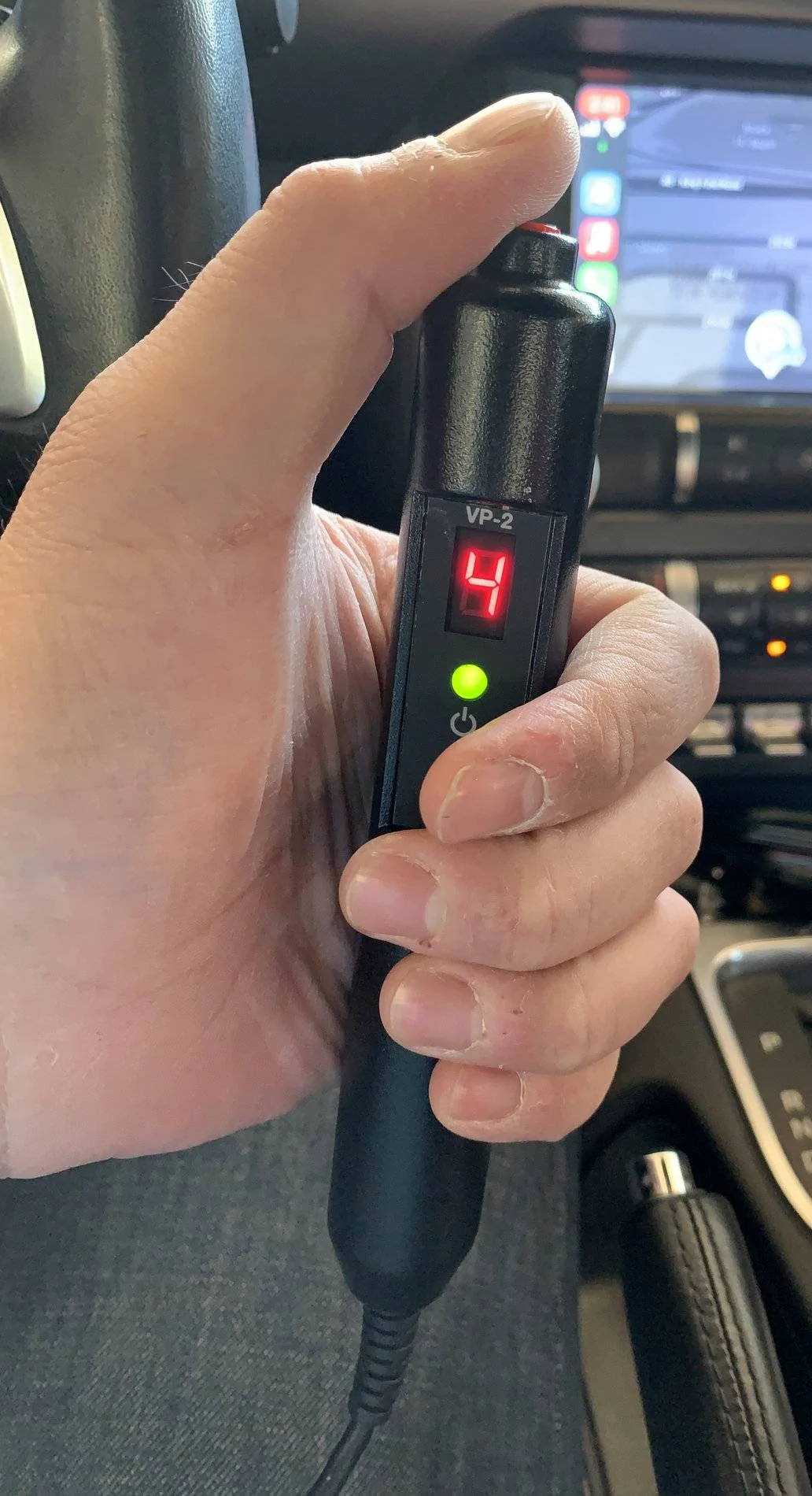

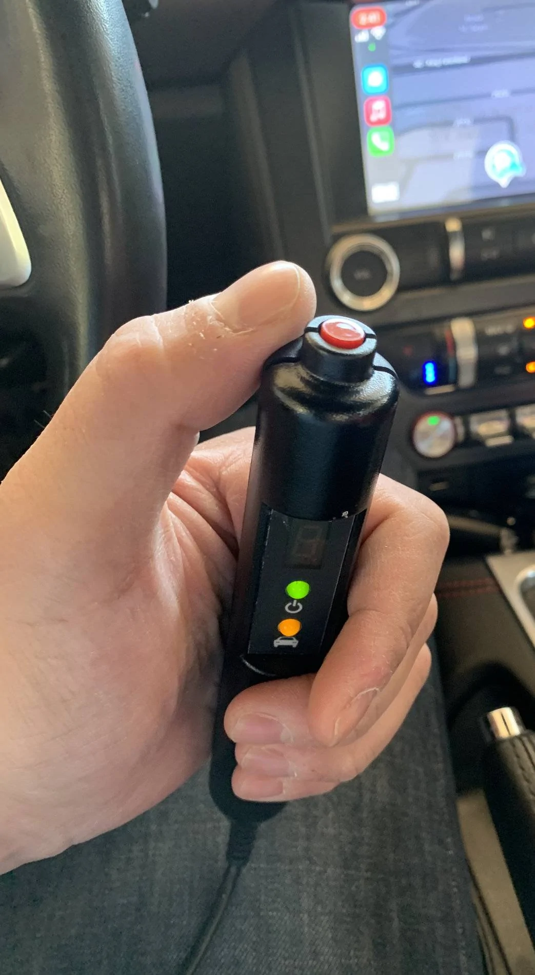

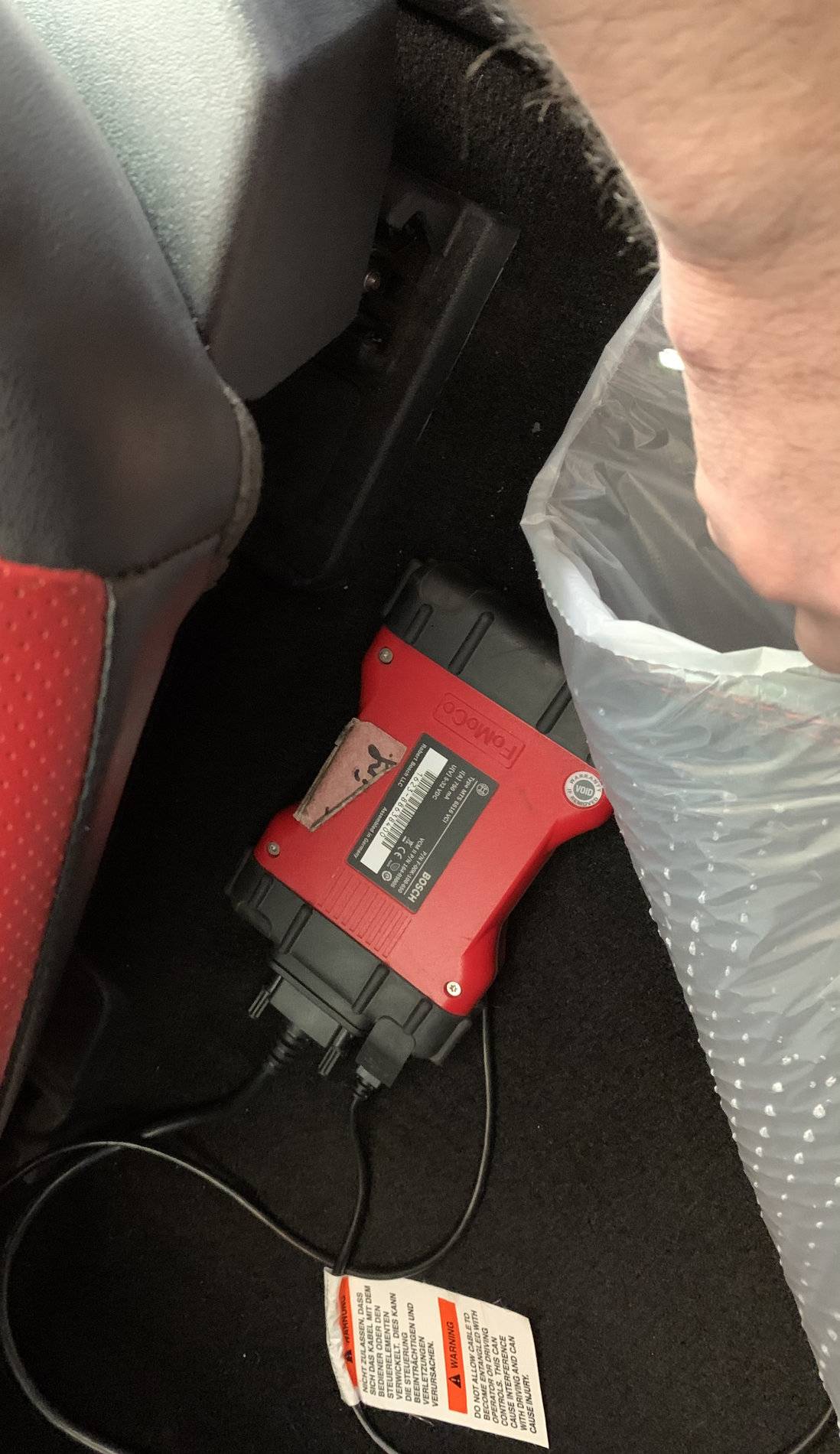

Hi Guys,
The dealer here in my country (KUWAIT) contacted Ford USA and Ford told them to install an OBD that can log the issue, the device can log 15 sec before the issue happens and 10 sec after the issue, so they can play back the log and see what's going on. I managed to capture the issue and they admit that there is something wrong is going on but the dealer couldn't find the issue, they told me they will contact Ford USA hot line and see what Ford will say about the stalling issue, I also installed a GoPro to capture the stalling and managed to capture it as well.
Will wait for Ford to reply and hope they will have a fix.
Attached the OBD device pictures and all the videos I recorded while stalling in drive mode and in reverse, I also attached some videos showing the noises I am having and the RPM fluctuation when I come to stope while the transmission in drive, it seems to go away if I put it in neutral or park.
Sorry for the videos, its in Arabic, but you can see the stalling and all the other issues while happening....
Will keep you updated :)
