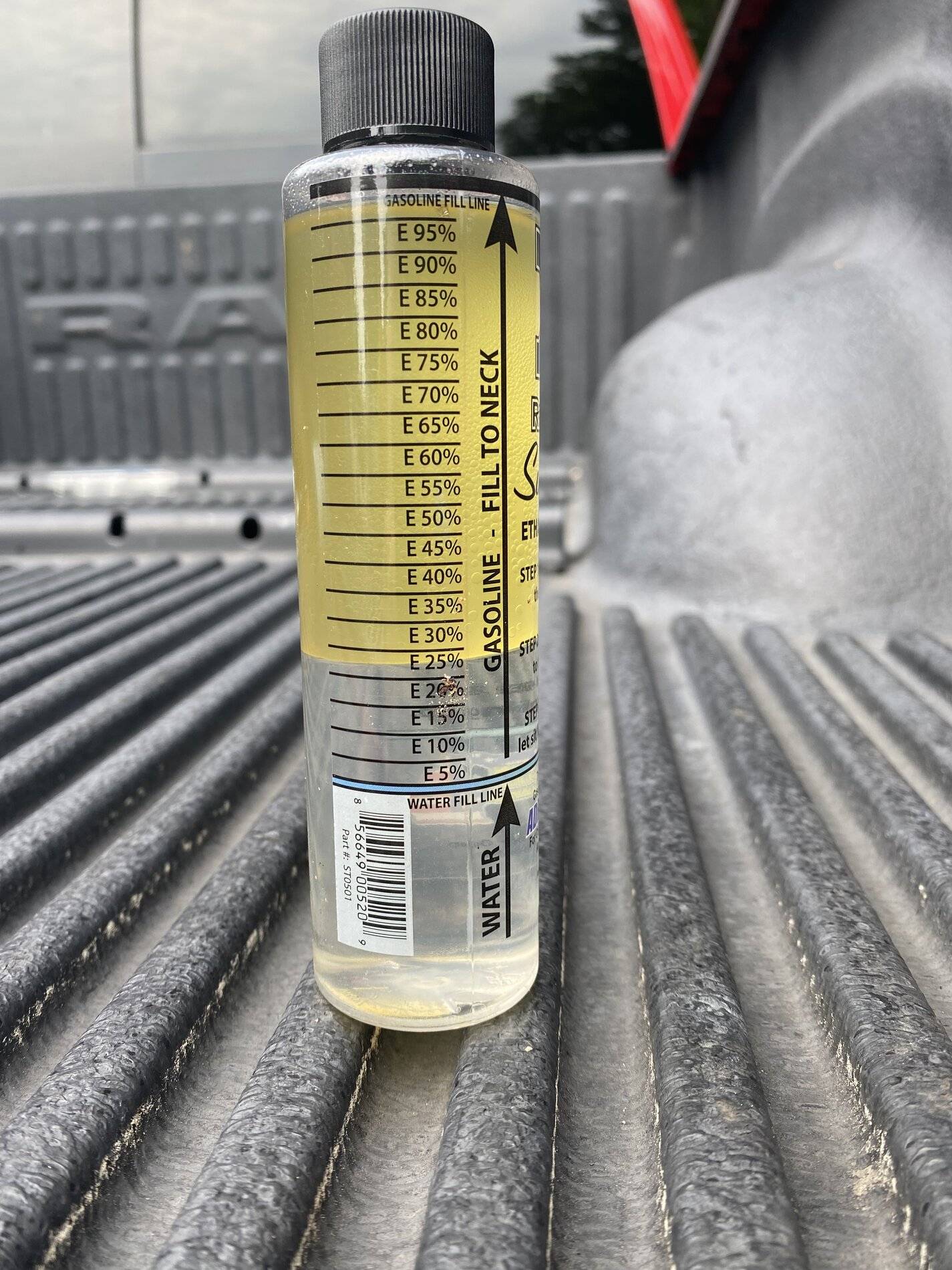

So the winner is - 22-24%...bad gas (for supposedly e85). So far, the good news is after draining the fuel and about 15 miles of driving, all seems to be returning to normal.
Again, the best answer found for draining the tank was disconnecting the fuel rail on the passenger side, and if tuned, having the tuner provide a "pump only" tune. Takes maybe 6-7 mins for a full tank to drain. In our case, fill with 10gal of 93, water and injector cleaner additive. Then never buy from that particular gas station again.

That doesn't look good at all. It looks like it’s trying to form those mystery goo balls in the test tube. Glad to hear that it’s clearing up for you since the tank drain. How many tanks of 93 and injector cleaner will you run through it before putting the car back on E85?
