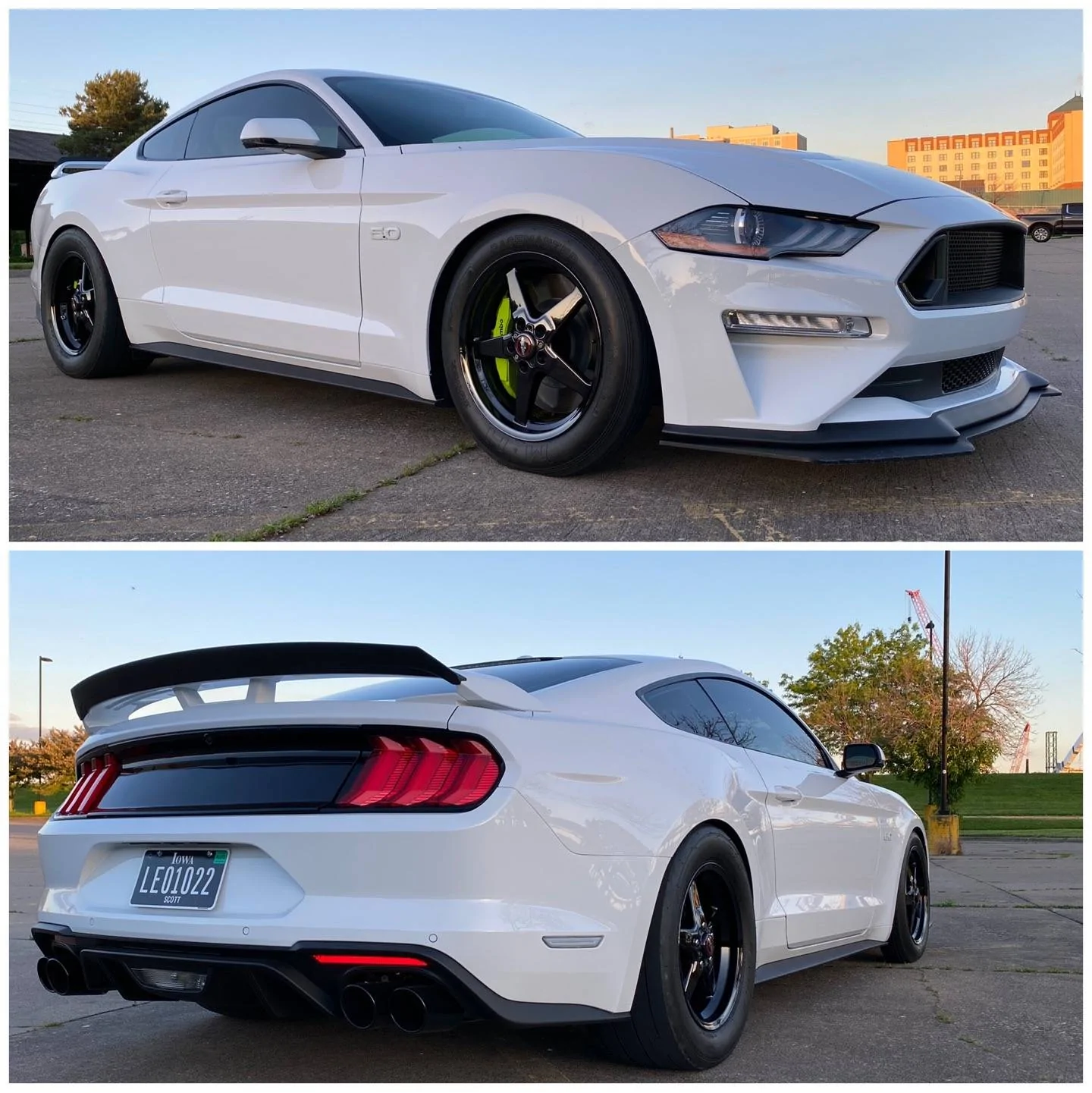

I was running 4.50x28-18 MH racemasters with bmr drag springs and actually was a lil lower due to the weight of the whipple. I had zero issues with clearance. My wheels were racestars.

here’s a pic for ref

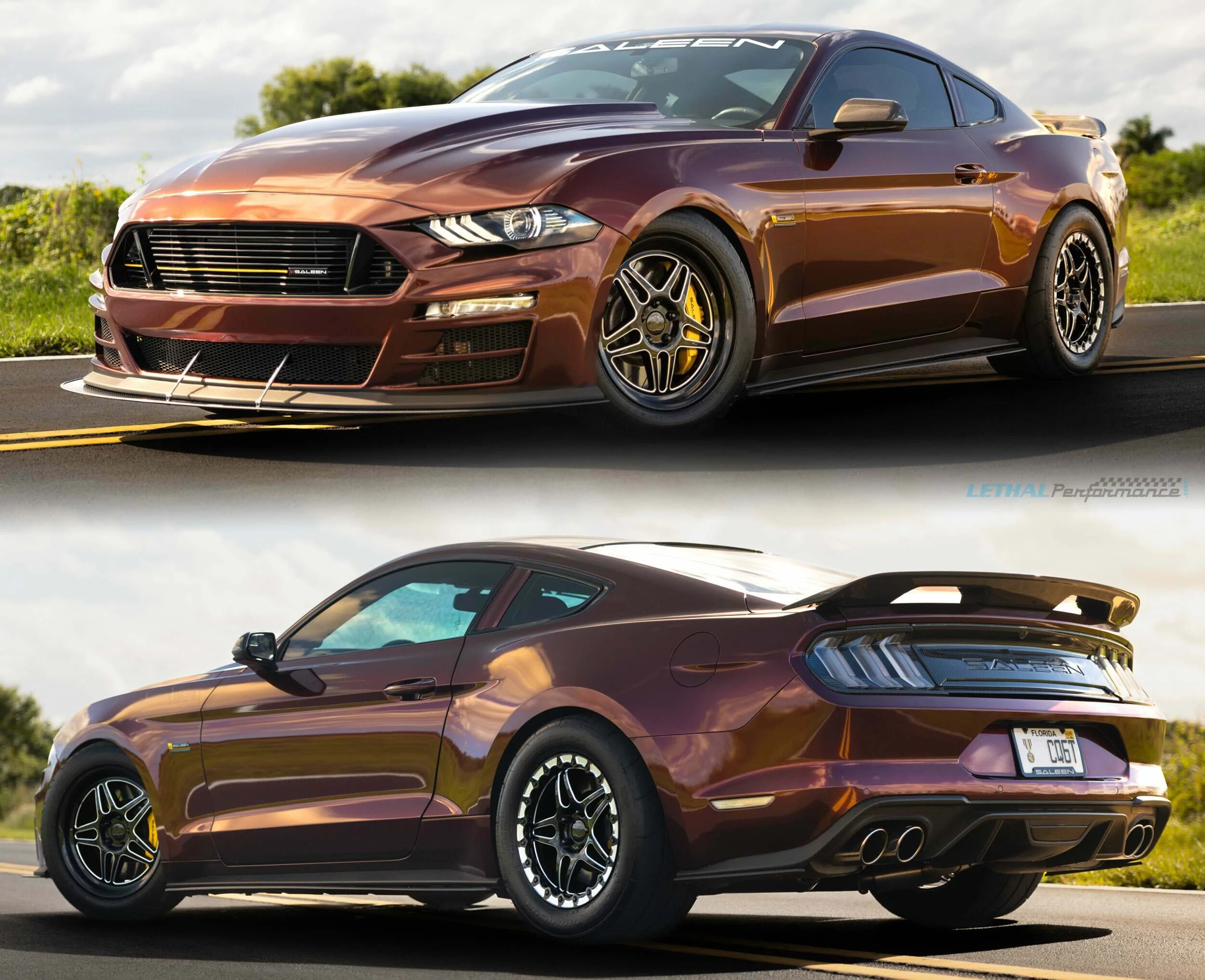

I wouldn't go lower than a 1" spring. That is what I have on mine and a 28" skinny fits.
But any drag spring will work. Just have to make sure you get the correct on for magnaride or regular.

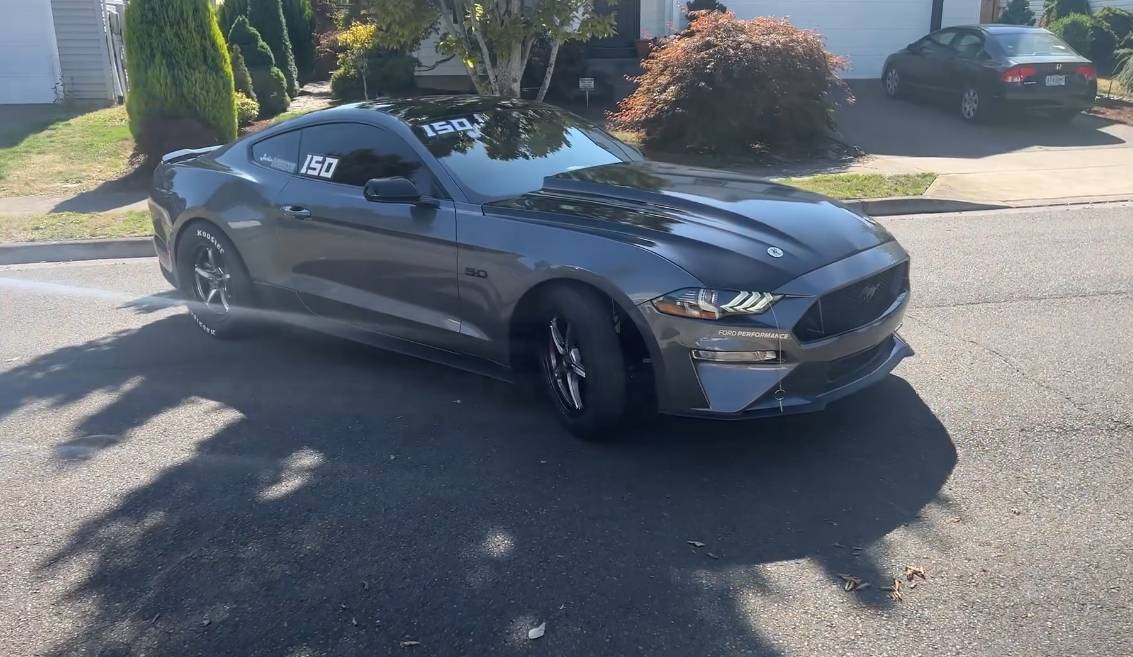

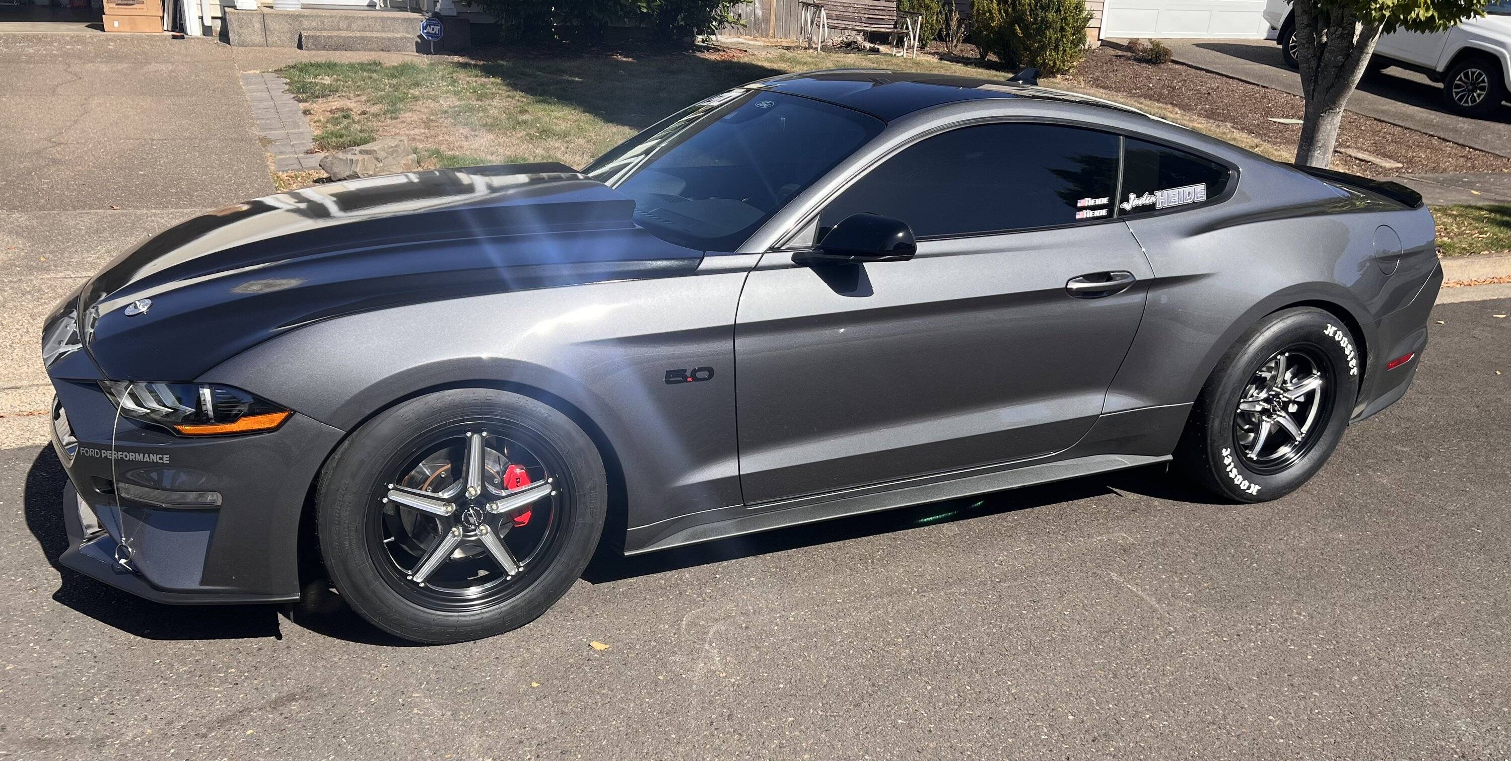

I run BMR front drag springs with zero issues. Billet Specialities 18x5 with MT 28x6/18.
