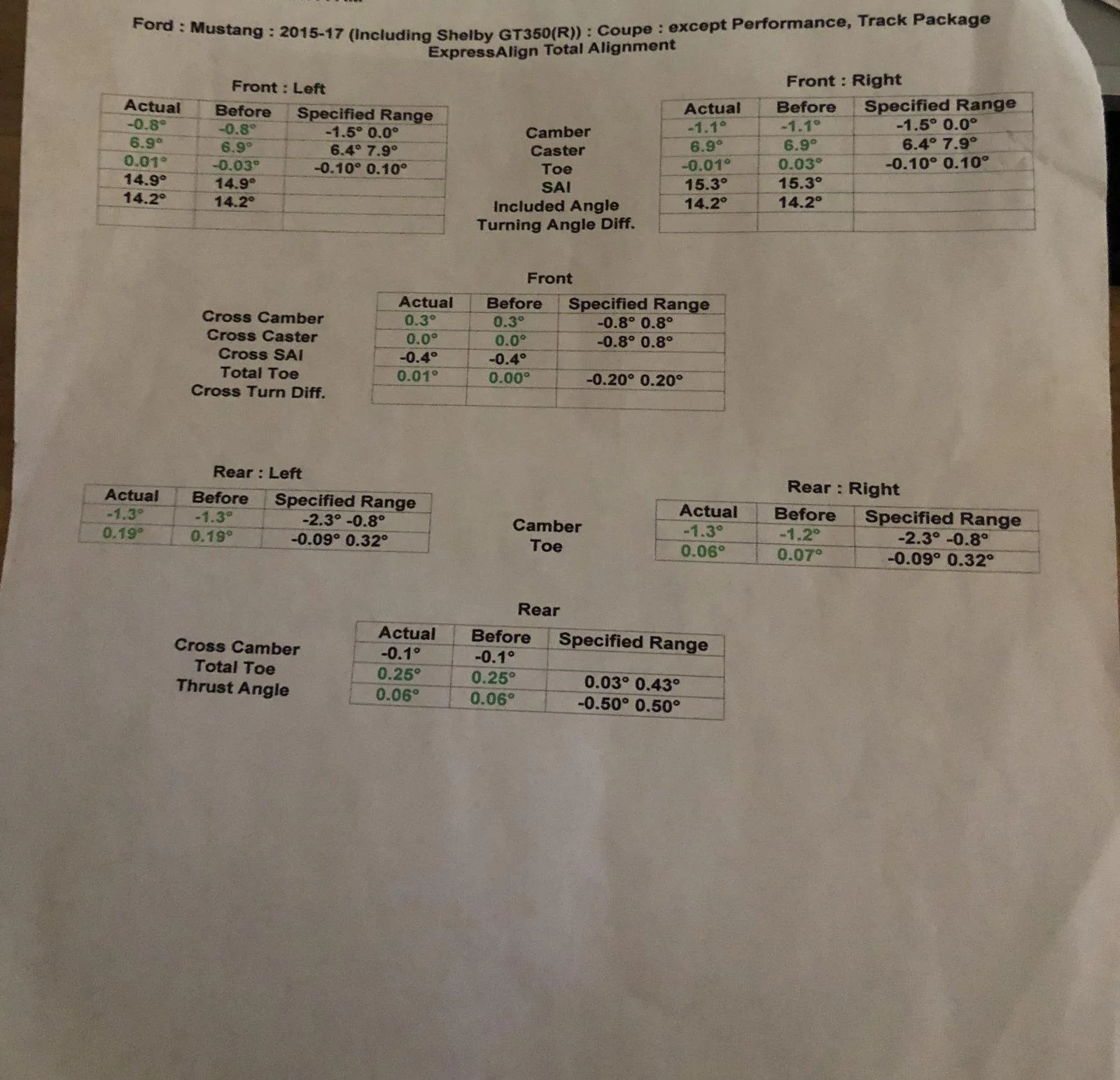

Do you have a copy of your alignment sheet handy? Please post it if you do.

here is the alignment sheet
thanks
Your thrust angle may be the problem. While 0.06 isn’t huge, it should be 0.00. Positive thrust angle will cause the car to steer left as I recall. I good alignment shop can square you away, and certainly can get your rear-toe symmetric.
appreciate the answer. I will look in to it. If positive thrust angle actually causes left pull I will mention this to the dealer. since they did the alignment, I will try to go for a free alignment correction.
you are right! this is what I found:
"A positive thrust angle will try to steer the vehicle to the left, while a negative thrust angle will try to steer the vehicle to the right. This will cause the driver to pull the steering wheel right or left to compensate."
Now the question is 'can 0.06 in +-0.5 tolerance cause this?'
hopefully the dealer would take me seriously.
