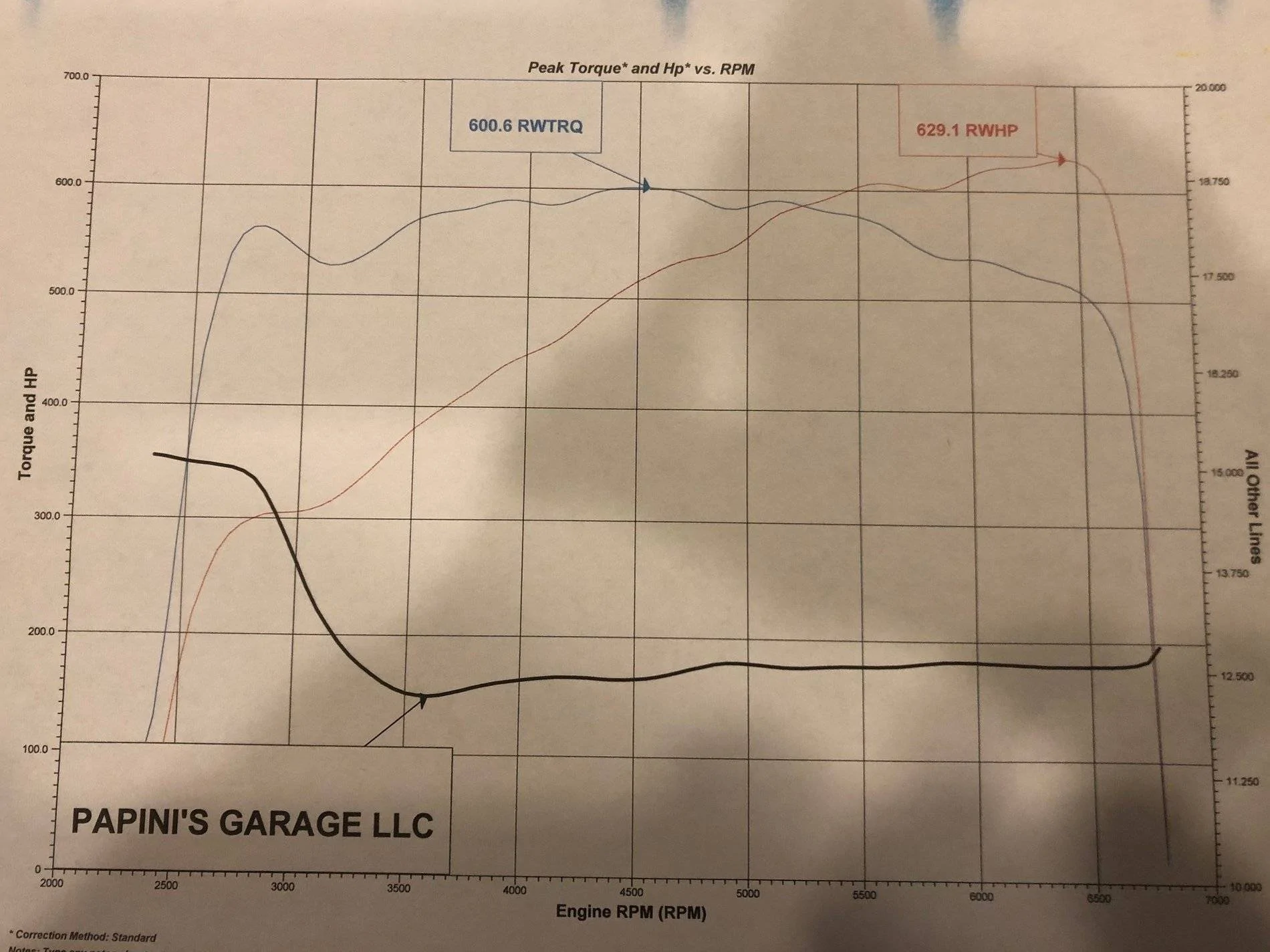

I'll try to at least provide you one of many answers. Here's an out of the box Edelbrock 2650 Stage 2 on a bone stock 2020 A10 car with Edelbrock 91 tune (no octane booster). It will not be an apples to apples comparison with other FI setups run on different dynos, but at least shows you the power curve.

Thank you Patriot Six.
Looks like an instant torque monster. Must be hard to hook up on the street if you stab it?
I also have an A10 car, so my question is this, does the box tune ever even allow the car to dig itself out of a gear or does torque command (read:load vs tps) have it downshift immediately? At that point is it a violent tire shocker?
Thanks for your feedback.

The EB tune is straight garbage. You need to go to almost 90% throttle position to get the car into boost and/or to get the tires to break loose. The car will downshift in order to accelerate faster.
I'm currently on a Lund tune and it makes boost instantly even though I'm running a larger blower pulley making 2psi less boost. Car picked up 25 rwhp/tq with the Lund tune on less boost. Car hooks pretty well right now on NT05Rs.
