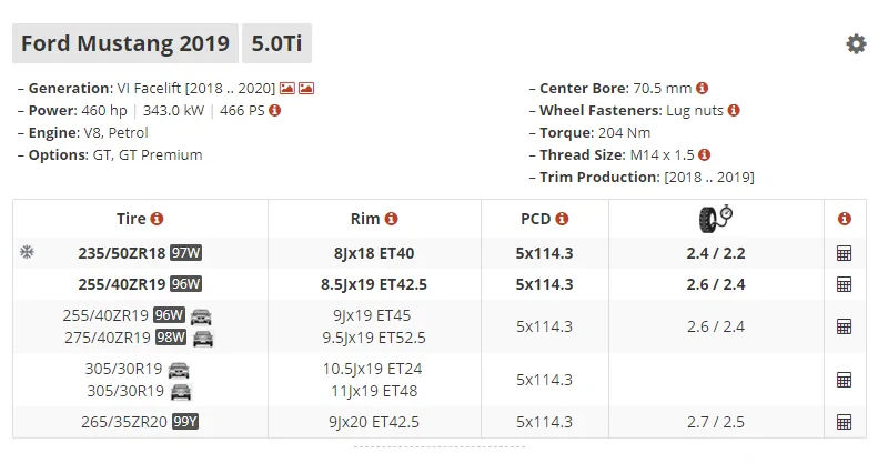

Found this...(ET = offset)

It's actually +24 front and +48 rear, pretty big difference from -24/-48. I've read there are front clearance issues on a non PP2 as the PP2 uses a different wheel well liner. 295/30/19 would mate to the front 19x10.5 no problem, but I don't know if this would be enough to eliminate any rubbing.
Sounds right I remember before the PP2 was released there was a part number for fender well liner on the ford parts site for it.
Yes +24 and +48. Not sure why I hit the -.
I do know someone who put on a factory set of pp2 wheels on a 16 and had no issues, but who knows about lock to lock reversing out of a sloped driveway?

I can’t say if they will or won’t work as I haven’t had them on my car, but I have oem gt350 wheels and they fit no problem. And they’re sporting 295/35 and 305/35 instead of 305/30’s so you’re definitely looking at a shorter wheel/tire diameter. The front pp2 wheels are 6mm more aggressive and the rears are 14mm more aggressive than the gt350 wheels. I would think that even with the wheels sticking further out because of the offset, the decrease in tire sidewall should allow it to still fit without rubbing. If you don’t mind a little poke, once lowered and with some camber, I think they’ll fit nicely. A member on here I believe got a set of pp2 wheels refinished in silver from Midwest Wheel and Tire and they look incredible. According to their site, they’ll set you back about $2k

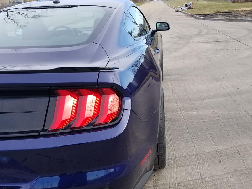

My Replicas poke on the rear slightly because of the 325 tires. No poke at all in front, just flush.
