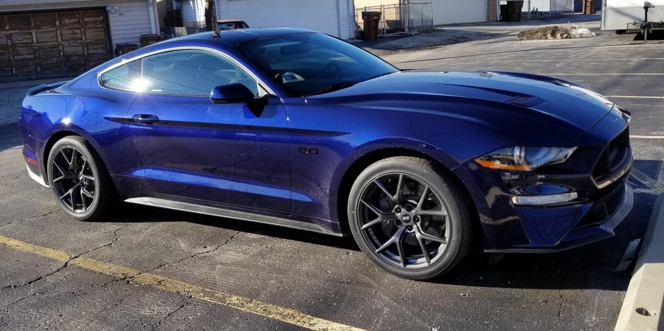

if I purchase the 19x10.5 and the 19x11 wheels from Ford
Any reason you want the OEM ones instead of the lighter SVE SP2 that comes in more color options? Fronts from them are only 19x10, but other than that they seem better to me.
I went with the Lighter SVE SP2's. Glad I did.

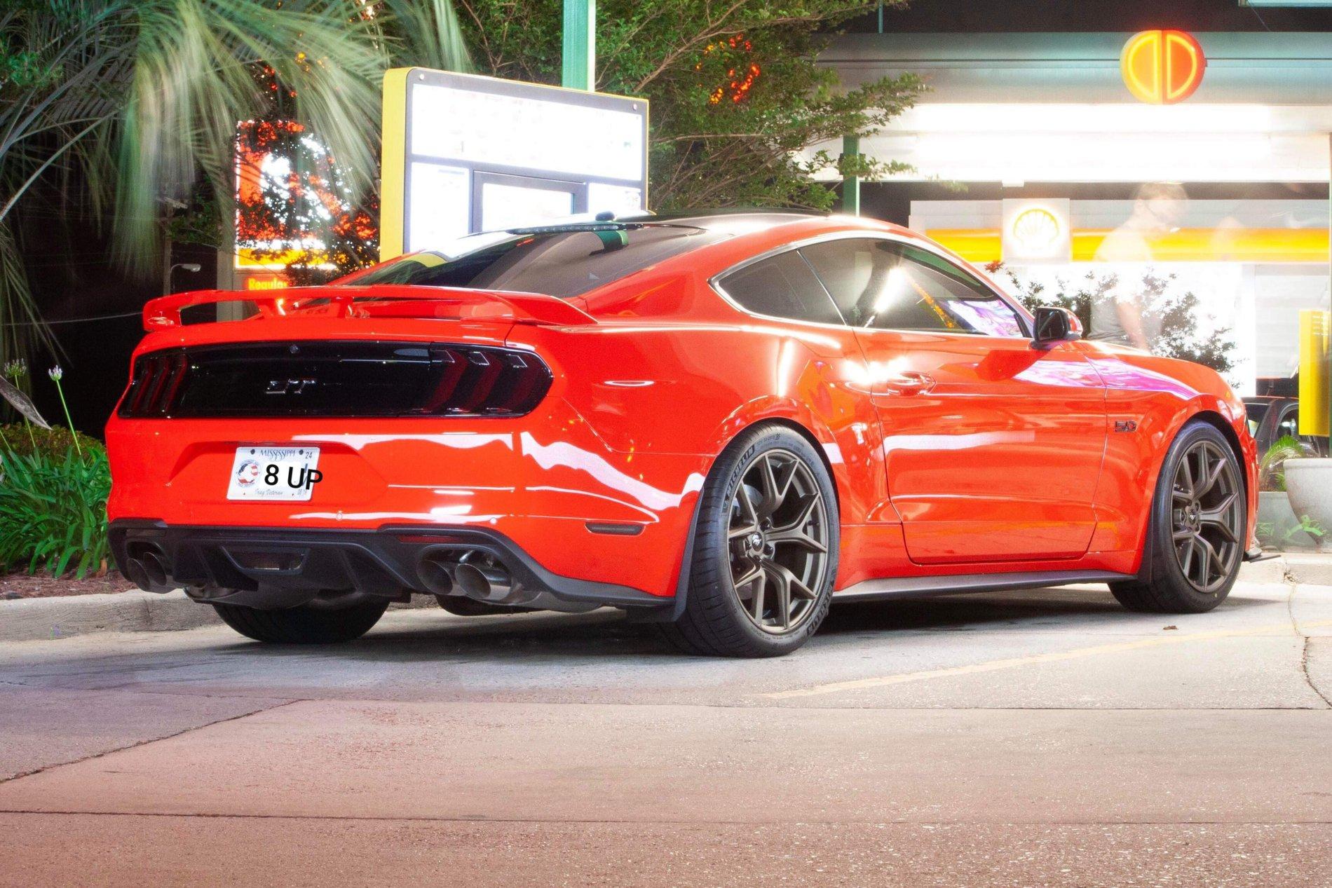

Those look great but still have a little too much poke for my tastes. Does anyone make a repro with similar fitment to the stock PP1 wheels?
You must not have looked at a PP2 then LOL, look at the front wheels. They use GT350 fitment without the wider fenders
Fitment is more apparent when the car is lowered like these example from the thread.
Some do seem to stick out a tad, but you can address that with some camber.
