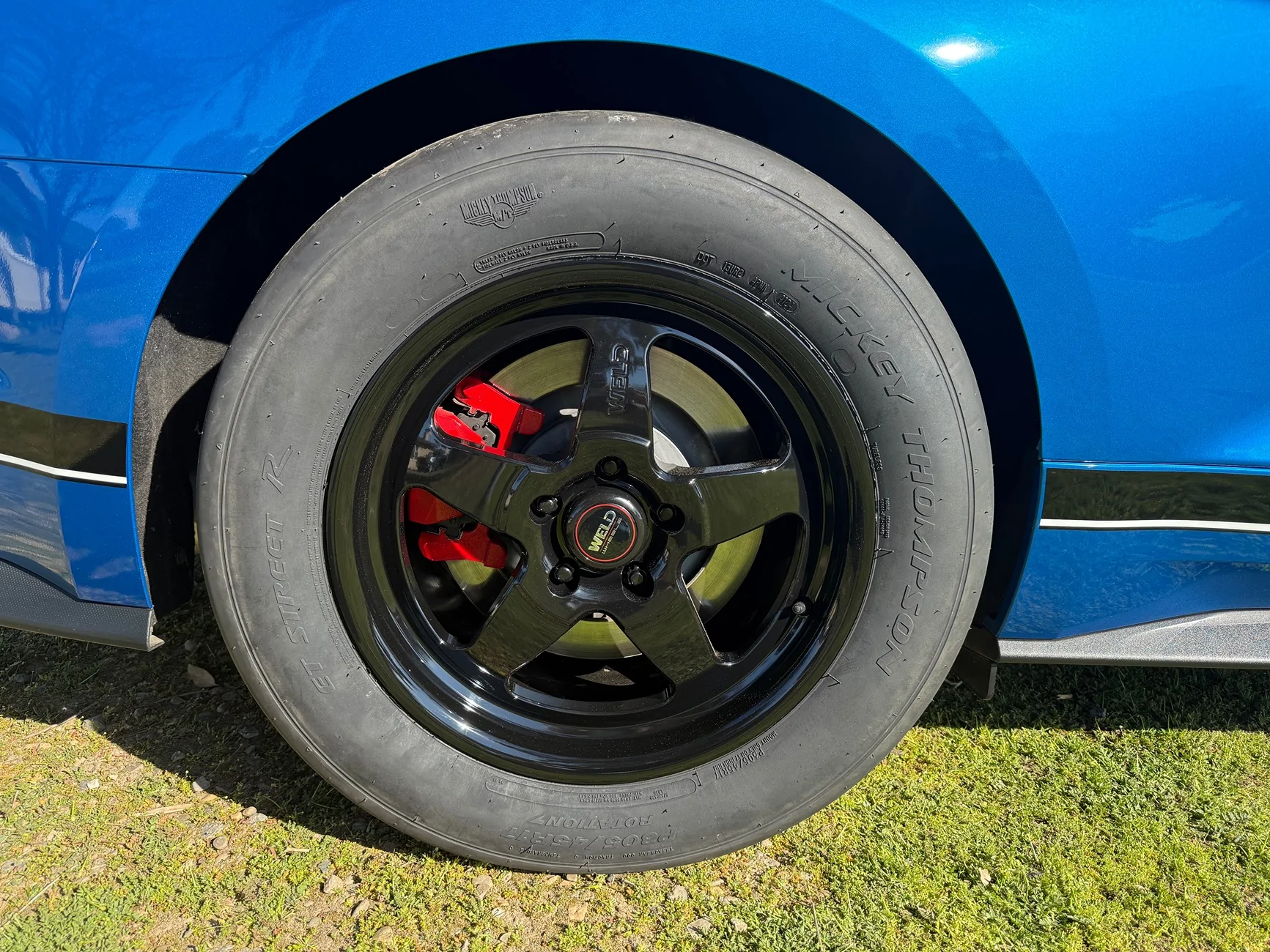

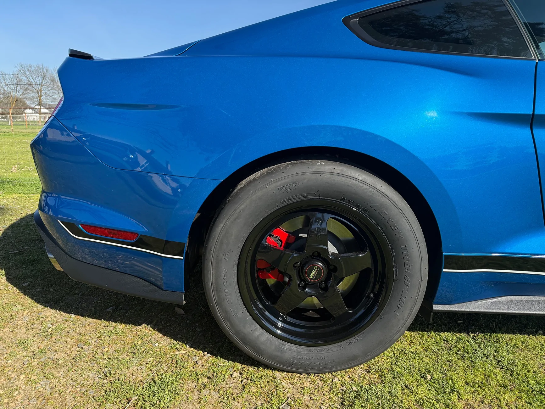

17x10 305/45/17 ET street R

I see most go with only a 10 or 10.5 wide rim with the 17s on a 305. Does all the extra sidewall allow for that. As with the 19s you need an 11in wide rim for the 305.
Yes. More flex in the sidewall. 10” or 10.5” on 17 with 305 drag style tire is ideal. While the 19 won’t have as much “give” and 305 wide ideal for 11” for most tire manufacturers. My setup for street is 305/35 Continental sport 02 rear on an 11 and front 295/35 on a 10.5. Setup for strip 18X5 front 28x6 sportsman sr and 17x10 MT Street R 305/45 rear.
