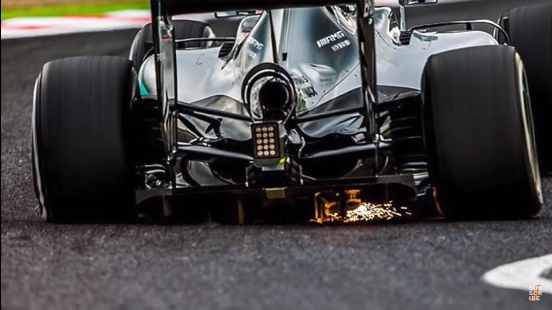

Oh yah ? Notice all that roll on the left tire, & how the cross section of the tire are wider that the rim. These sidewalls are intentional made very thin, and to flex. As again if you look at the left tire, it's entire contact patch is on the road. You'd never get that with ultra stiff sidewalls, nor will you get better cornering speeds with ultra stiff sidewalls.
The sidewall is much thinner, and made purely of rubber. It's built to flex under high load. The contact patch is the part that actually touches the road, so it needs to be tough enough to handle impacts (but not so tough that it can't flex at all). It has thin steel bands throughout.
Lets make tall sidewalls great again.
