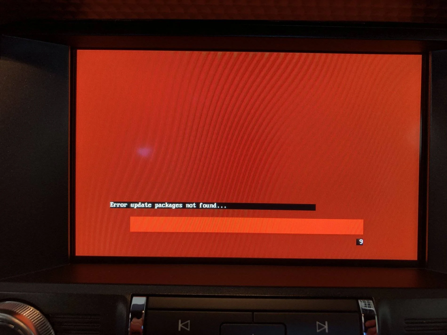

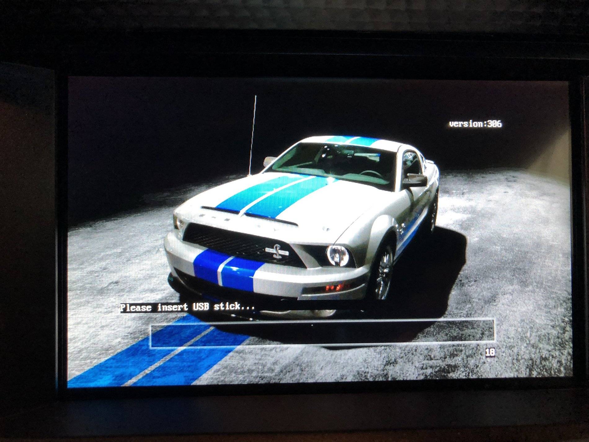

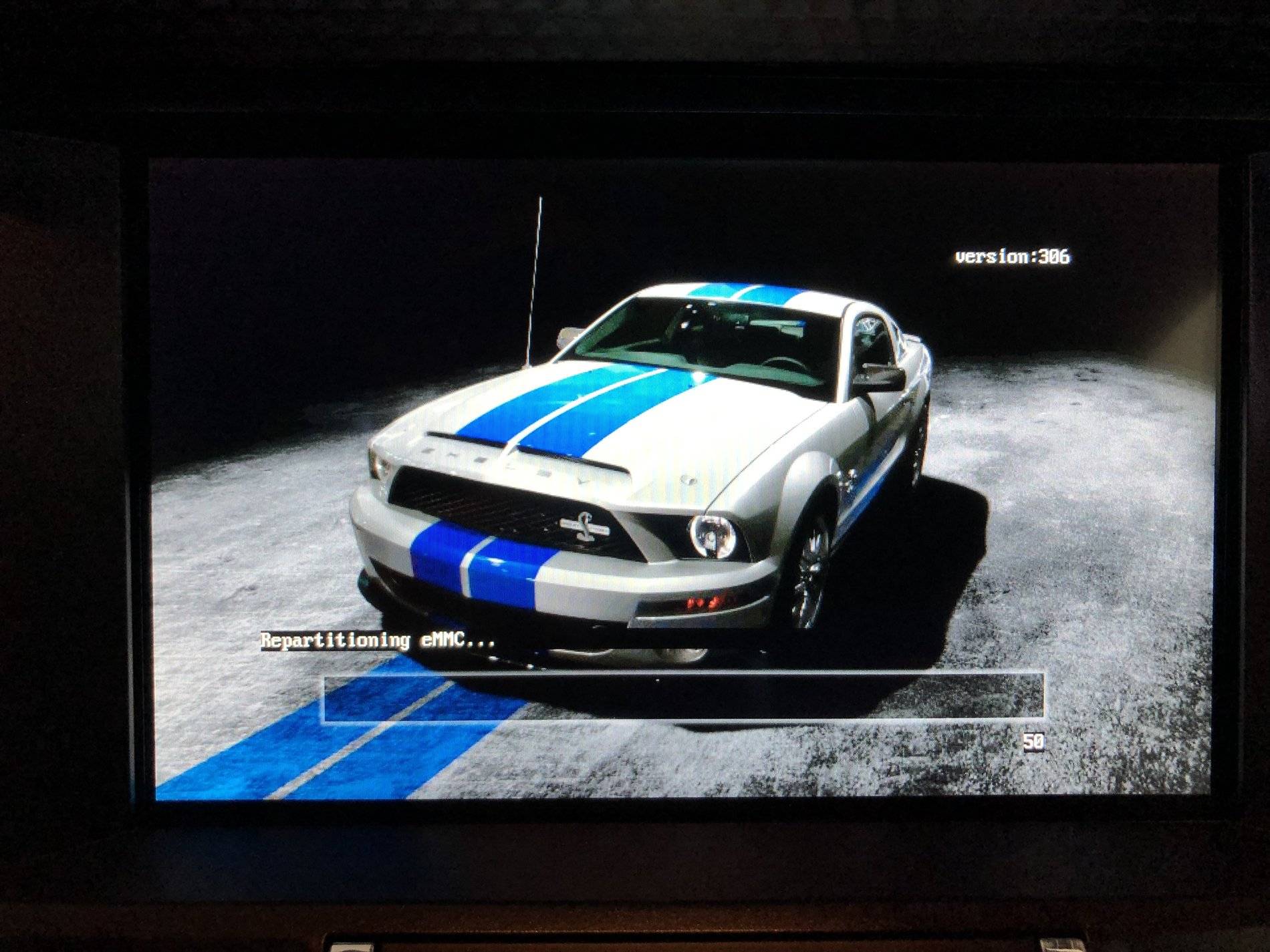

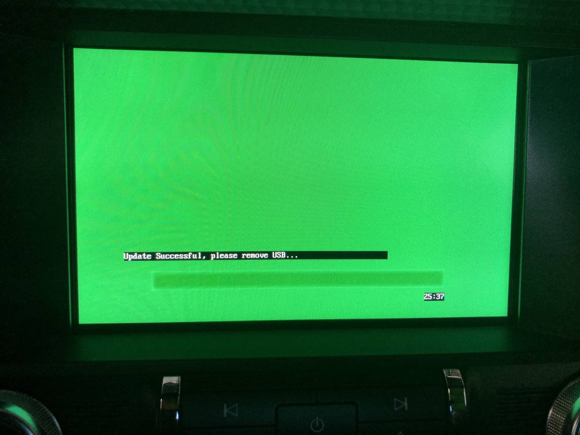

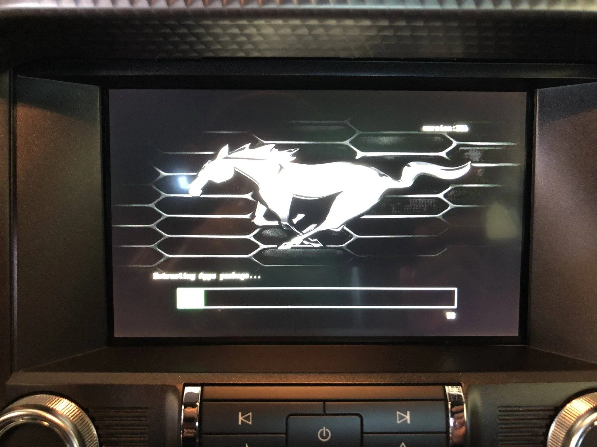

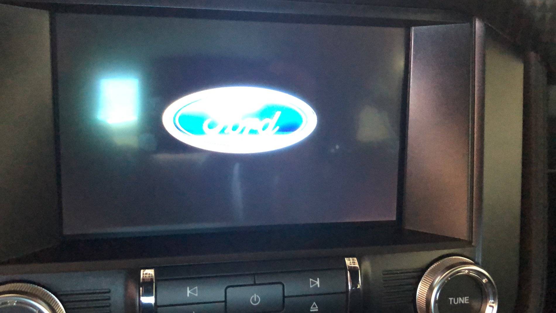

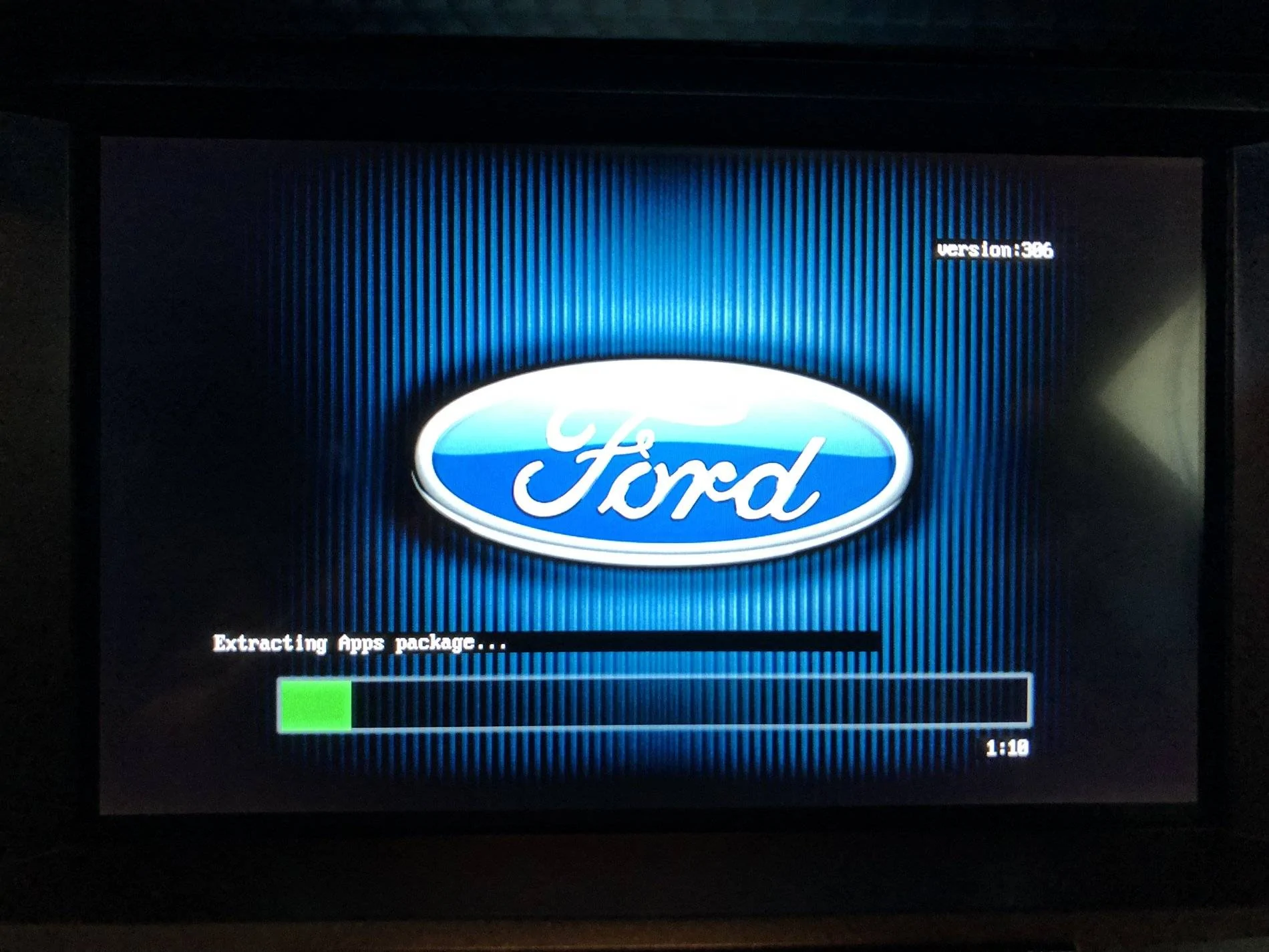

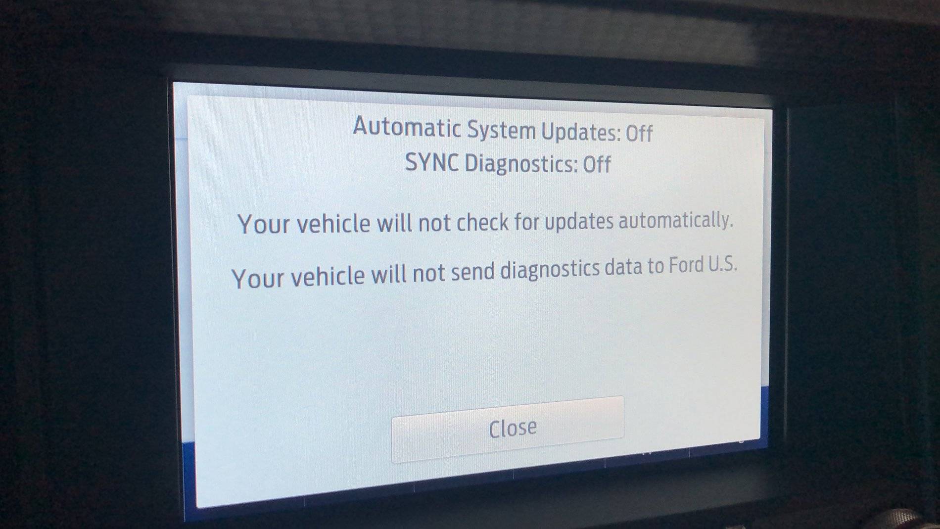

Awesome. I’ll document the rest Incase anyone else needs a boost of confidence when they do theirs.I had a green screen rather than red, but your pics that follow match mine.

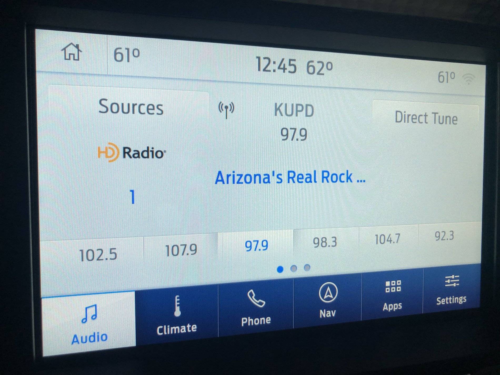

Glad to hear this worked for you. Even if for some reason you cannot update any further you are still ahead of the curve.Thanks to OP for linking this. Just upgraded my '17 GT and the wife's '16 Flex, worked like a charm!
Yes, and in the case of my wife's Flex, the maps are a huge upgrade. Her 2016 shipped with 2014 maps, and there have been a LOT of road changes in our area in the past 10 years that were not represented in '14 maps. She loves the style of the new interface too, so a definite win-winGlad to hear this worked for you. Even if for some reason you cannot update any further you are still ahead of the curve.
