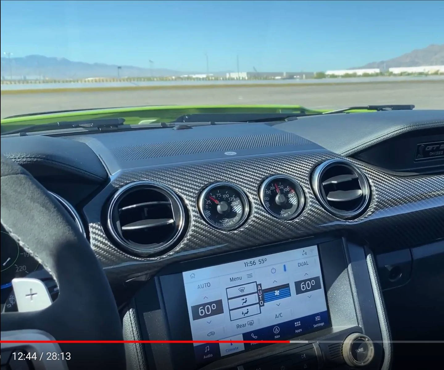

    Those are my screenshots at night. The daytime screens use a different palette and brightness. That probably explains the difference.

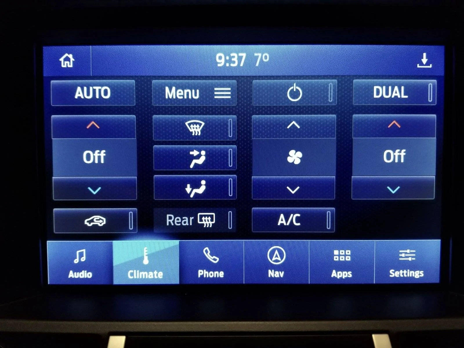

    #29 ghostang, Jan 25, 2020
    Thanks, StangTime! The pictures below show the differences I'm referring to:
