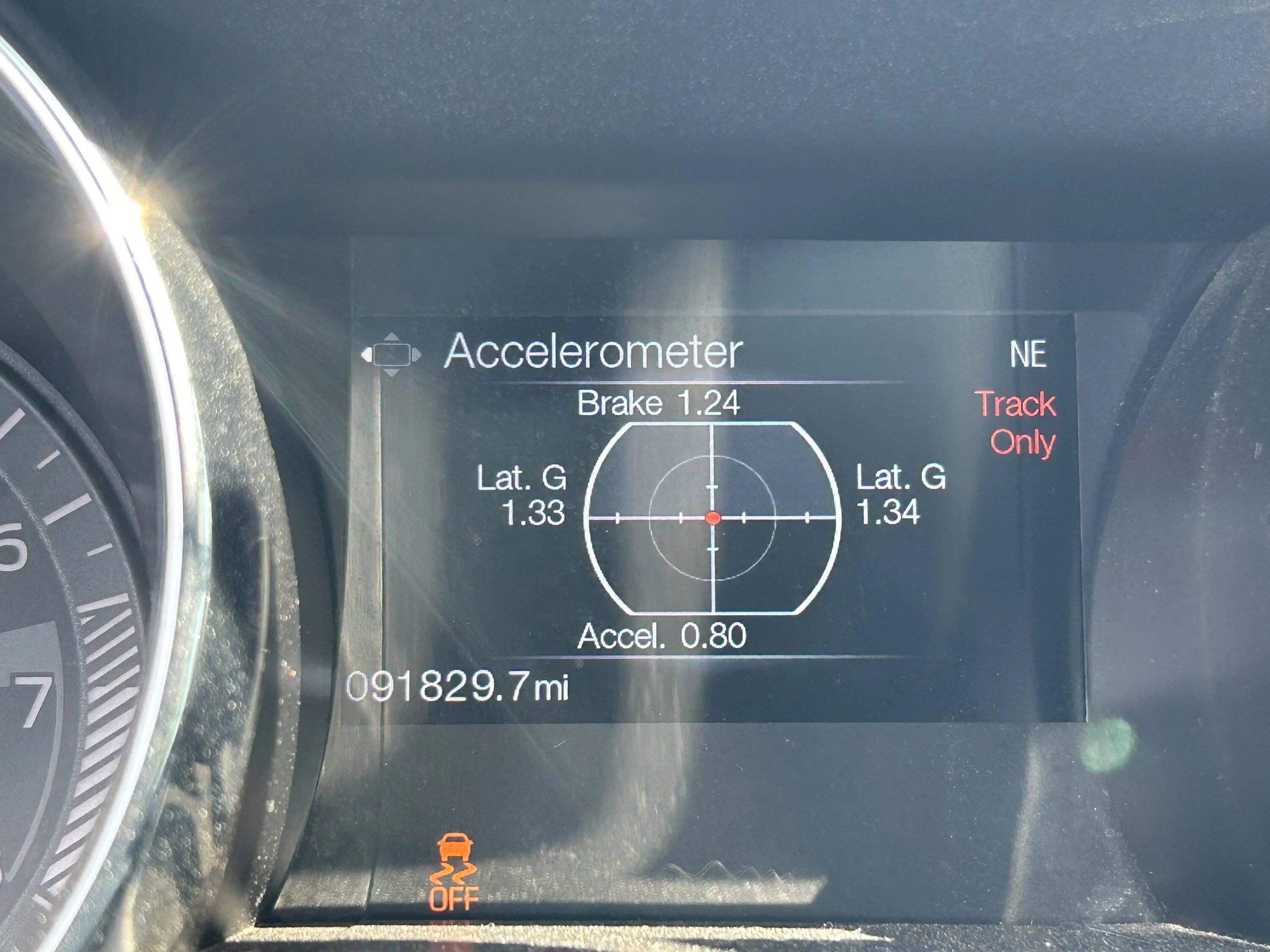

Doing braces first and leaving tires and shocks for last is completely backwards if you actually want handling gains. My car records Gs over 1.3g regularly (close course, not on the street), and I worked up to these limits by upgrading Tires, alignment, shocks, sways and then eventually wider wheels, springs, even better shocks. I have literally no additional braces and only a couple bushings replaced.
