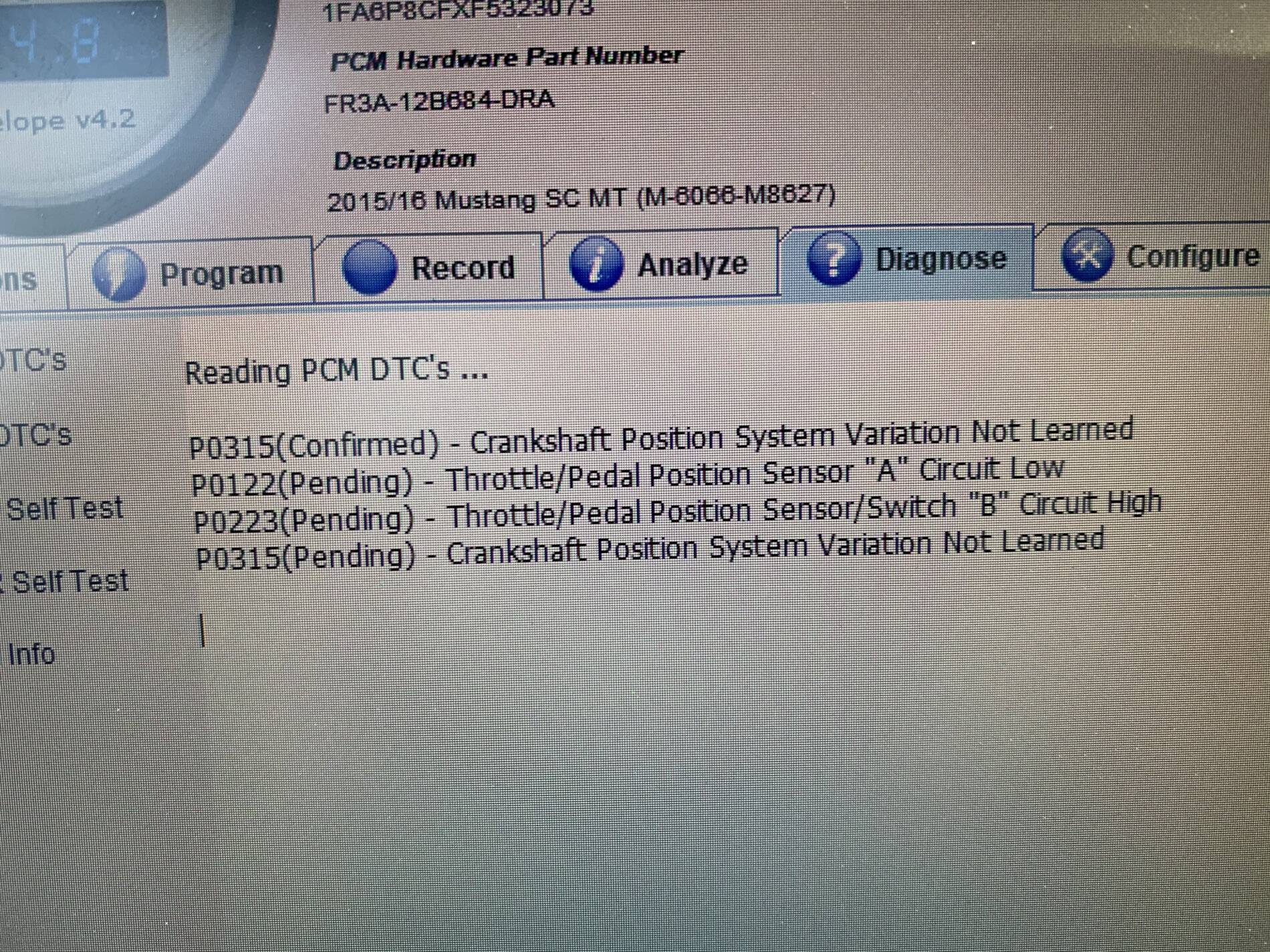

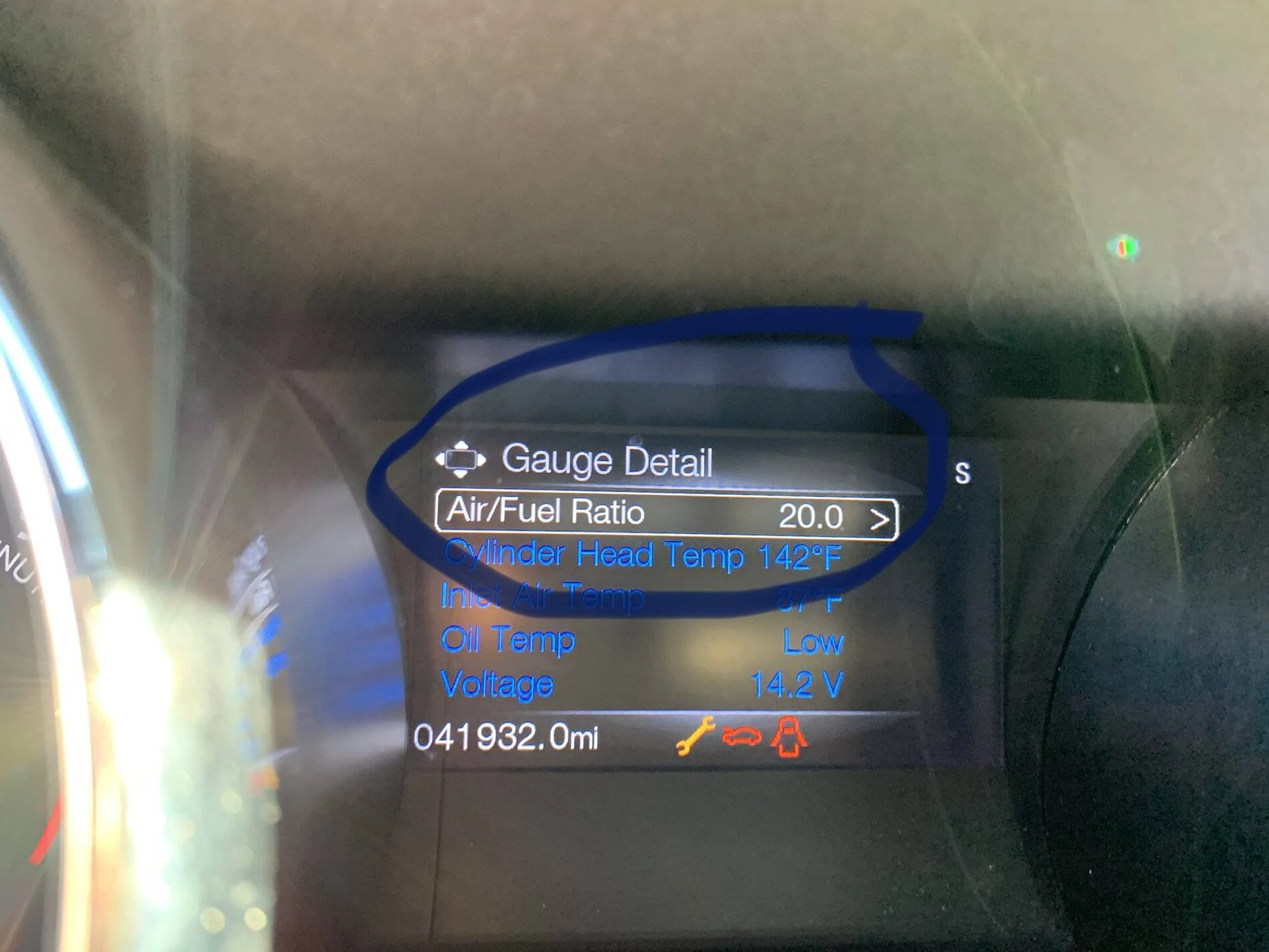

A friend and I installed the FP/Roush 670hp kit. Yesterday, I uploaded the new calibration supplied in the kit with the pro cal 3. The tune was uploaded successfully however when I started the car (2015 Mustang Gt) the a/f ratio was at 20 and the vehicle was sputtering. It settled into a rough idle but the AF ratio remind the same. The pro cal diagnostic indicated a P0122 and P0223 along with a crank re learn error. I double checked all the connections and they seemed fine. I’m reaching out to you all for some guidance on getting through this issue. Thank you

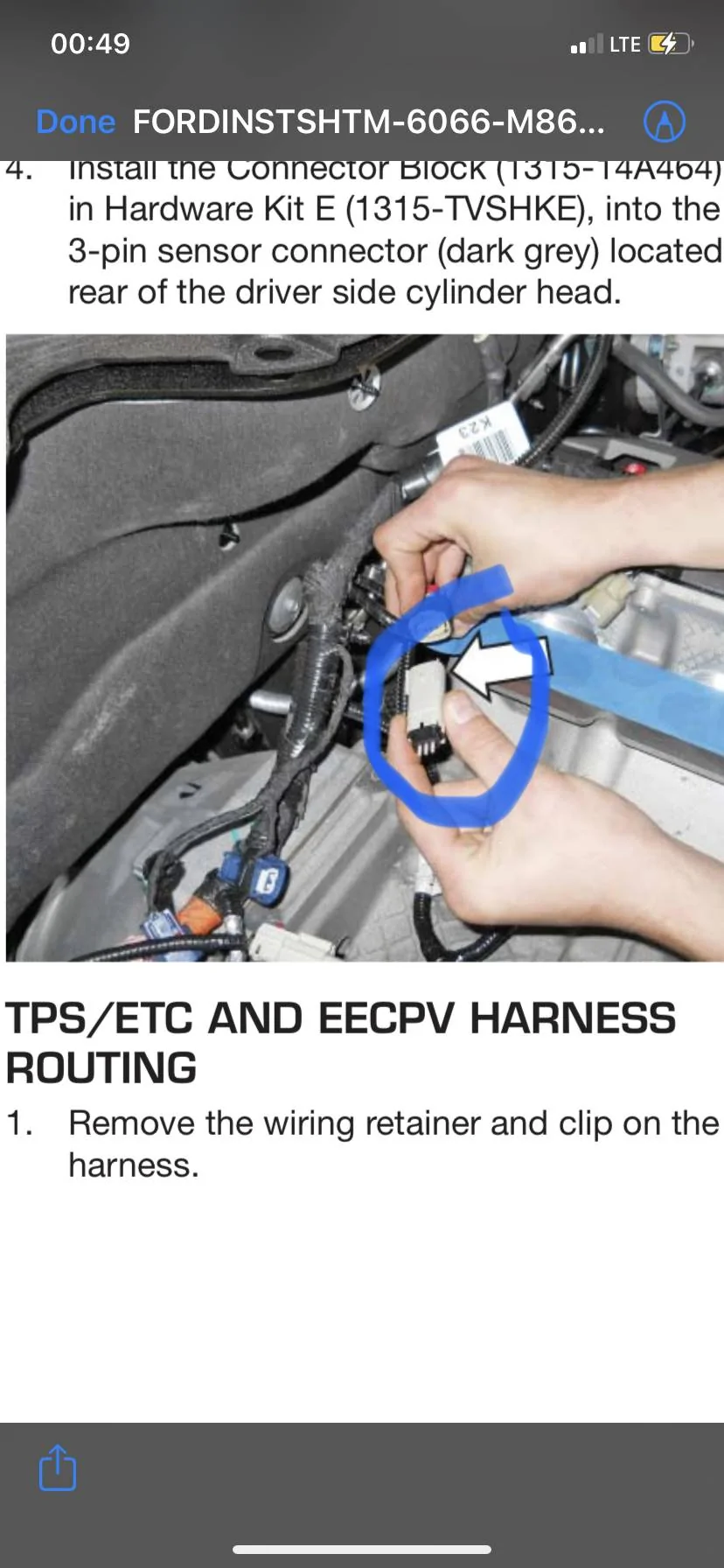

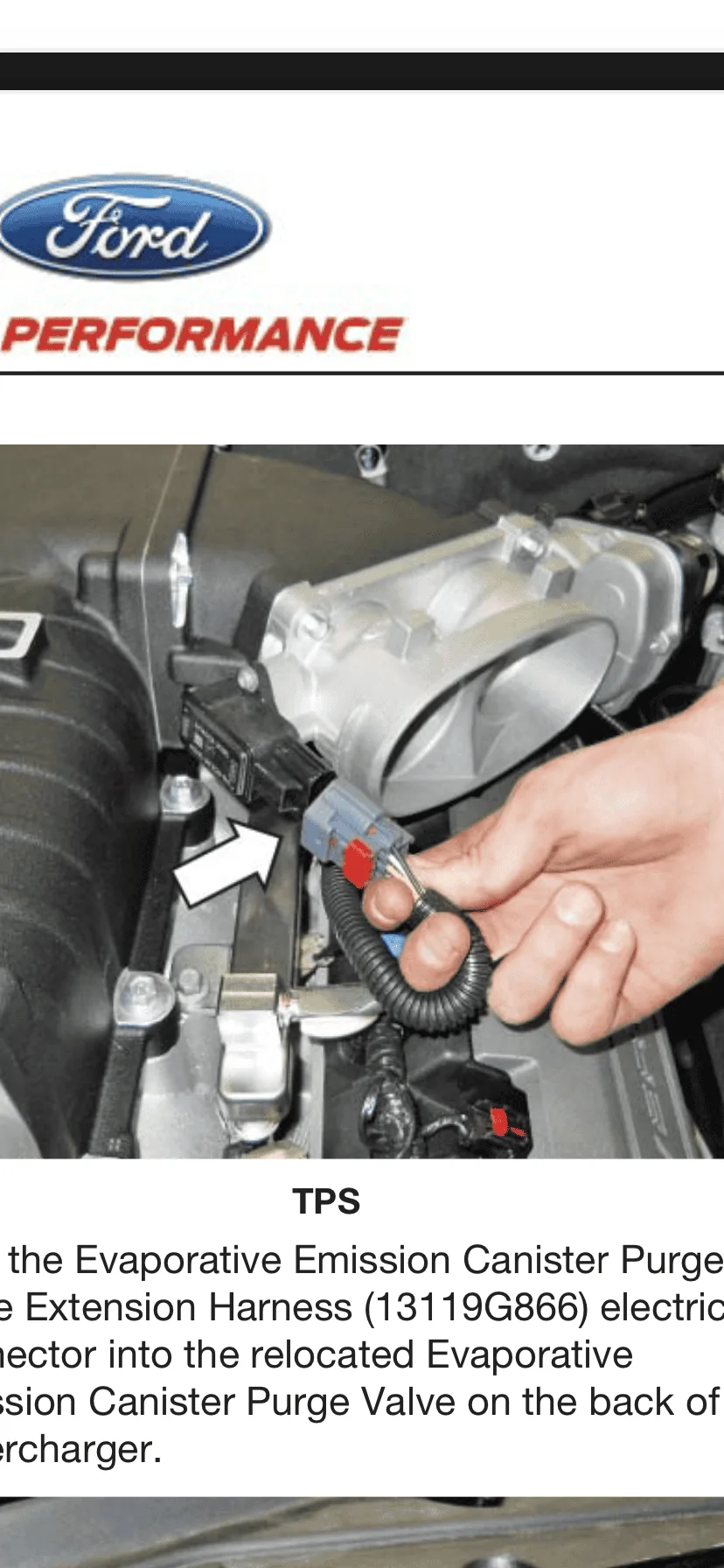

So looking a snack through the instructions I found some discrepancies. I bought this kit as the ford performance version. There was a part missing and a what seemed like a random part was included.
Apr 16, 2021
PacNW
Dom
2015 Mustang GT

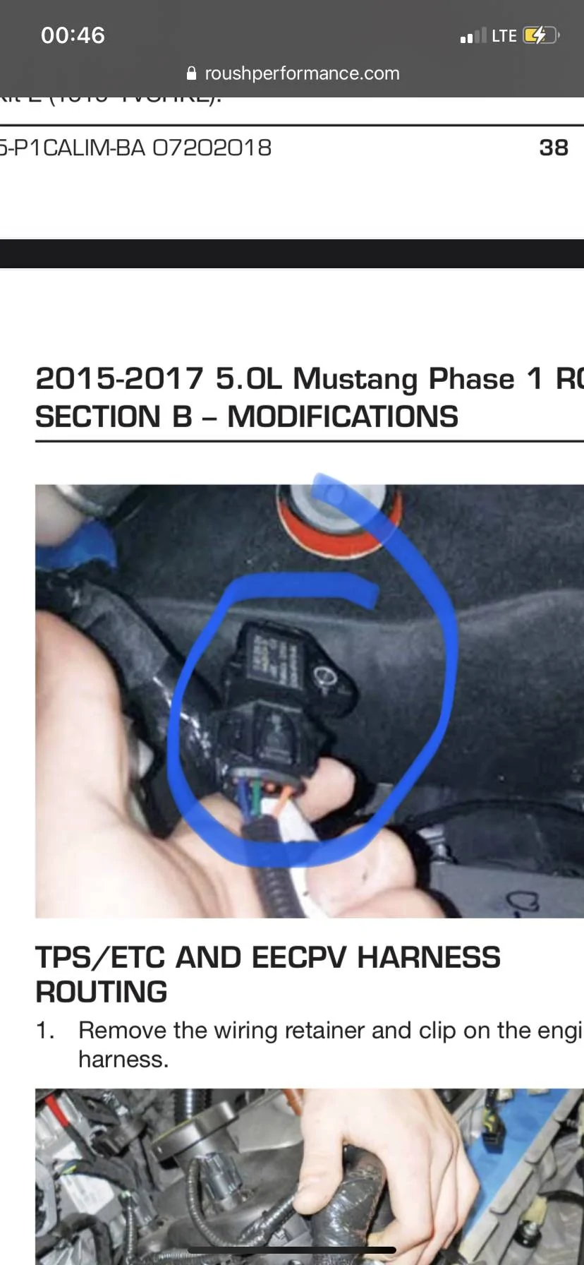

I researched the part number and it took me to the Roush version of the instructions. But the ford performance instructions I had required me to install this pictured below which I didn’t have. So i installed the sensor the kit I got came with.

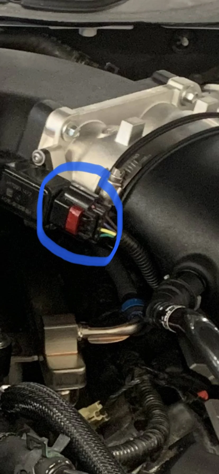

And the last thing I noticed was the tps shown in the instructions is gray with a different combination of wire colors than the one I have

Its a tmap sensor they use on f150s. It measures boost pressure and temperature. Not sure why roush has you connect to passenger imrc and zip tie away. Weird. Maybe just for under hood temps. Did you make sure to reconnect your harness ground?? Also, double check the repining of your stock throttle body harness.

I think you’re on to something. I looked up the f150 instructions and the parts I pointed out as different from the ones the ford performance instructions are depicting seem to go to the f-150. So now it seems like one of the hardware kits I received was wrong.
