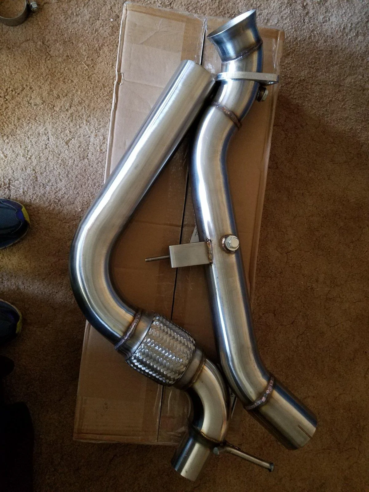

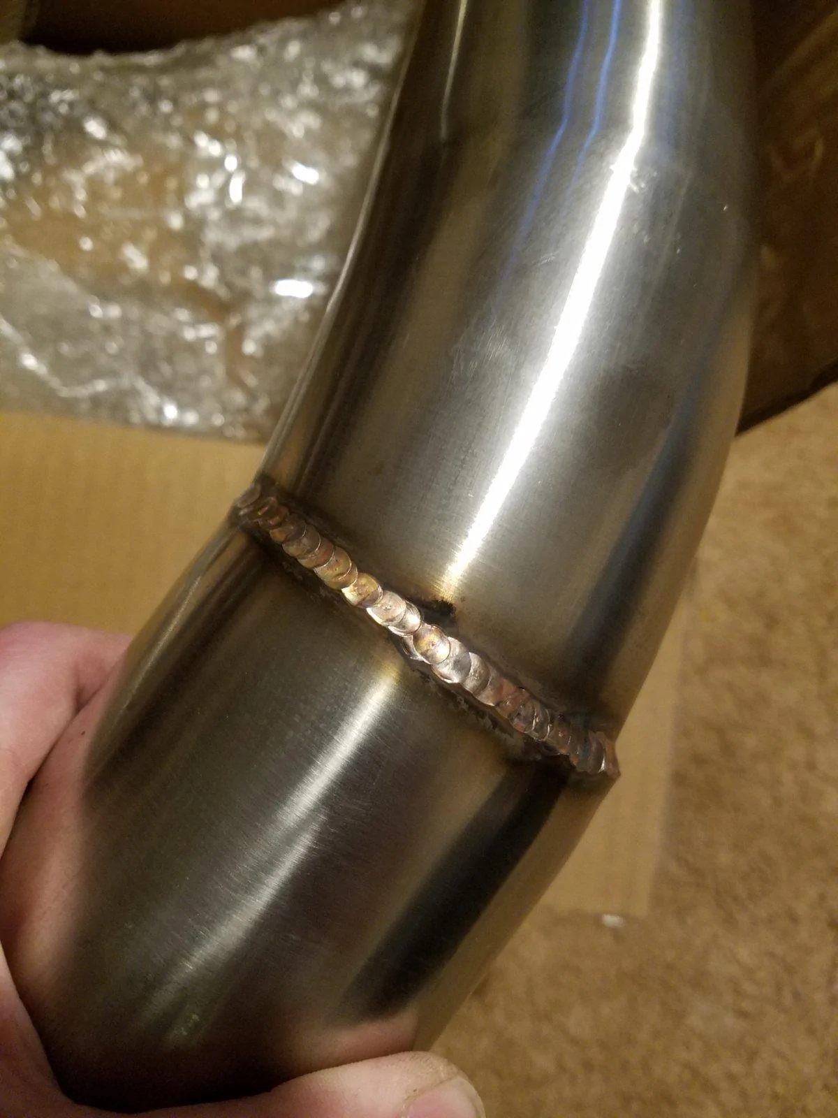

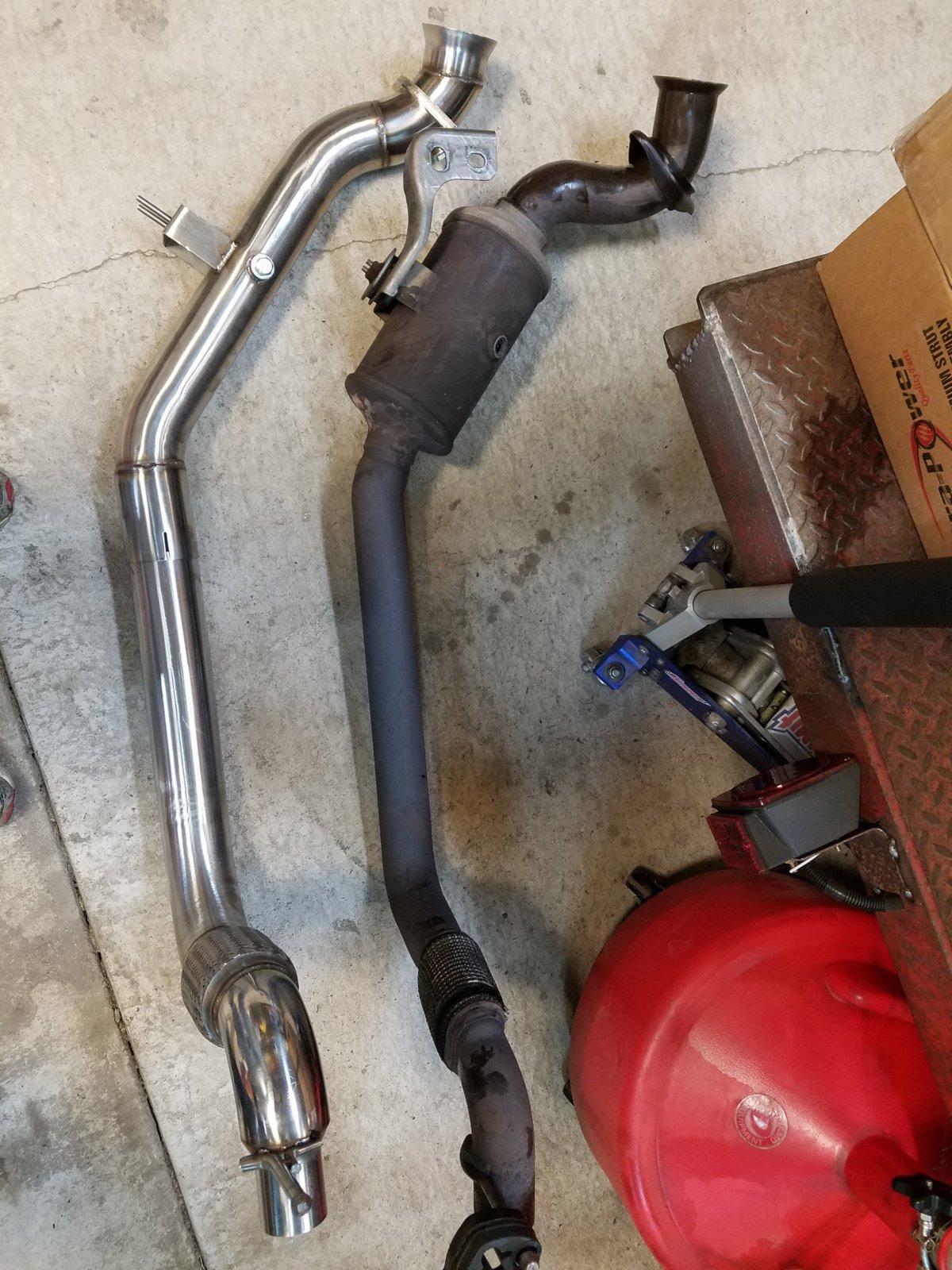

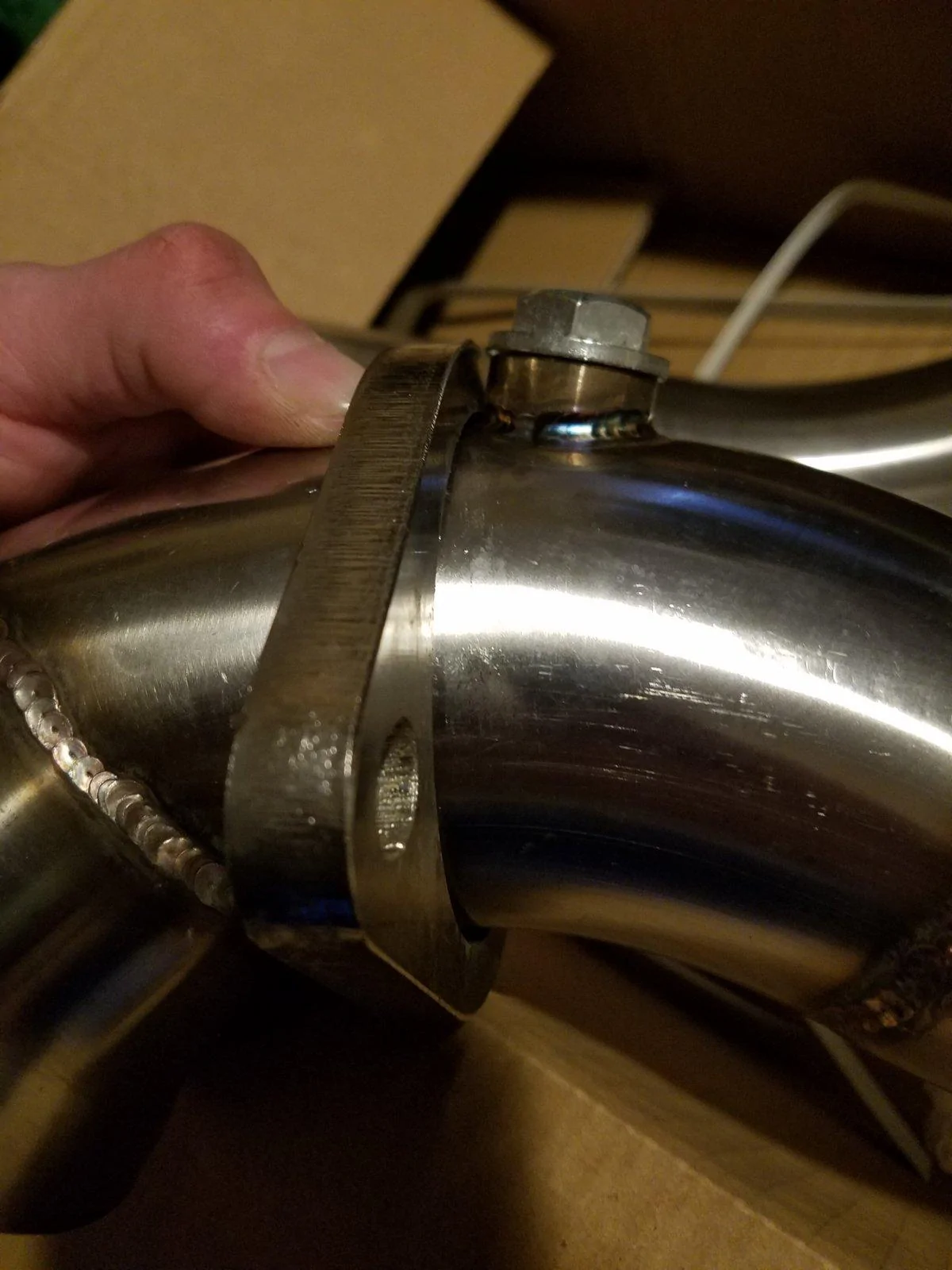

First impression is that the exhaust looks good. The majority of the welds are solid. There are a few pinholes in certain areas but overall good welds.

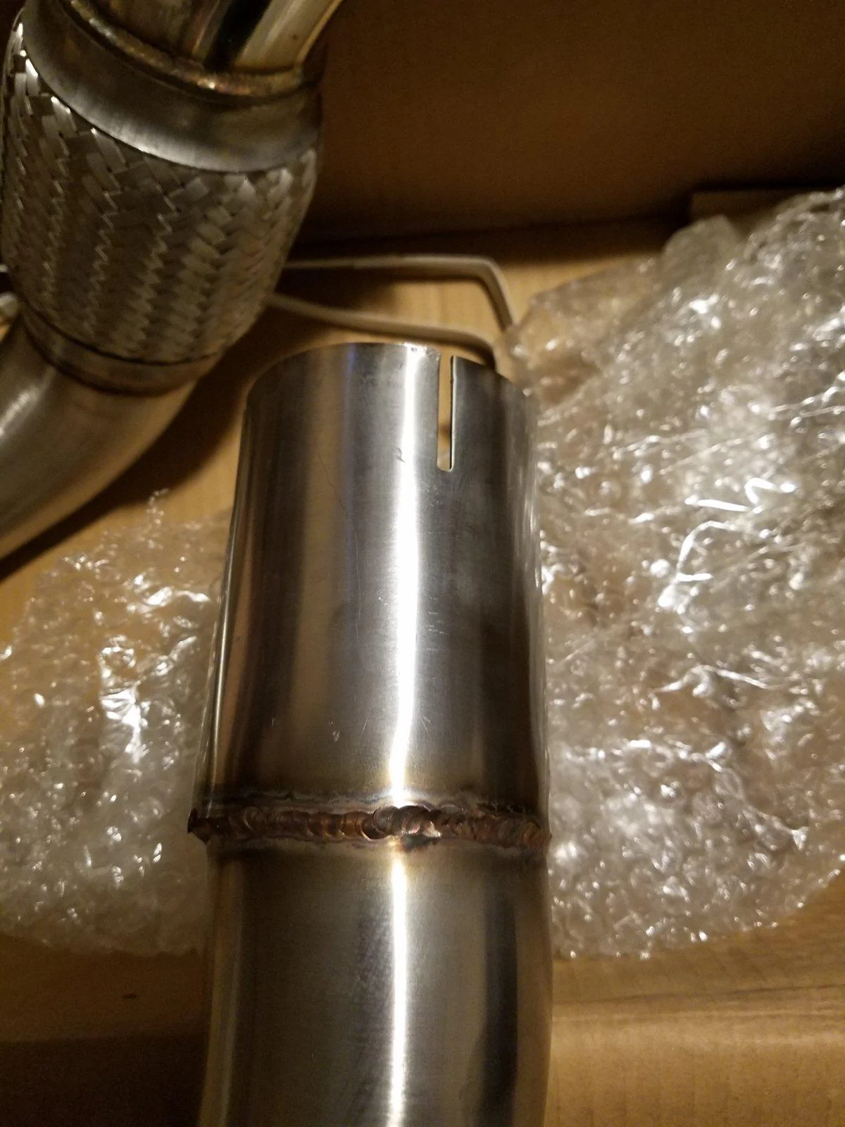

The slip fit connector that is welded onto the downpipe itself could be a little straighter. Ill see if that bites me in the butt later. The flange on the top that bolts to the turbo is very thick. It has a few rough edges on it buy this should not have any bearing on its installation.
The lower piece has good quality welds and exhaust hanger tacked to it. It does seem to be a very solid piece. Like i said, all of these things mean nothing if the installation is a nightmare.

Well it went on with only one small hitch. The bracket that I removed from the catalytic converter that slides over the two studs didn't want to fit on the new exhaust because the studs were not completely parallel. They were just slightly wider at top than the bottom.Very easy fix. I simply started the nuts on the two studs(to protect the threads) and gave it a few squeezes with channel locks and the bracket slipped right over it. I just went out and put 10 miles on it. No leaks. Will check for any loose hardware tomorrow after it goes thru a few heat cycles. It might be in my head but on start up it sounds a very small amount throatier. Ill get some more installed pics later. Fitment seems as good as you are probably going to get.

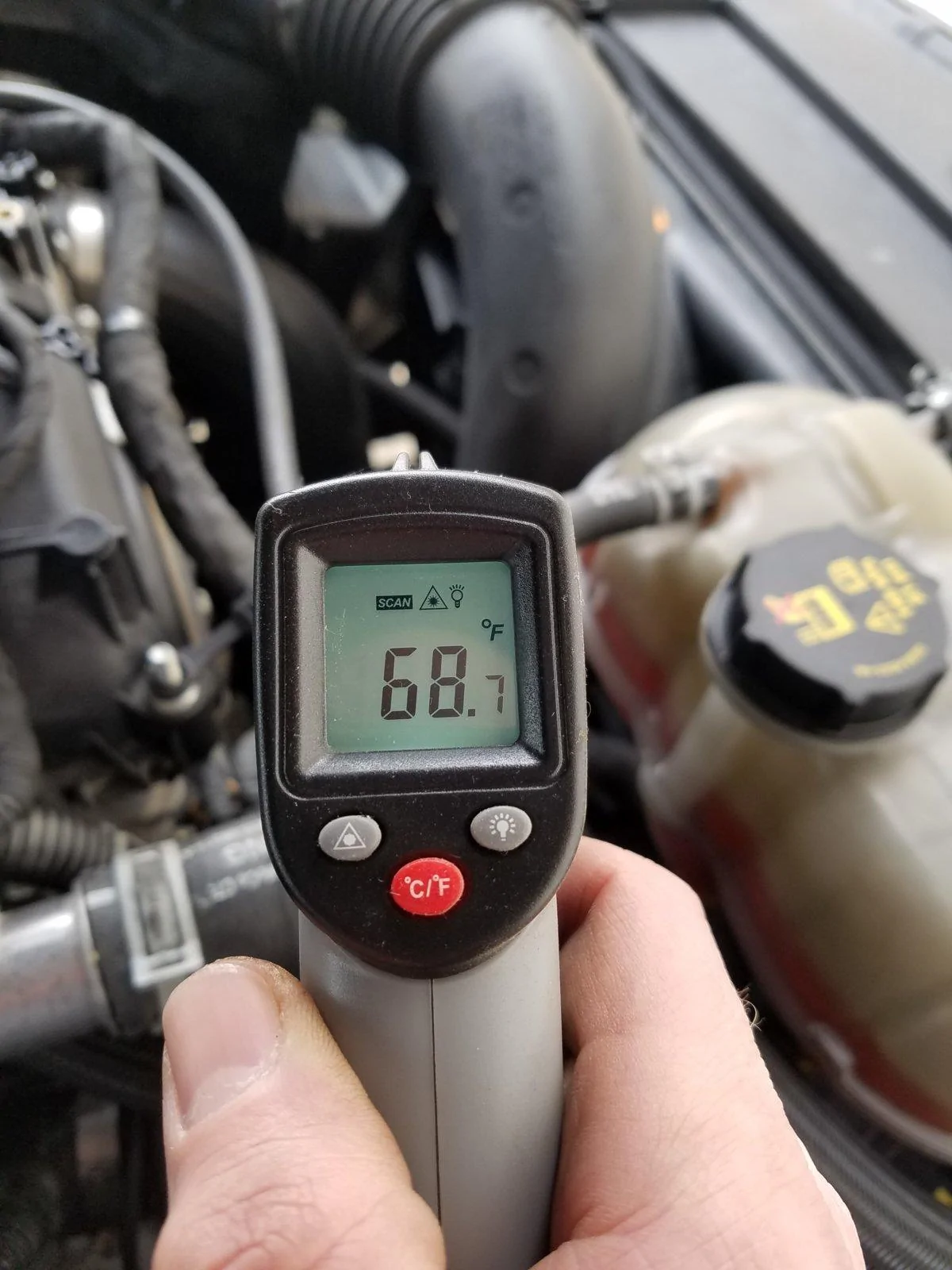

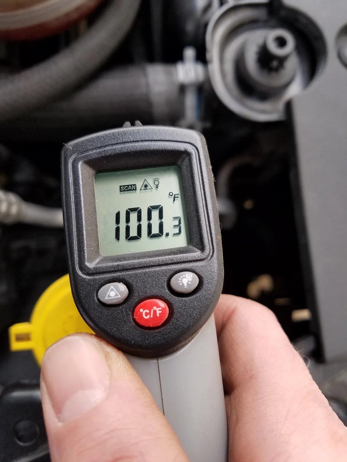

Also snapped a couple pics of air temps going in and coming out of the ETS intercooler. Ill report back more as time goes on but for now I am a satisfied owner of the $139 Ebay Downpipe.

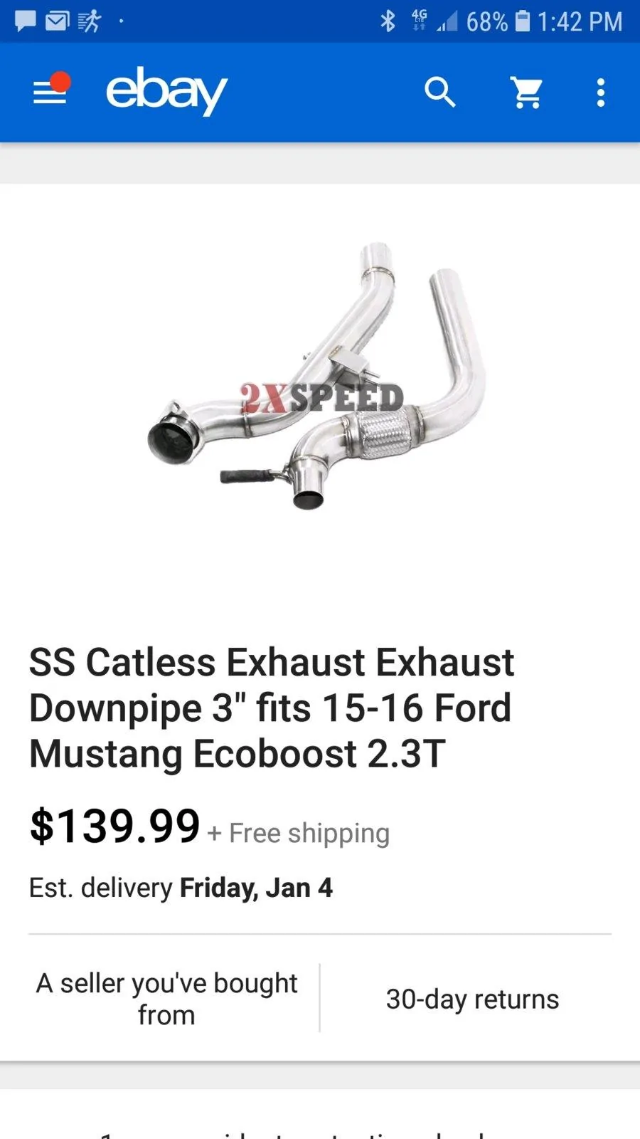

This was a 2X speed pipe Mr. Helpy Helpinton. Dont know anything about a 1320 pipe.
Oh and before another braintrust replies im also a LIAR. IT WAS $139.99, NOT $139 like the title says.
