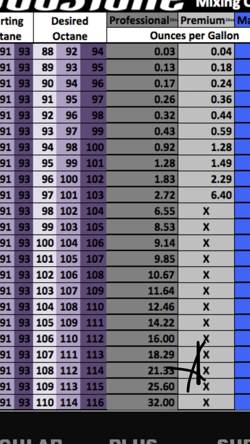

Lol.
That was because the car was missing as I assume it was fouling the plugs with too much
fuel.
First time out since I swapped the 02 sensors(and plugs ) it went 10.2@136 in 4000 ft DA so it’s running better .
If you do race gas stick to the unleaded stuff .
Sunoco’s GT plus is 104 and equivalent to MS109.
Around here it’s $8/gallon . About $40 per 5 gallons compared to $80 for MS109 .
octanium says adding a can to 10 gallons of 93 will increase octane to 101(8 points )
Boostane may be cheaper (and less likely to color plugs ) since it’s more concentrated .
You can get 101 adding-less than 1/2 a can to 10 gallons of 93 and 104 by adding a can to 5 gallons
https://boostane.com/about-boostane/boostane-mixing-chart/
