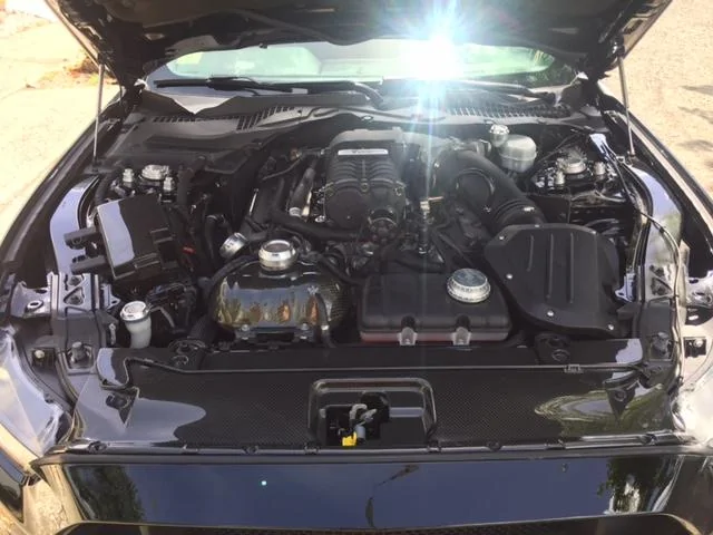

Question guys, I have been running boost now for a while (previously owned some Evos and now a GT TVS SC) and never used race fuel.
I'm currently putting about 650ish rwhp at 93oct, and was wondering what could be my expected gains with race fuel tune? Also, would I need to increase fuel pressure (injectors, fuel rail,race pump etc.) to get to incremental power levels independently of the fuel used?
I have a 17 GT roush S/C with phase 2 upgrade (BAP, colder sparks, 80mm pullley). Also, I've already upgraded OPG and CS.
Thanks in advance....
