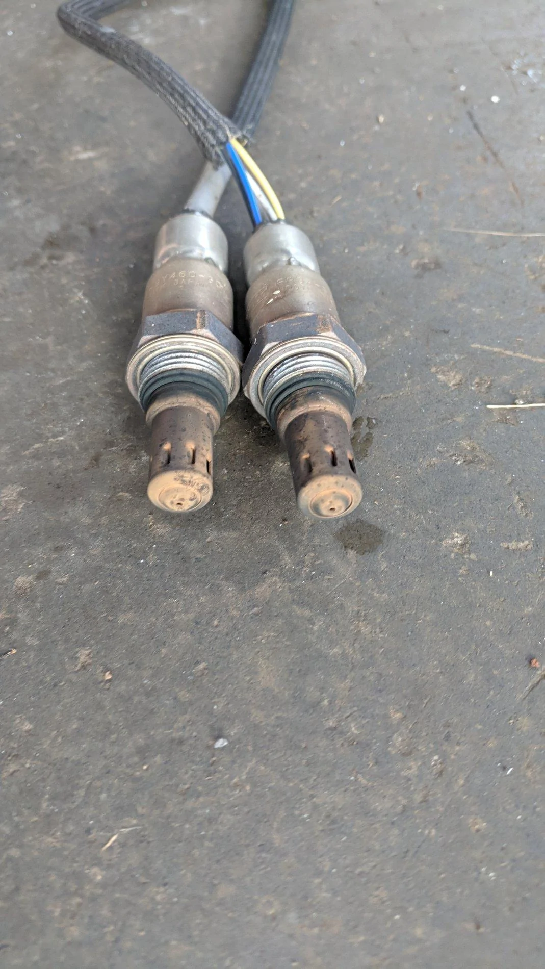

My car was missing badly and eventually had a random misfire code (did not show up till PBD sent me a “diagnostic tune “)
Pretty sure it was the leaded gas that killed the 02 sensors since I did not have trouble till I started running it .
I never had trouble with the Boostane.

I was running unleaded race gas (Sunoco GT plus ) before I deleted my cats
I got greedy and started running maximal (116) after I deleted the cats (waiting to install the fuel system to run E85 ). Car was tuned for 116 but then started running like crap . No check engine lights so my mechanic insisted that it was not the the 02 sensors .
It was breaking up real bad and felt like a miss although no MIL .
Went from trapping 140 to 110 mph !!!
I thought may be my clutches were toast so I did the expensive swap ...and car ran the same .
Rob finally sent me a tune that identified an “OL fault”
The rears were already off in the tune but I just swapped all 4 and all is right again(back to unleaded race gas ... still waiting to get in on the fuel system install to run E85 )

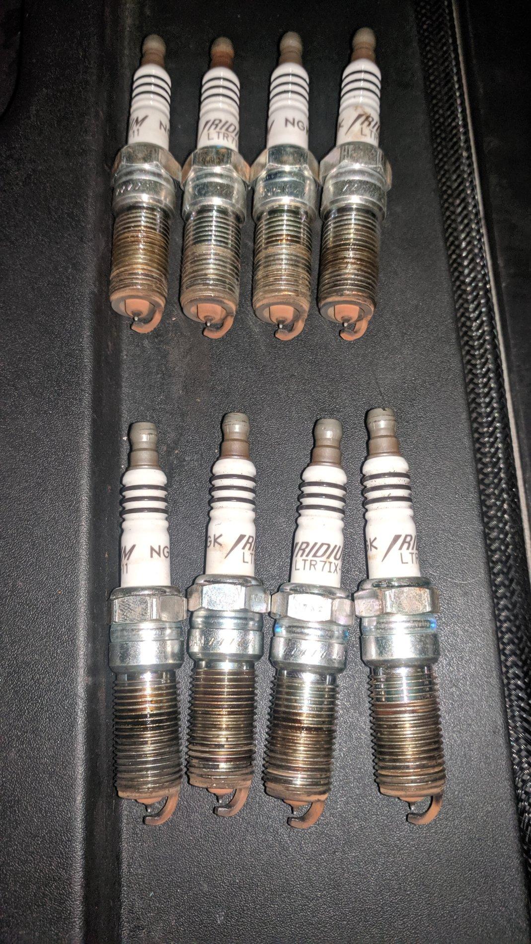

I highly recommend replacing plugs and o2 sensors often if you are using high concentrations of octane booster or leaded fuels, including boostane.
Changing them with every other oil change seems a bit excessive, but it helps avoid the problems before they occur.
Picture of my plugs after 8 16 oz cans of boostane, no other octane booster or fuel system cleaner. One can put in at 1/4-1/2 tank once/twice a month while at the track. The next can on fresh plugs my O2 sensors started acting up, should have replaced them with my plugs. Orange dust of death just like the rest of the octane boosters that work.

Picture of the oxygen sensors after that single case of boostane.
