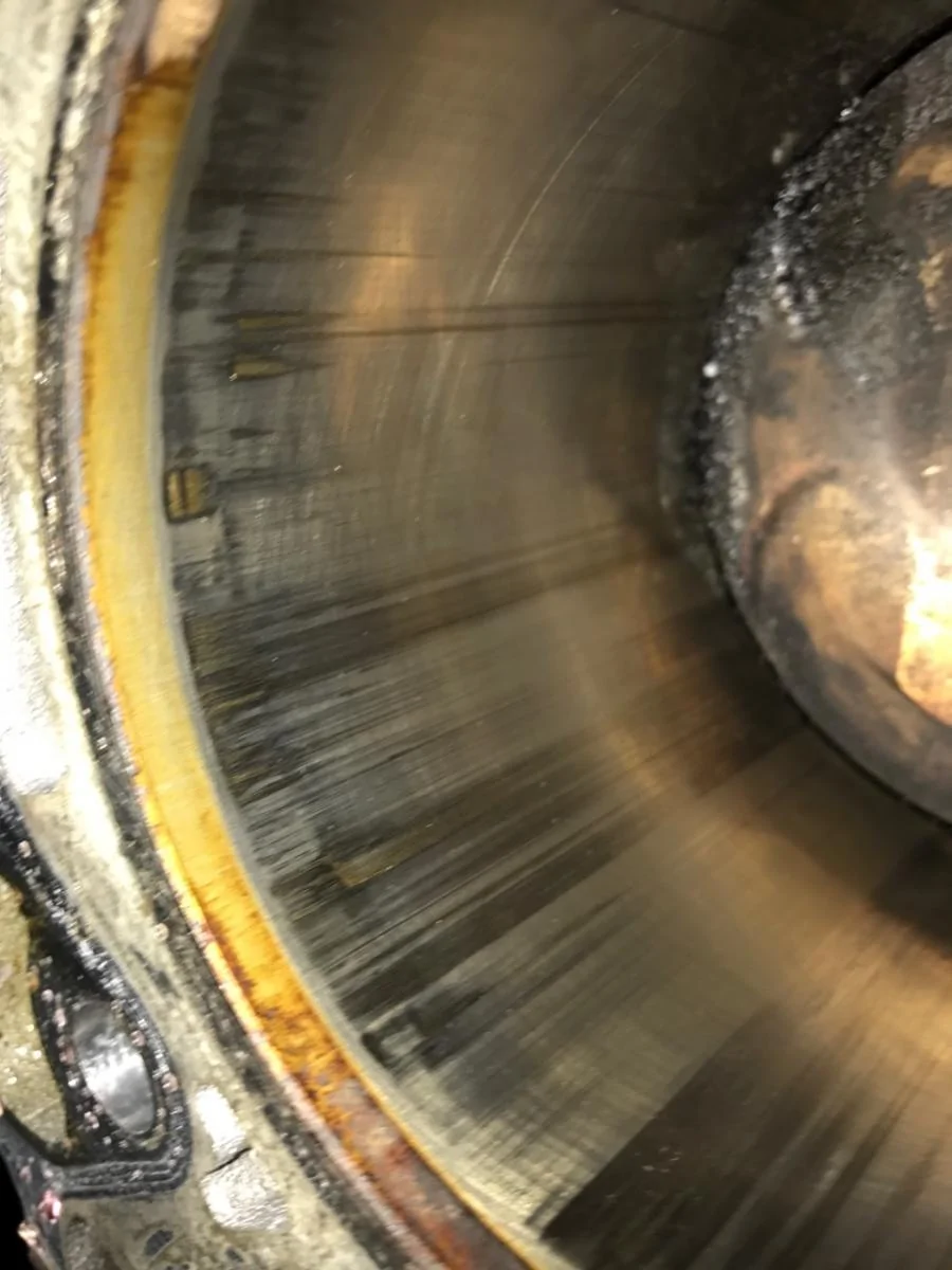

Just asking if any of the greater population has had an engine failure sure to an piston sings. The car was un modified and was being treated like a baby. Any feed back would be appreciated.

Sorry to see this. Not many engine failures happen especially stock.
Did you use correct octane gasoline?
Was your oil low?
Did you drive your car hard before it warms up?

Was it cyl. #8?
TWPrice
Feb 16, 2017
Wow that's terrible. Haven't seen damage that bad on a stock motor. As the other posters have asked, was it cylinder 8? I've heard that these engines have a tendency to run hot on the back two cylinders.

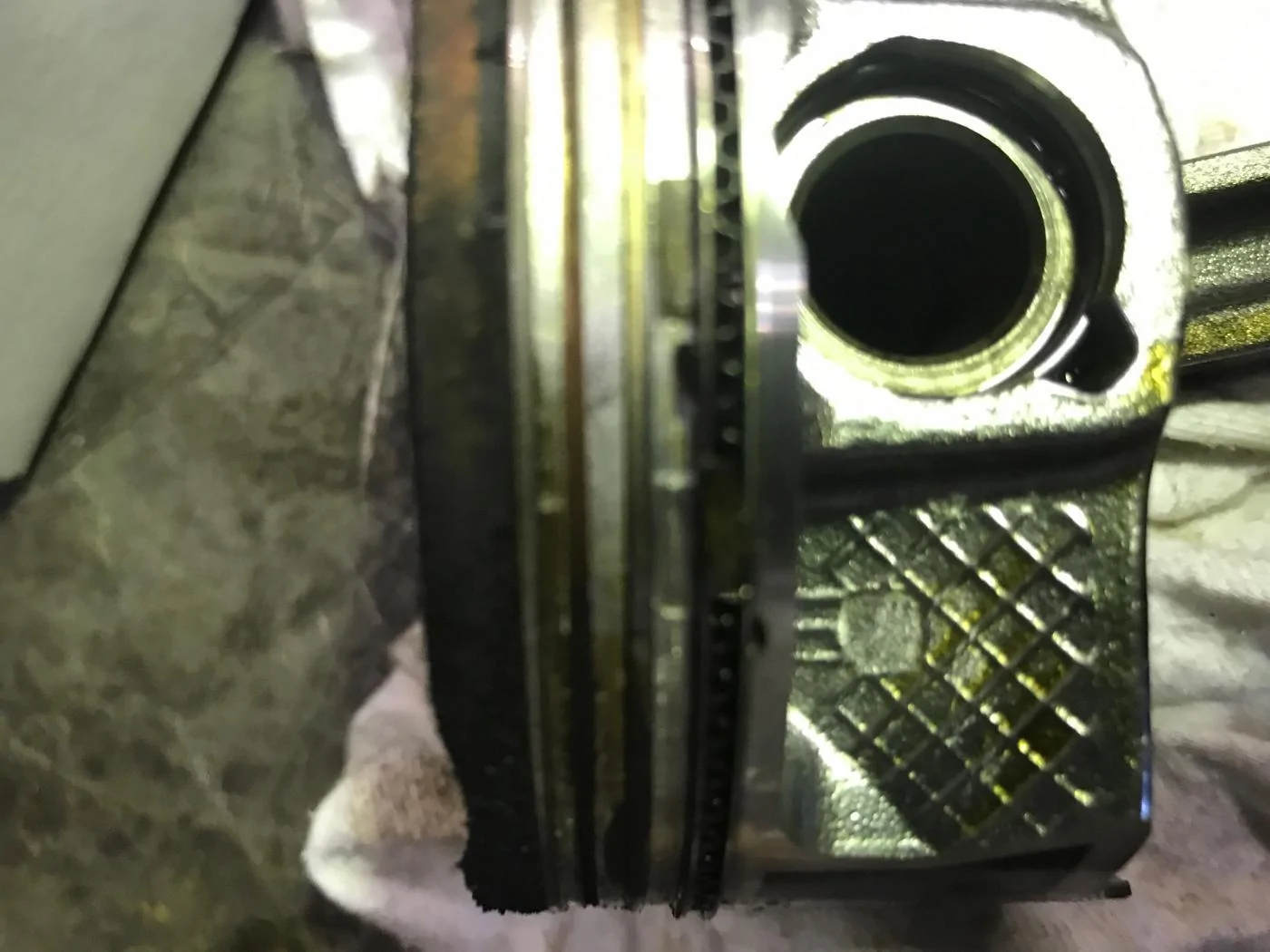

It was the eight cylinder and it was number seven that the ring had failed on. I did not note the engine head getting over 93-96 deg c and it has only had 98ron and never driven hard at all.

Did you recently change the engine oil

No I didn't as it was still well before the programmed service period set by ford

I take it this will be covered under warranty by Ford.

Probably just a manufacturing defect. Sucks for sure, but it does happen. Honestly, with the number of Gen2 Coyotes out there between the Mustang and F150, the number of failures is extremely low.

The cylinder wall looks pretty badly scored. I hope Ford gives you a new short block under warranty, then just bolts the heads and everything else from your old engine on top.
