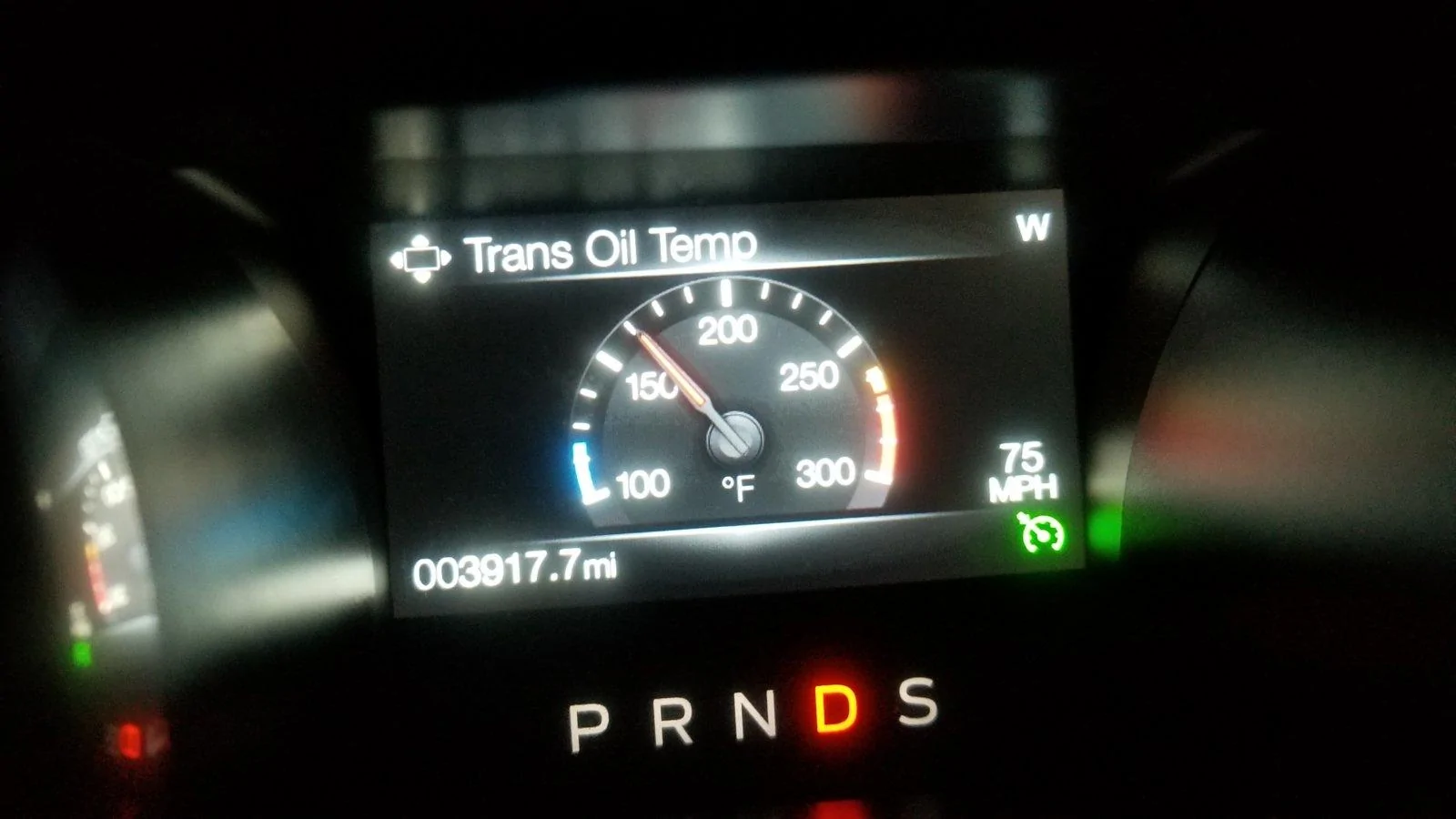

It has a gauge if you toggle right that shows above 130 something F it is in normal range. I agree it takes forever to warm up.
Dusten
Jul 25, 2018
822
585
Conway, Wa
Dusten
2018 Ford Mustang, 2001 Ford Lightning, 1968 Ford Mustang
This one?
