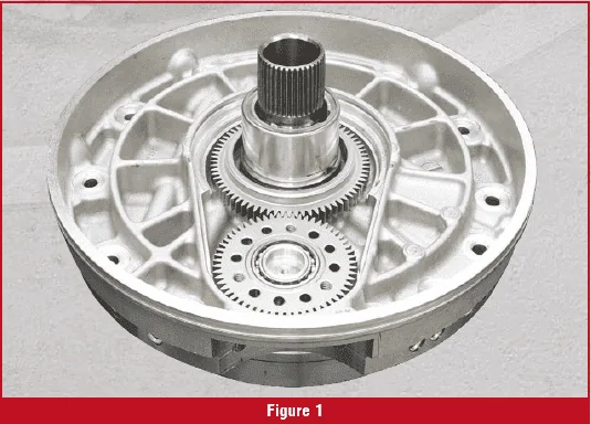

In a nutshell this can be normal 10r80 noises. The fluid pump is offset from the mainshaft and is driven through a set of straight cut gears.
