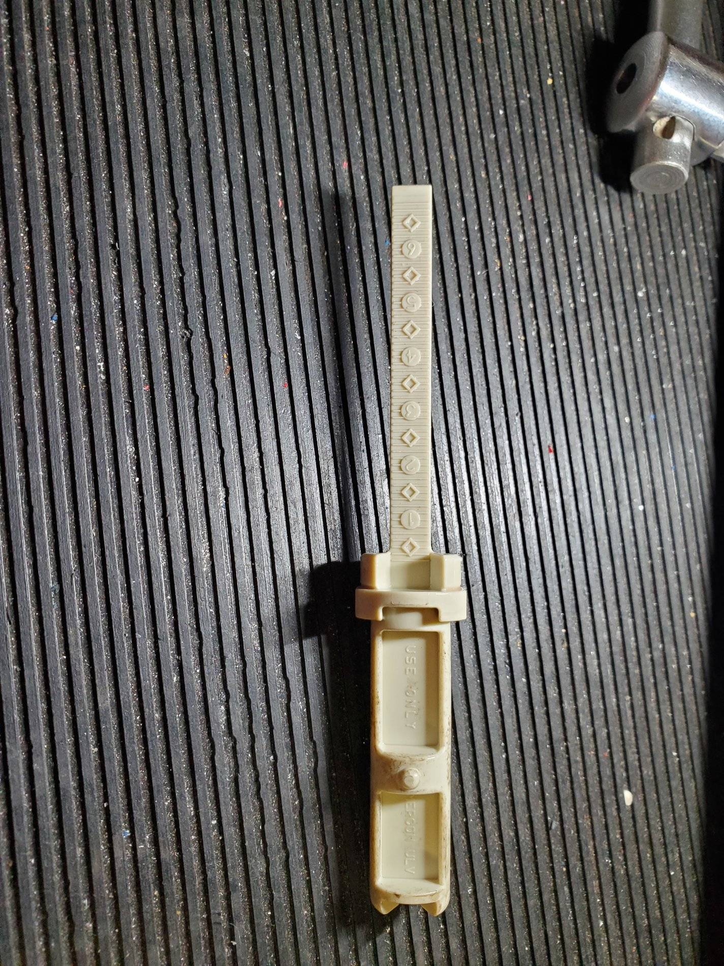

Hope OK to post here but the 2019 Transmission dip stick does not have the A and B areas located on the stick. The 2019 Dipstick has numbers. I can find no documentation that shows what the not level should be on the 2019 dipsticks.
see this thread, under "FACT 4"
https://www.mustang6g.com/forums/th...tions-to-harsh-or-no-shift-conditions.135463/
and also the attached PDF document in this post, page 3, equiv marking on the numbered dipstick should be between 4 & 5
https://www.mustang6g.com/forums/th...sible-to-remove-help-plz.141548/#post-2900858
hope that helps

Thanks! Very helpful
