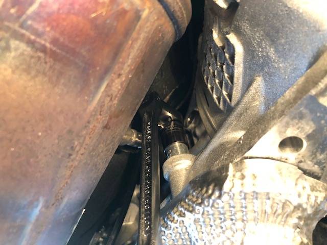

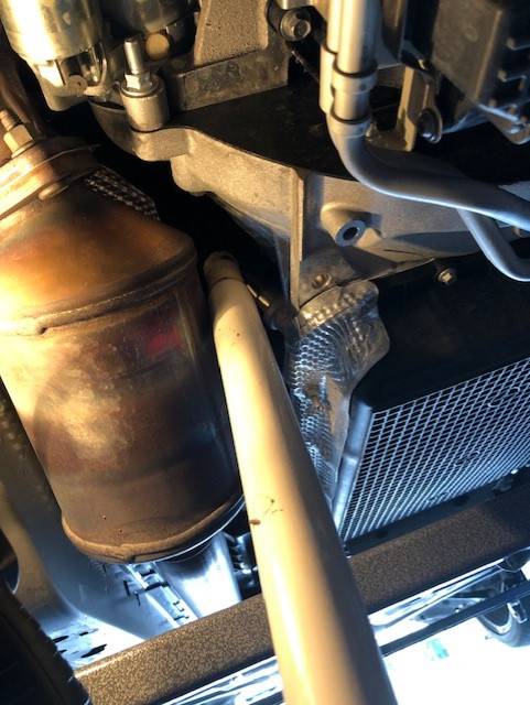

My A10 shifts harsh, and its whiney. With all the threads about the fluid being low from factory, I picked up a couple quarts of the Mercon ULV ATF and decided to try and check mine.
I see the fill plug, and using a flexhead ratchet, am able to get my 19mm socket on it. The problem is, it is on there so tight it won't budge, I feel like I am going to strip something.
After trying a while, and getting pissed off, I put my handle from the floor jack on it to really get some leverage, and it still would not budge lol.. before I tried harder decided to ask the mustang6 experts
Something is up, is it reverse threaded?
I uploaded a couple pics. The plug is in an awful spot, I only ran the car a couple minutes and the exhaust pipe was super hot. My thinking was to loosen it and then run it to full operating temp, then it would be easier to check... right

Honestly, I'm like you. I prefer to do as much as I can on my own. But in this instance, I would schedule an appointment with a dealer.
I haven't tried to take it off myself yet. I was under the car yesterday and see where it is. It looks like a bitch to deal with.

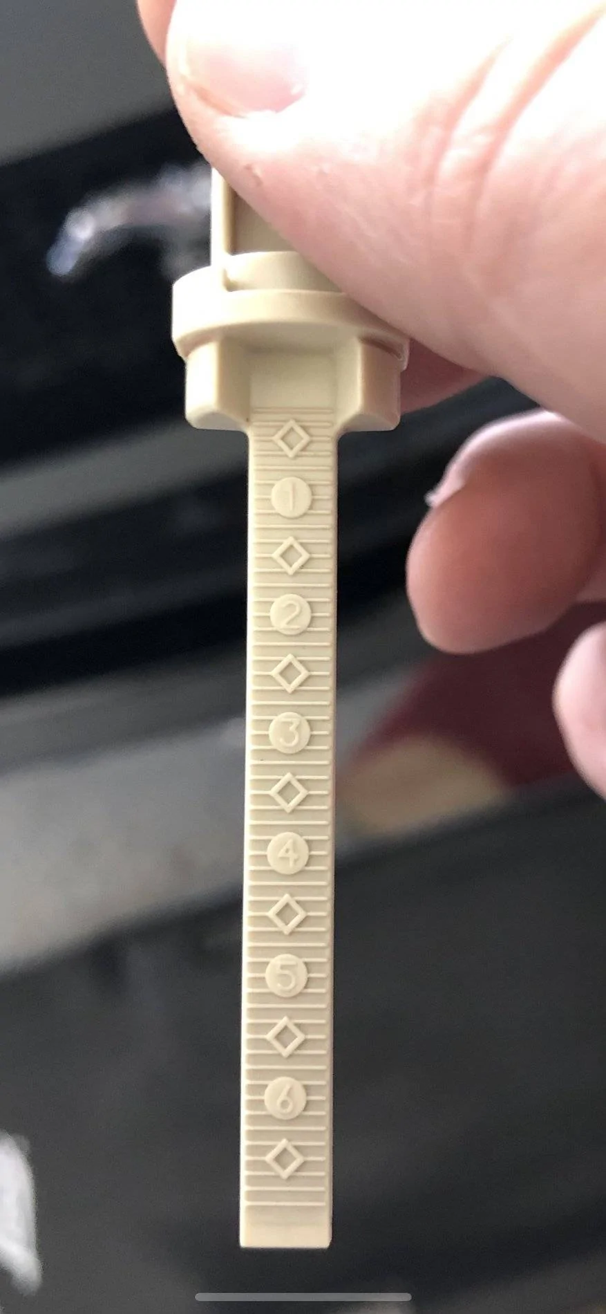

Well, finally was able to remove the cap. They must have changed the dip stick for the 19 MY because this is mine.
There is no more "A" and "B" - would the full line be around 3 or 4 ?

First, thank you for posting a picture of your 10R80 dipstick!! I’m am now wondering if there has been a production change to the actual dipstick being used, because it’s surely different from the prior 2018 Shop Manual images posted.
Second, I have linked your thread into the first page of the “10R80 Facts thread”, as this will definitely help other owners in the future who are trying to check their fluid levels.
Third, yes @leonrudi was the first to confirm that his 10R80 dipstick did not have the “A-B” readings, but the numeric readings as yours. He also confirms that after adding fluid to the 3-4 mark his transmission shifted better.

and just to recap for everyone.. a full 10r80 transmission should read "A" on the "A and B lettered dipstick", and it should read between 4-5 on a "1-6 numbered dipstick".

Yup - still has to be 205 to check it. Be careful when checking, the cat is right there, I was wearing a leather glove with insulation, and when it would touch the cat it started smoking .. lol

Now i'm on the right level, not between 3 and four, as i wrote earlier, just between 4 and 5.
