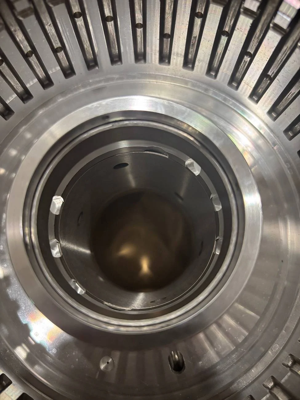

Yes that’s the main response I’m updating my trans. They designed a complete new drum from that issue.
They have machined back end cuts to retain that bearing on the updated drum plus they have machined 6 more oiling holes directly into the bearing itself..

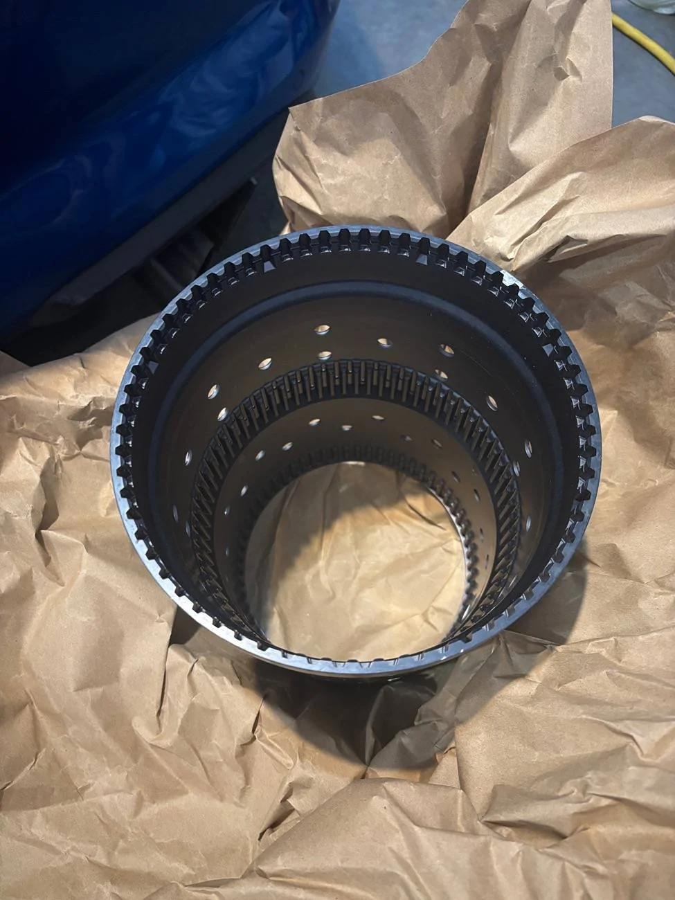

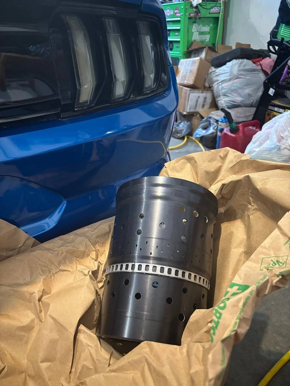

Here’s the updated basket. The anodizing is supposed to make it harder. Evidently the teeth were getting stripped in the old one causing the internals to fall or collapse down. You could essentially make these transmissions bomb proof. Just the new Raybestos gpz torqkit steels have all 15 teeth cut into them vs like 7 or 8. It honestly doesn’t seem as bad as everyone is going on about. Everything rides in that basket. Take apart and put back together and air check engagement and clearances on the clutch packs by blowing compressed air in the intermittent shaft. You can test the seals by hearing how much air bleed you have on each clutch packs when u do your air checks.
