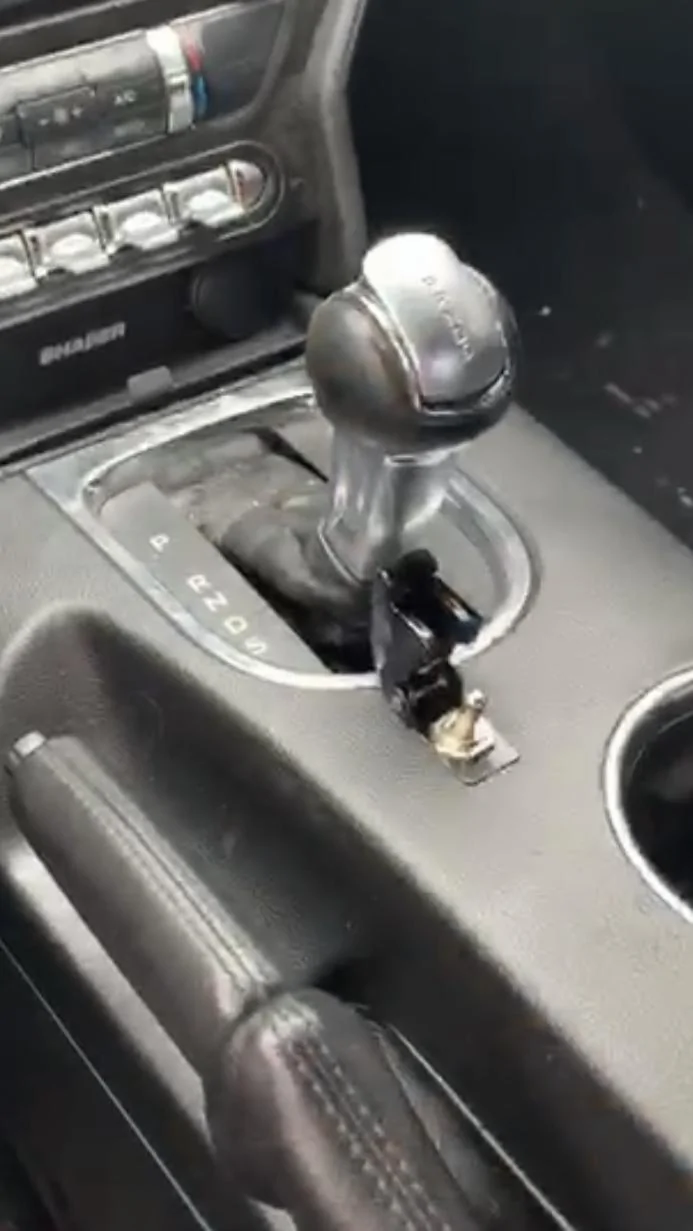

Yes. I did the Baers front & rear as well. I had to get them seasoned/bedded for it to hold. Now it works great. She’ll love it!
How do you get them “seasoned/bedded “ ?
In my 2015 Hellion car ,when I first did the aerospace front brakes the OEM traction line lock would hold .
When I then added the rears it would not hold for some reason. I ended up adding the JPC kit and it works but not had the chance to try it out at the strip .

Baer sent instructions. It’s a series of stops from 60-15 at different pedal pressures. Let it sit overnight and do it again. Kind of a PIA, but worked

I do my (low rpm) burn out in 1st gear w/line locks on, advance trac off, shifter in "S", and drag mode selected!
I'll give 2nd gear a try next season!!

For those putting the selector in S, what advantage does that give? With my selector in D, I am able to paddle shift to 2nd and when in drag or track mode, it seems to stay there as long as I don't approach redline for long enough to do a burnout. Is it that the car may shift to 3rd prematurely and not hold 2nd gear long enough to complete a good burnout?
I'll be going to the track on Friday with some MT ET Streets (bias ply) so i'll want to make sure I warm them up well.

I can't seem to hold the desired gear when in Drive.
So with the car in Drag mode/advance track off, and shifter in Sport, I use the left paddle to down shift into 1st gear and (after my burn out) then hold down the right paddle for (2) seconds (shifting into 2nd gear and releasing the full standard shift option) while rolling into the staging area. I then launch from 2nd gear and let the car shift the tranny as programmed (I'm still using the factory tune). And as a result (of not being in Drive) the car doesn't down shift into 1st at the line, plus shifts into higher gears at higher RPMs.

Shifter in drive.Press brake pedal.Hit gas pedal.Watch tach and let it shift on its own.Then roll out of box under power.Its that easy beleive it or not.lol

I keep mine in drive, but I might try starting it in second tomorrow. Either my unit is going out or my brakes are holding sometimes on the rear with one wheel peel. It never did that before I changed the breaks to Baer.
It doesn't do it all the time, but enough to warrant a change.

F the stock line lock. Just lightly hold the footbrake to keep the car from rolling forward. Barely have to hold it once you light the tires up. So easy. Also, regardless of which method you use, do all your other setup stuff BEFORE you pull up to the water box. You can set Drag Mode, AdvanceTrack OFF, and even the stock line lock up to the initialization part.
And I have $1500 Baer Eradispeed 2-piece rotors all around on my car. No increased wear worth mentioning. Don't worry about it and don't overthink it. Just have fun and send that bitch!!!!

It works good, but definitely takes a few times to master. Every now and then I'll foot brake it in a rush during a bracket race or I hit a sloped spot when I start to initialize it. I do like the fact that it doesn't wear on those with "fancy" brakes.
