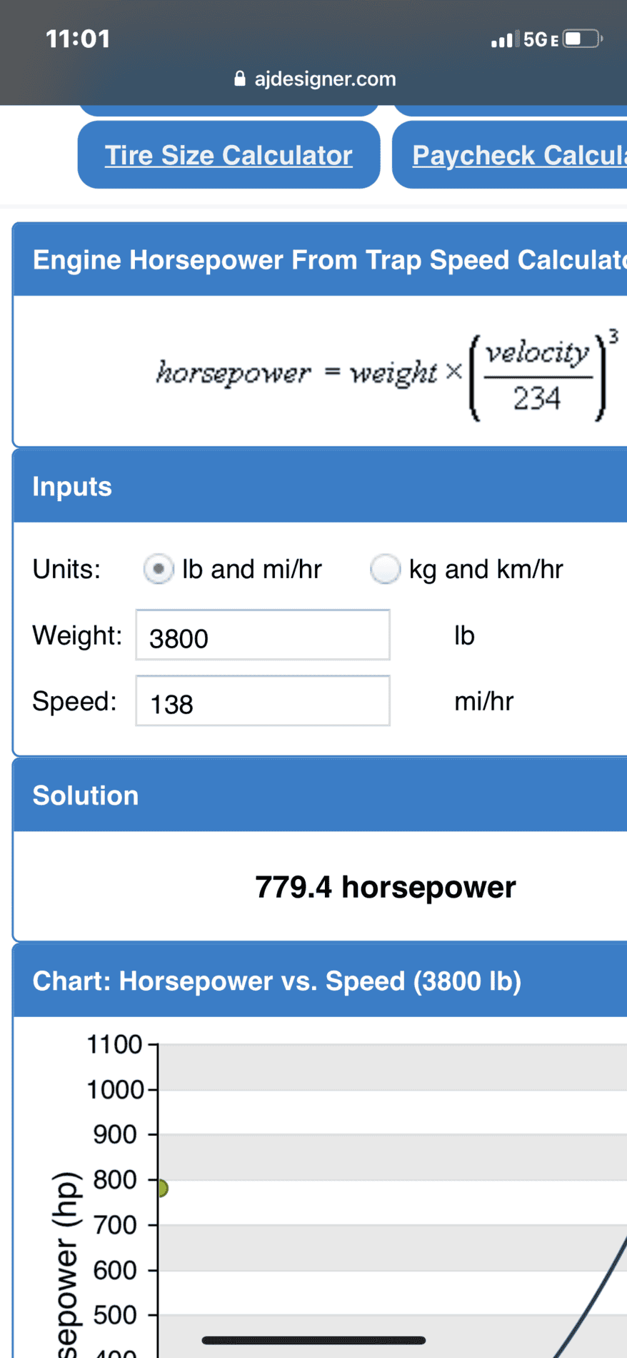

@Mach1soldier, how much hp/tq are you making to run that et and mph? Just curious as to what it would take for me to get there?

I’m at 840-860 horsepower. Estimating because I was at 930 but changed pulleys to a bigger one. Didn’t want to get kicked off the track.
