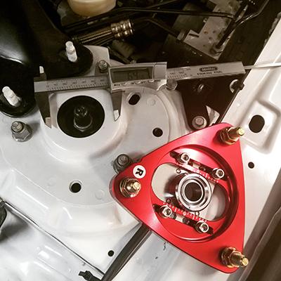

Has anyone enlarged the opening at the top of the strut tower to access camber plate adjustment on these cars yet? I'm about to throw in some camber plates and they really won't be accessible otherwise without dropping the whole assembly. It doesn't seem like I'd lose anything structural to just open it up. What do you guys think?

That's what I'm doing it for too. Yea it does look like some hard metal. I figured that was going to be a tough cut. Hopefully it's not too crazy :-/.

With my plates I've been told I can open up the top of the strut hole enough to max out the plates but not to go past that - no point. I'm guessing that'd be like 1/8" taken off all the way around? Maybe a little more, not sure.

Yea thats why I have that caliper out. I measured the max positions of the set screws to see how wide to make the opening. Looks like 2.5" hole saw is what it's going to take.

Pedders for their coilover kit. The camber plates came with zero instructions. The coil overs like many budget kits don't really include any non-generic instructions. Like it's literally one page that says take the old stuff out and put our stuff in, no specifics. I got the plates from CJ Pony Parts and their product page suggested dropping the whole assemblies and effectively adjusting off-car. That's a hard no for me.

Are they adjusting them off-car? I'm not sure how you'd get in there to adjust on-car. Since the camber plate sits inside the strut tower so the only access is that small hole. The sellers storefront description indicates that it's an off-car adjustment. That's not going to work for me since it's a track car and will add a lot of time to frequent alignment processes.

Yea my take is that is what they want me to do and I bet it's fine for street and light HPDE use. For me the small opening is going to certainly limit camber since the strut poking out of that hole on top of the strut tower will be limited in it's range by the diameter of the hole. The top of the strut will move with the camber and eventually hit the edge of the hole.
Also since the car is destined to be 100% track use I plan to be doing a ton of test & tune days until she is ready. I can see this becoming a real pain in the butt if I have to drop the assembly more than a few times as geometry gets adjusted to find what feels right for me.

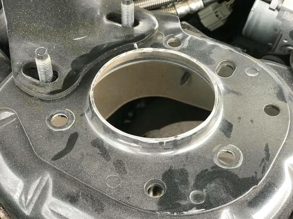

I’m gonna do mine tonight
