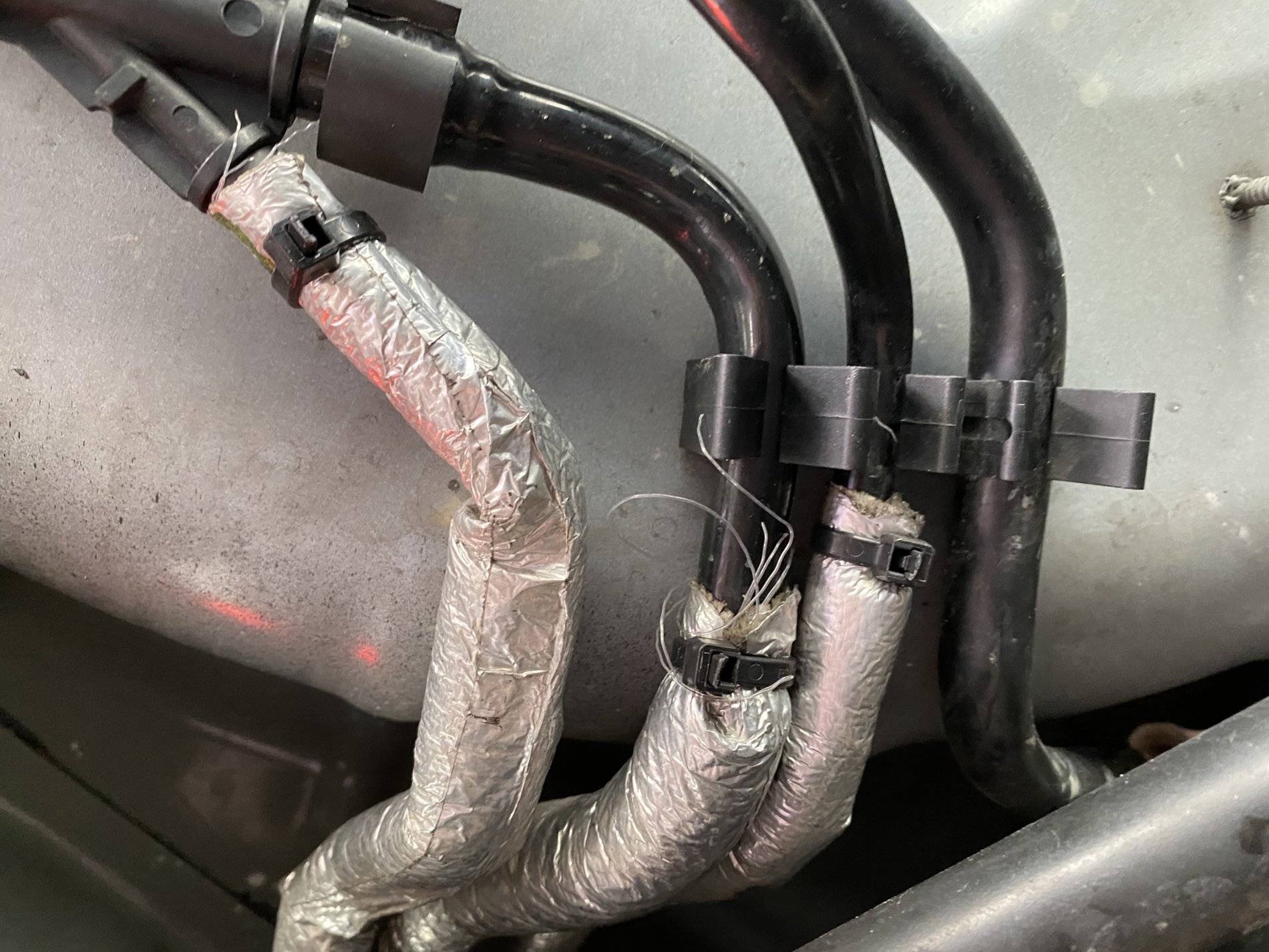

mclovin93535
New Member
May 6, 2019
Fort Bragg nc
Miguel
2018 Mustang EcoBoost
I had a squeak took it to The dealer for a 2018 mustang the dealer replaced all the rear suspension and all the control arms but it still Didn’t fix it a Friend Of mine replicated the sound But here’s a photo after the dealer zipped tied it thinking That would fix it
Texstang
Feb 21, 2016
101
30
'16 EB Premium PP 6MT
this is what my car does.
That sounds exactly like what my car is doing, thanks for posting the video. I first noticed it in the parking garage at work when I would turn into an incline. I can't really hear it when I'm up to speed all that much because road noise probably blocks it out, but I definitely hear it when the rear goes over speed bumps at low speeds or when I'm turning while reversing, as well as when I'm transitioning from a flat surface to an incline surface while turning.
- Checked the rear sway bar end links, they seemed fine
- Replaced the rear sway bar bushings, no luck
- Checked the torque on the lower control arms, toe links, upper control arms, and sway bar links, and they were fine.
- Checked the torque on the axle nuts, and they were torqued properly. I re-torqued them with blue Loctite and the noise didn't go away.
- Checked the wheel bearings with the car on jack stands, and my wheels have zero play, so I think they're fine.
I was about to start greasing some of the bushings and check the rear seat pivot points, but I'll take a look at these hoses (look like evap hoses to me, but I'll have to take a more detailed look). It looks like the sound is coming from the clips that hold them in place as they pivot. I'll see if that's the source of my issue too.
