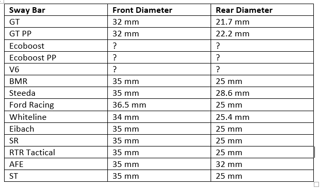

I was trying to decide what sway bar upgrade I wanted for me GTPP...
I wished someone had put a list like this together on this site. It would be cool if other members chime in with sizes missing from my list...
I went with the BMR's. Front is on middle hole, back in on inner most hole. Having added Michelin Pilot SS tires, the handling has improved dramatically. With the rear sway bar set to full tight, the car had a slight propensity to oversteer - which I did on purpose: you'll see why in a sec...
The Mustang, as many magazine and video reviews have noticed, has a slight dead area around center. My car was no exception.
From what I have found this is due to the toe-in specification being very close to zero. So having dialed the sway bars in for slight oversteer, I was able to crank a 1/4 turn (tie-rod) on each side to dial in a bit of toe-in. This corrected the oversteer and eliminated the dead spot... Handling and feel are just :D

Ecoboost PP has 32mm front with sticky bushings and 21.7mm rear bar.
Front
Rear

Better put solid or hollow on that chart. I think the Strano rear bar is same diameter as the stock PP rear bar, but solid (so stiffer) and adjustable.

I read that the stiffness of a bar increases with the fourth power of diameter? So compared to the GT PP 32mm front bar, the 35mm bars are actually 40% stiffer? That true?
Not exactly, but close. If they are solid then yes you can simplify it that way. Since most are hollow you have to take into account the wall thickness, which is a slightly different equation. The length of the arm to the main rotating axis of the bar would also have to be the same. In general it's a good swag at relative stiffness.

Even better would be an objective rate comparison like the sticky for spring rates. Seems like this info is a little hard to come by.

The GT, EcoB, and V6 front bars are all 32mm hollow, but the wall thickness is different. I haven't found specifications yet to compare wall thickness of these bars, so any comparison of their relative stiffness would only be speculation.
