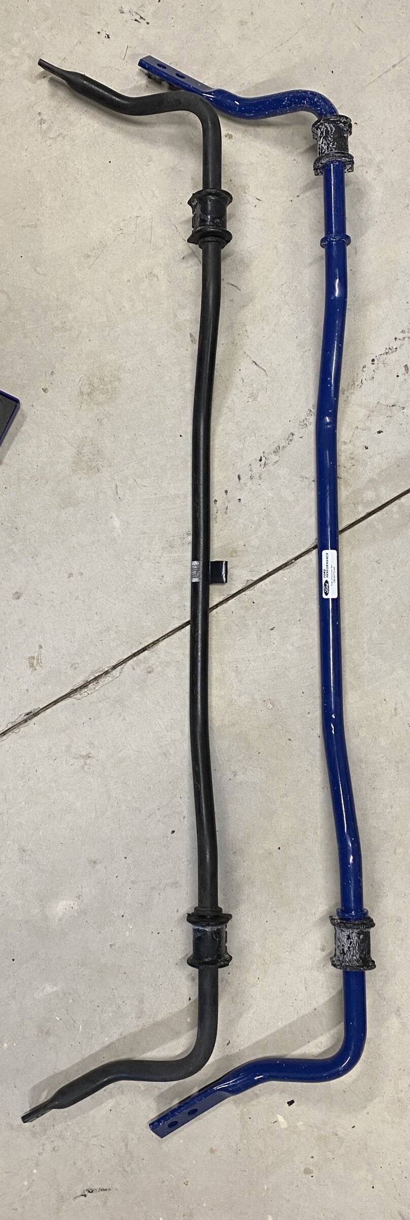

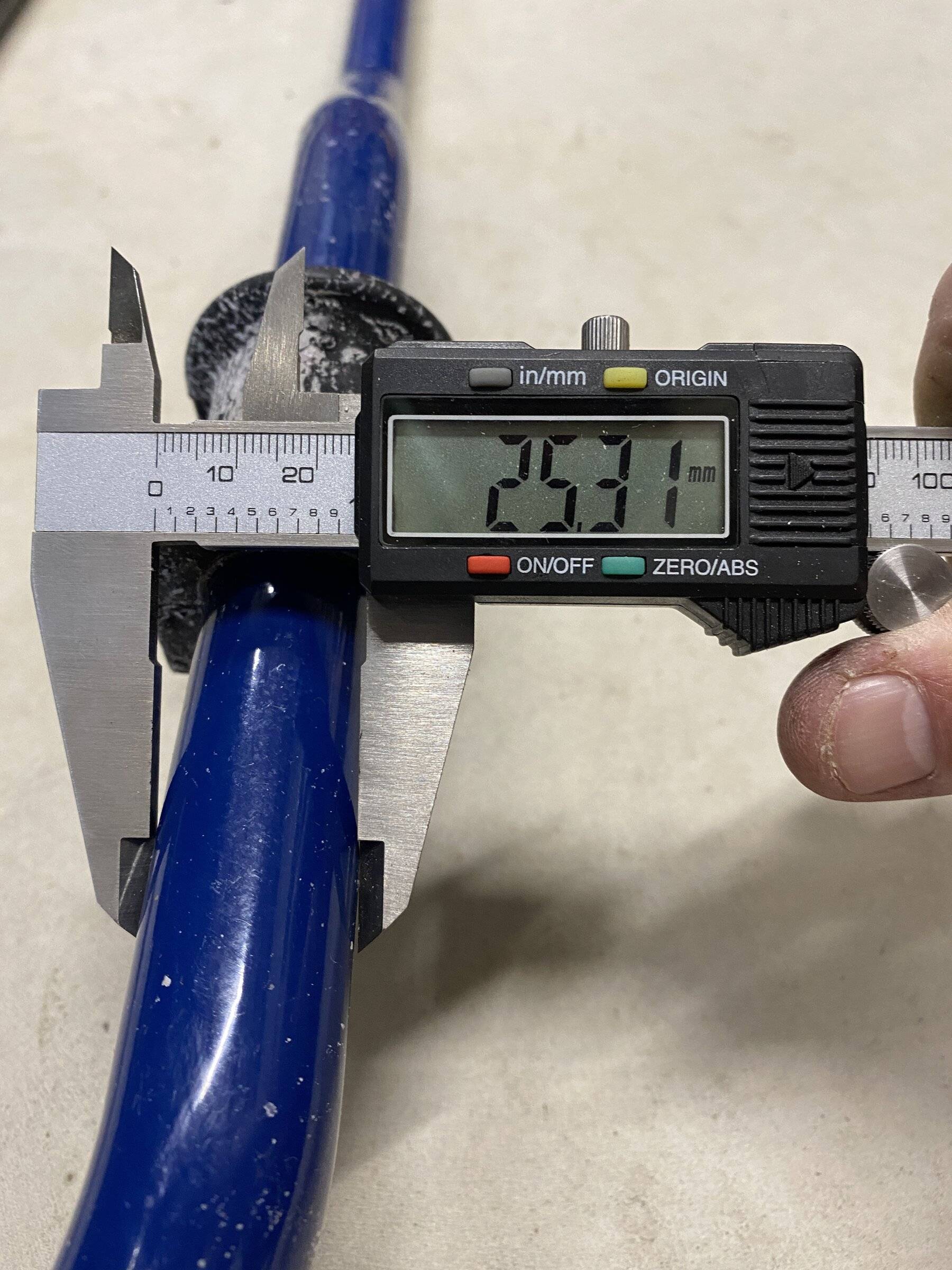

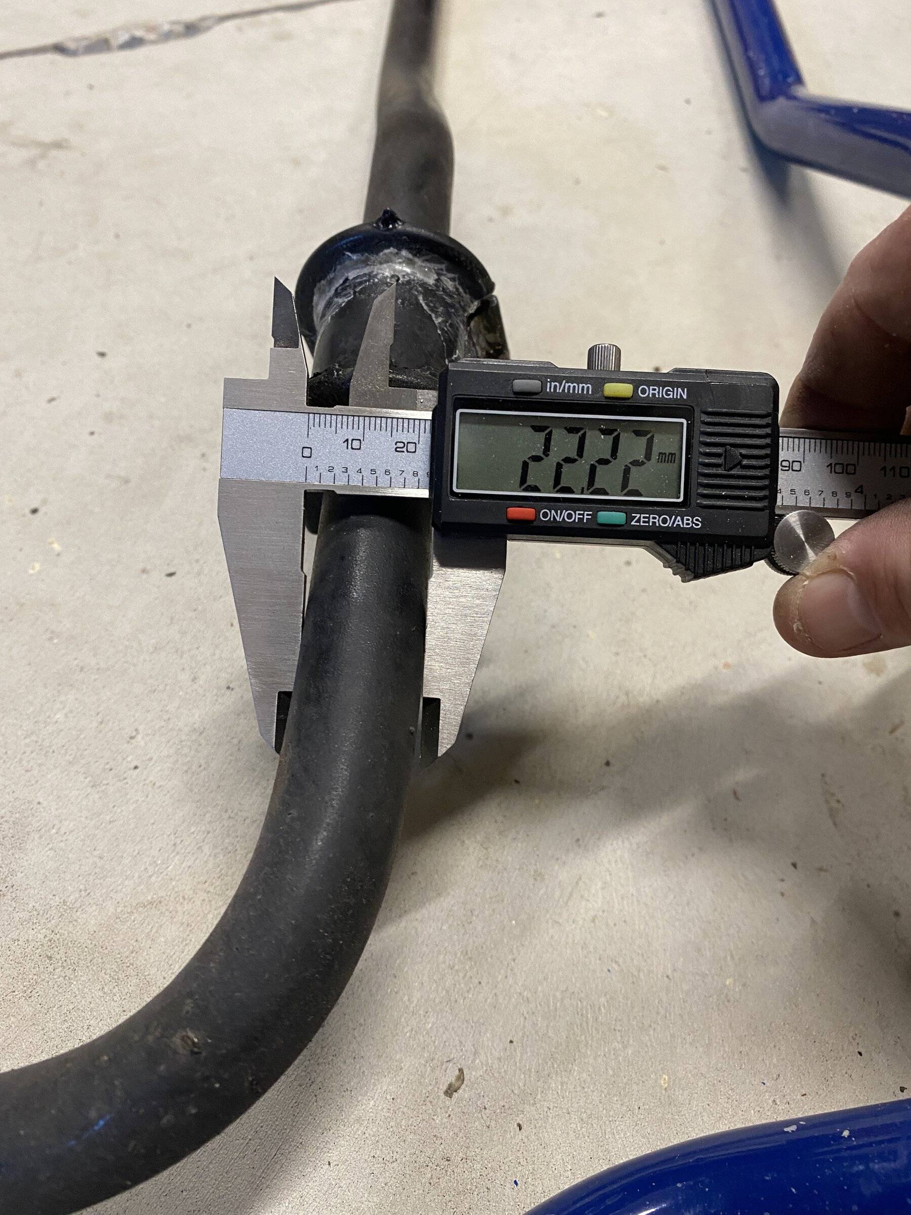

Already listed but I thought some pics may be helpful. FN PP1 rear sway bar and rear sway bar from Ford Performance MagneRide Handling Pack M-9602-M. (The coating on the new bar appears thicker)

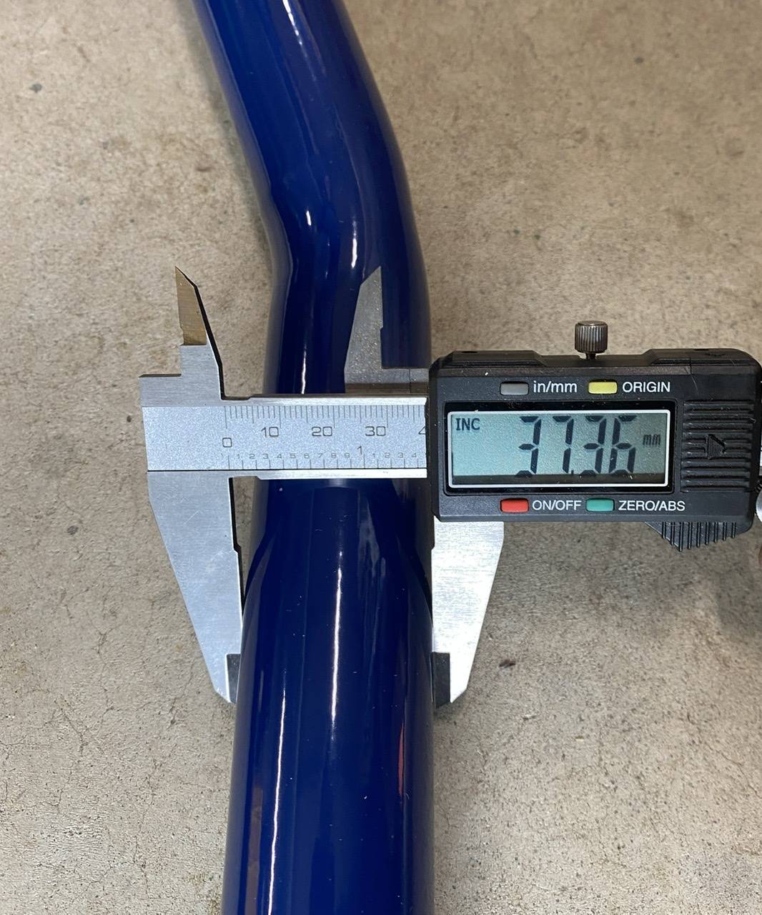

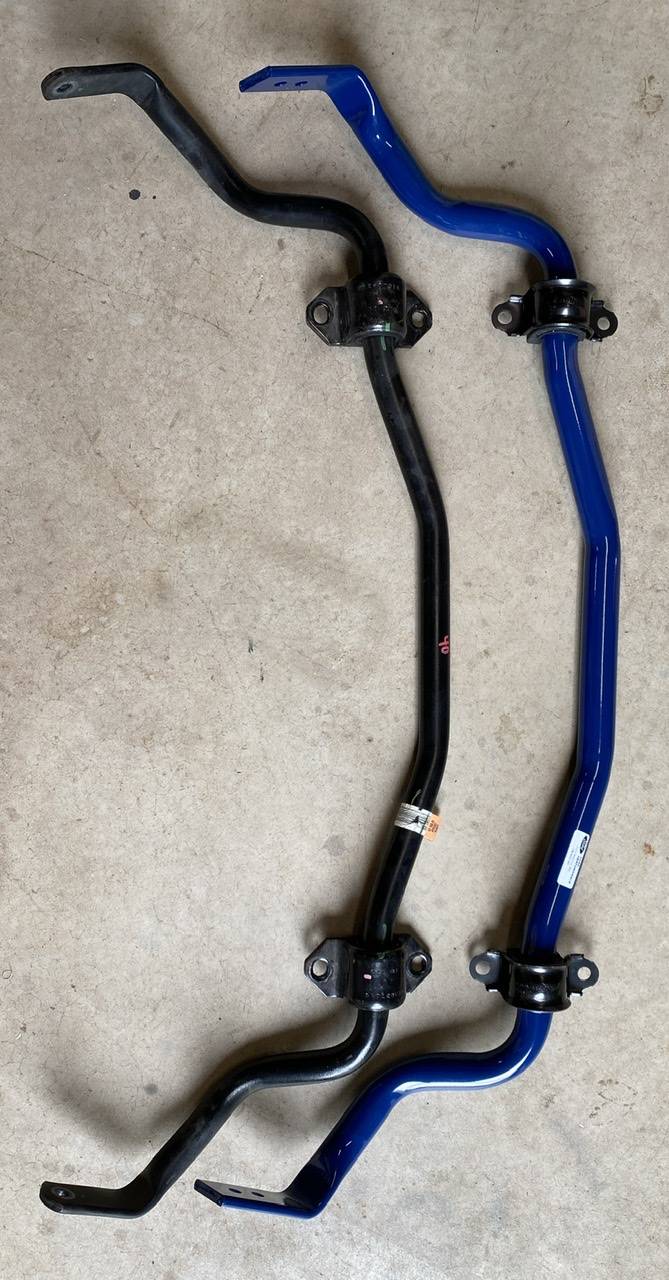

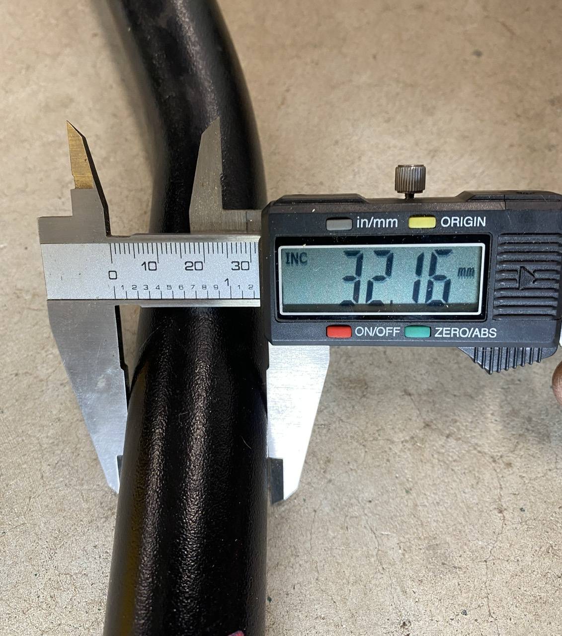

Adding pictures of the front bars. (OEM and new from the kit above)
