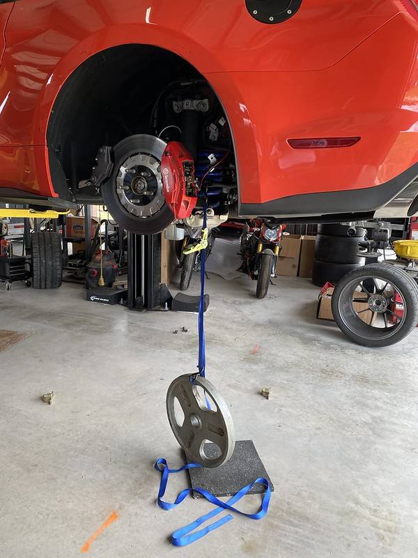

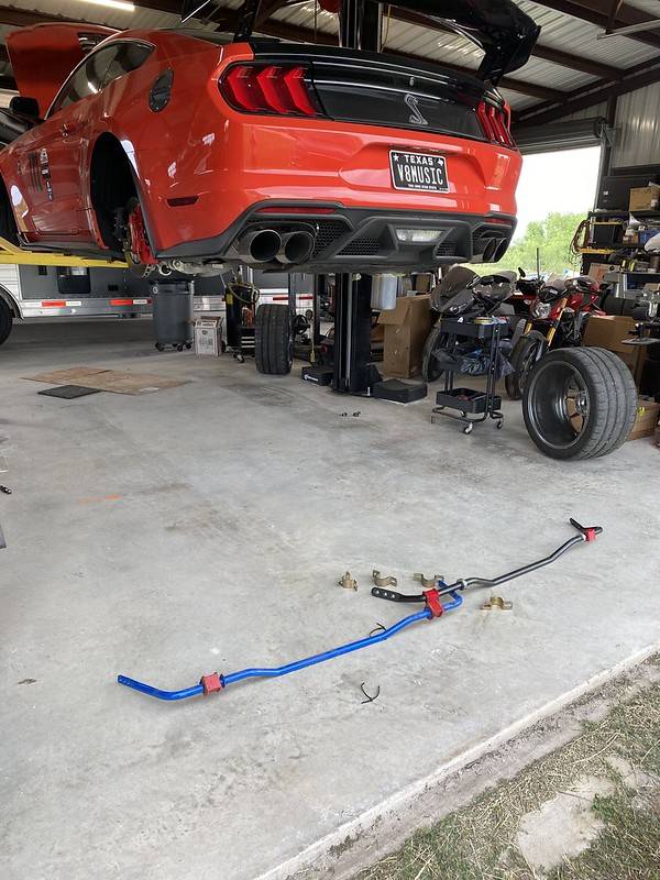

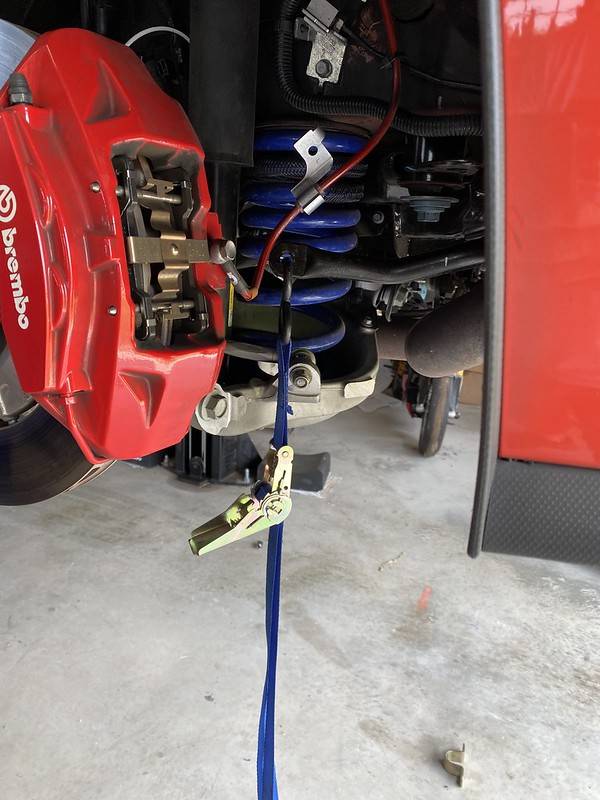

When I was tuning my setup, I wanted real data to compare 2 different bars and their hole settings. This works for the rear bar as it will deflect a meaningful amount with a modes weight (40-50lbs).
Basically strapped a fixed weight to each hole and measured the deflection. This let me change to a bar with enough adjustment range to cover my softest desired settings.
Main tuning was T3 at my local Eagles Canyon Raceway. Double apex, 50-60mph. No aero effects, and the double apex required good turn in, stable mid at steady throttle, but also needed the car to tuck the nose in on exit with a lift or throttle so as not to run wide.
My experieance, the steeda comp bar was too soft. OEM bar was decent, 25mm bar (bmr here) adjustment range went from soft to too much. Middle hole was very usable. Steeda comp was a stable setup but with too much push on exit, that took a large dose of throttle to neutralize. Sounds fun, but the rear slides and front push heat up the tire too much and they start going off quicker than just normal heat soak. So optimum time trial laps are very limited.
