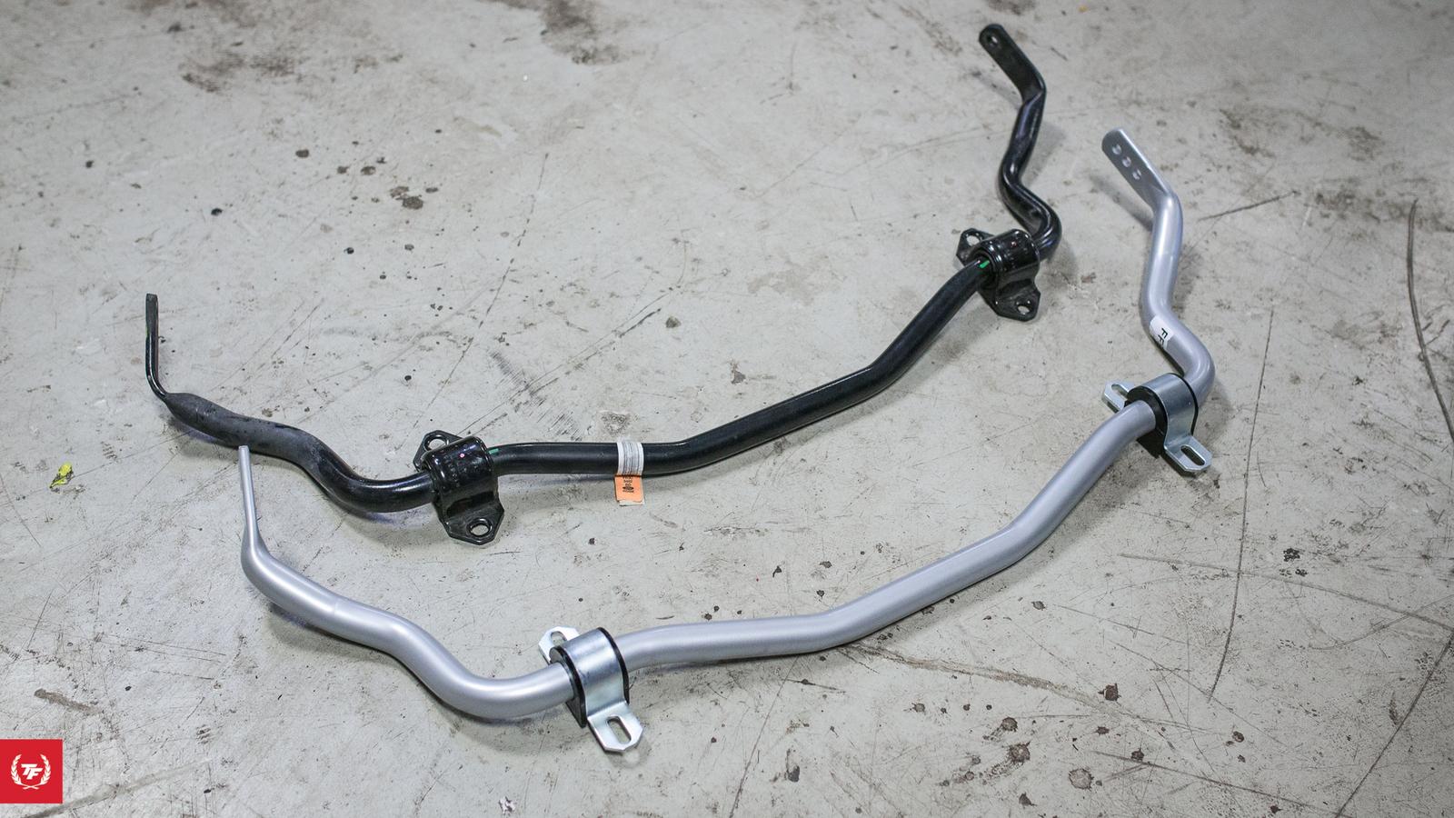

Yep you got it! As for why the GT350 bar doesn't have that, that's an excellent question to which I will ask. My thought is that ideally, you really don't want that kind of friction for a track car. That still doesn't explain the difference in brackets though.
In this picture you can see how the bracket wraps around rather than being a conventional U shape.

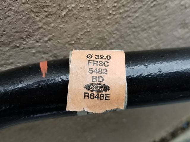

The front bar was a "FR3C 32 MM".
Time to add a new category on the list.

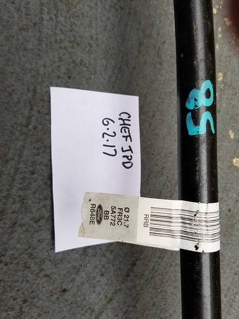

Yeah, I know, old thread, but I found this via a search for sway bar info so I thought I'd add my experience for the next person who searches.
Ecoboost PP has 32mm front with sticky bushings and 21.7mm rear bar.
Front
Rear
My '19 EB, non-PP, came from the factory with the bonded 32mm front bar as well, a lower K brace and a ~22mm rear bar. I need to pick up a battery for my caliper to see if it's 21.7 or 22.2mm.
Edit; old school analog caliper says 55/64 or 21.82mm, must be 2 coats of paint on it.
