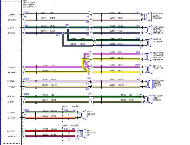

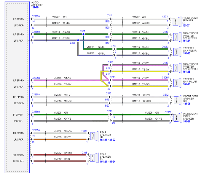

I'd be interested to know where you found these diagrams? Your sig says you have a 2017 S550, and maybe these are particular to that year...
I'm not aware of any real changes between the 2015-16 Shaker systems and that of the 2017, but there are subtle differences between the diagram you posted and the ones in the sticky. For example, the amp to speakers diagram shows the left/right/center outputs on plugs 2385A & 2385B, while in your diagram it shows them on 2385A & 2385C... all the wire coloring is the same.
I'm just suggesting that you might vet out your diagram to make sure everything matches, a number of folks on this forum have set their aftermarket systems up off the diagrams in the sticky... measure twice, cut once :D
I have personally measured the amp turn-on signal at +6v and not +12v
I checked and everything matches.

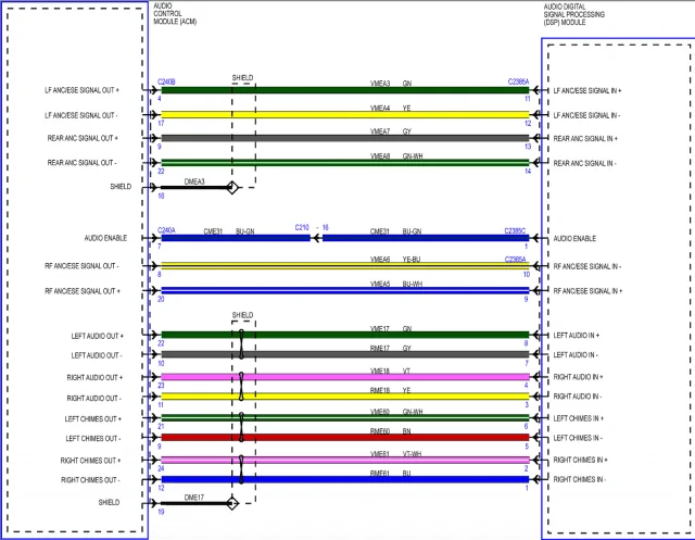

I've compared the AsBuilt Values of the DSP, ACM and APIM of both, and found that it is necessary to change 1 bit on the DSP and 2 bits on the ACM.
At the moment, I'm going to work on measuring what comes from the DSP.

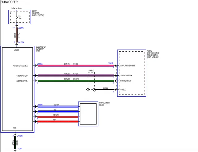

I think the missing piece(s) of the puzzle are the subwoofer amplifier and any connectors that go to it. On the OP connector C2385B from the DSP Module goes out to the SUB-AMP using pins 1,2,3, and 9.
The BCM connects to the SUB-AMP via C2280C pin 20.
The SUB-AMP then connects to the SUB at connector C4109B and is grounded by C4109A.
The woofer signal won't properly drive the subwoofer... too high of frequency.

I've made all the required software changes on the ACM and the DSP AMP and was unable to get any signal.
Based on the diagrams, the low level signal comes out from the DSP to the sub amp, but as far as I've tried, i got no luck.
