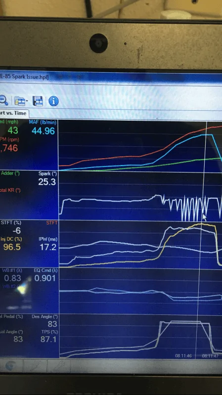

Just don't do it please. I don't care what your tuner tells you. I know there has been talk that it's ok but I've not seen anyone provide proof that the stock injectors are ok at that fuel mass (25% greater than stock) and even a mild NA bolt on car like mine well here is proof it's not ok even on the stock intake manifold. GT350, CJ or Boss 302 manifold cars will be worse than this unless making less power than me somehow. My mods are 1 7/8" long tubes with catless X and straight through mufflers, Pmas intake, and my own custom E-85 tune using HP Tuners.
First up are two screen shots with the stock injectors.
Sorry the cursor is not in the right spot it is off in a different spot off screen so ignore the IDC reading of 82% that's not relevant or accurate here. The yellow line for IDC peaks at 97% at 6900rpms (ceiling in the scanner is 100% and you can see how close it is to the top line

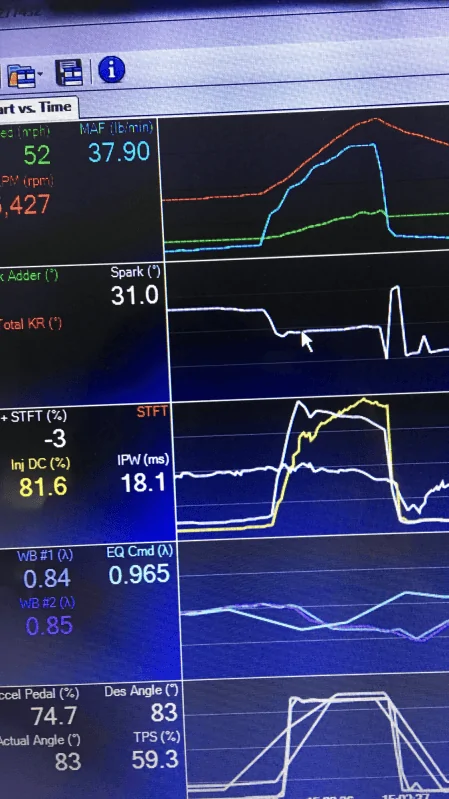

Another shot with stock injectors this time with the cursor in the correct spot (just don't mind the retarded timing sine wave the ECM was limiting spark badly in first gear to limit torque until I figured out why)

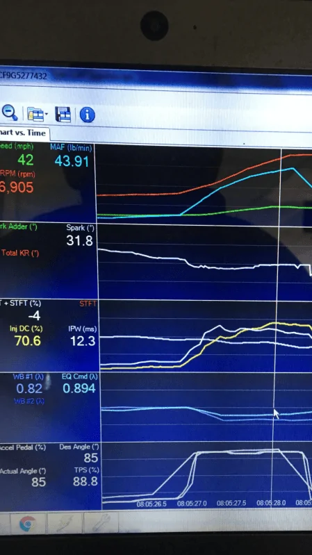

Now with LU47s and same tune except rescaled for the new injectors.
Note that is just over 70% now and honestly the car is much happier now. It would sometimes show "inadequate fuel flow" as a driver demand torque limit source before but it does not anymore.
