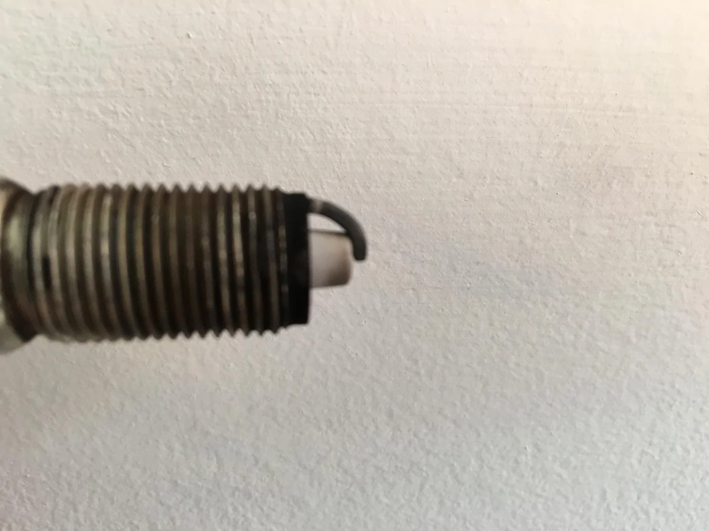

Update/fix
Problem found/fixed...bad plug. I didn't replace plugs(I should have)I just pulled and inspected them, and reinstalled. After pulling them a second time I found insulator and electrode completely broken off of one plug. They were the Denso ITV22 for what it's worth.

does a broken plug mean there is pre-ignition / detonation ?
Could be a lot of things, but the very most likely cause would be detonation.
If the insulator and electrode have broken off as you have stated - those pieces are now where....

I have problems with my denso's too, last set my cyl 3 insulator came down just like that. I ended up driving maybe 50 miles on the plug, idle would have the bump every few seconds and the car felt down on power. Pulled the plugs and found the offender. Now I've got a new set on, AFR goes up and down everyone once a while and sometimes my idle feels a little rough, especially on cold starts, the normal four cylinder hum has a few extra bumps but not like the pronounced misfires from when the plug broke. Gonna pull them tomorrow when the car is cold and check them all. My plugs are always black around the first few threads.
Pretty much this^^^^^^
Once that porcelain drops into the cylinder, damage usually begins exponentially if your still driving it like that...
cracked in two is more accurate than broken off, the insulator/electrode moves up and down about a 16th of an inch.
