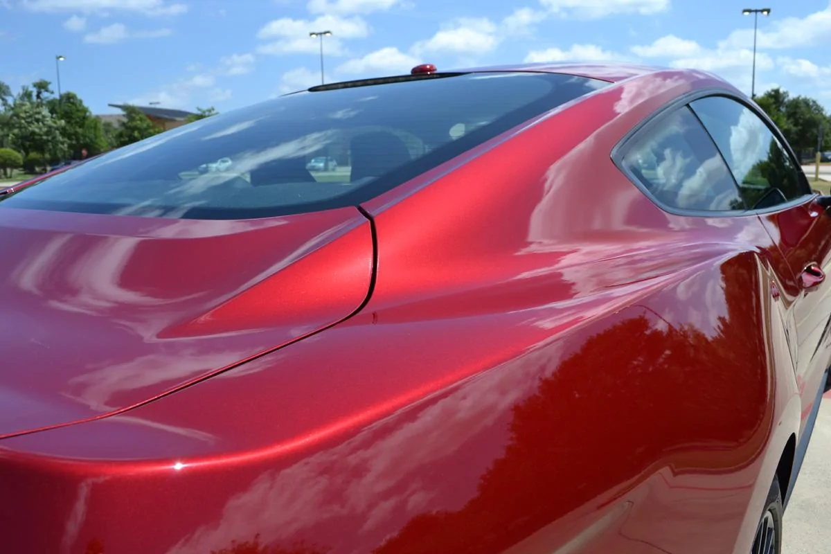

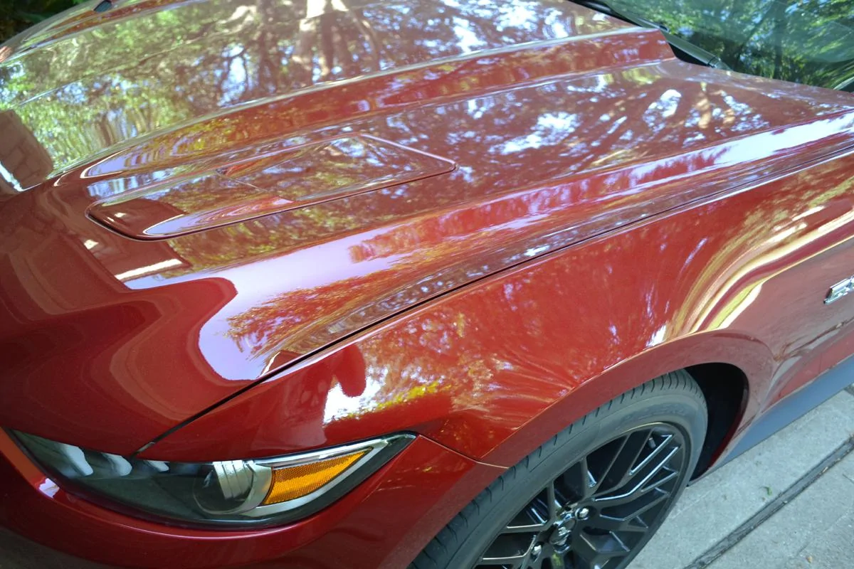

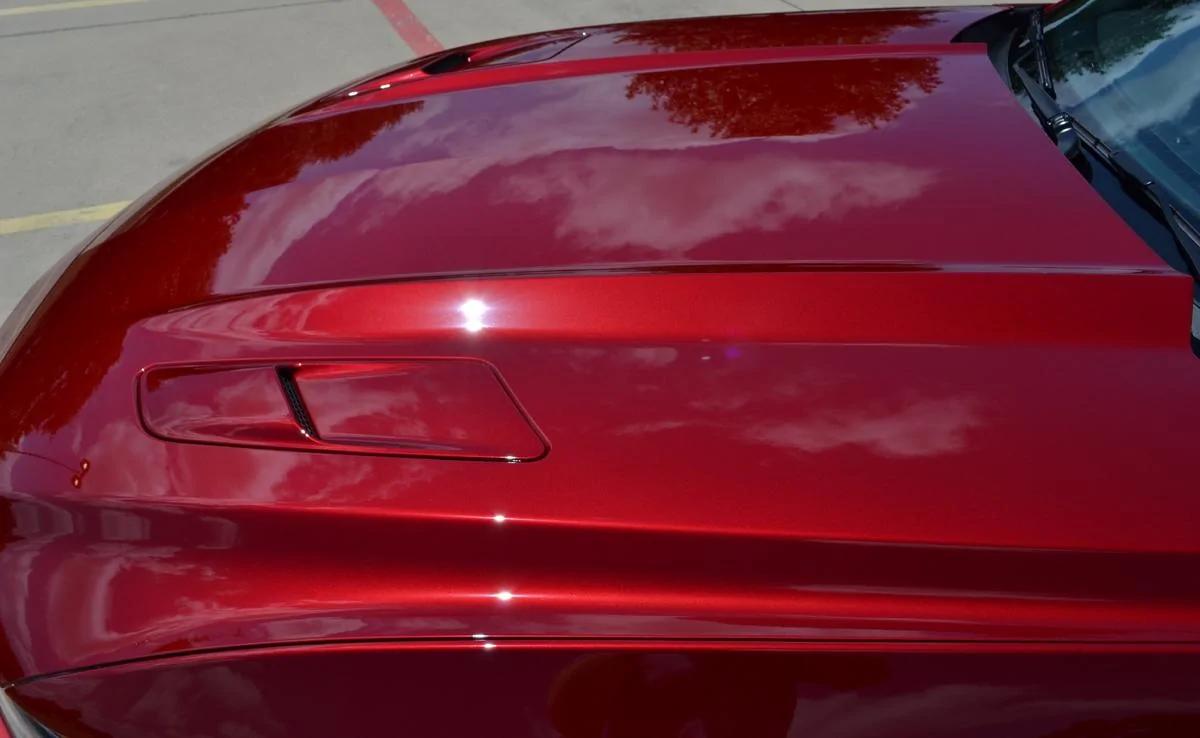

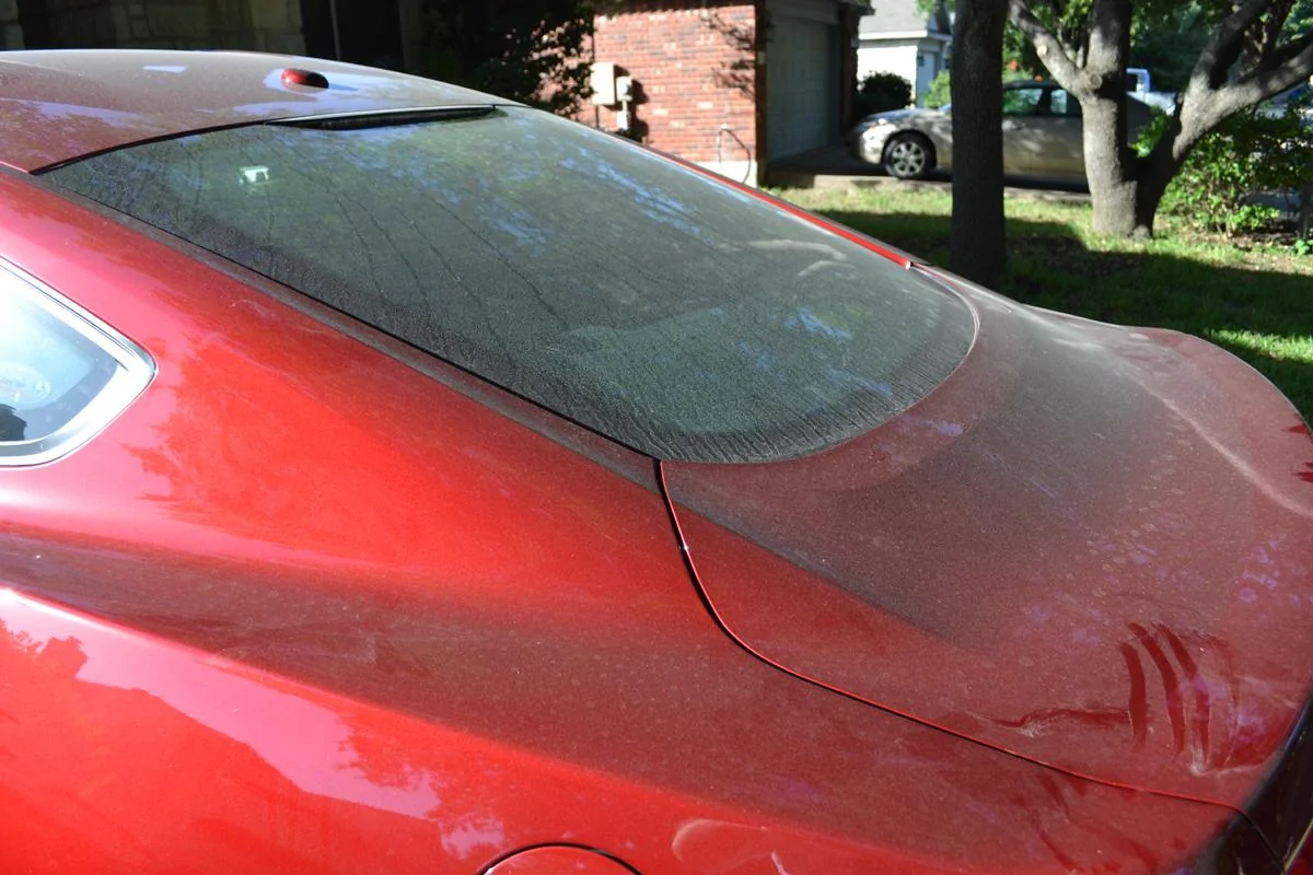

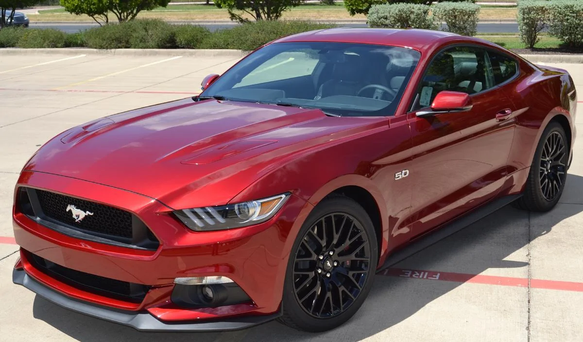

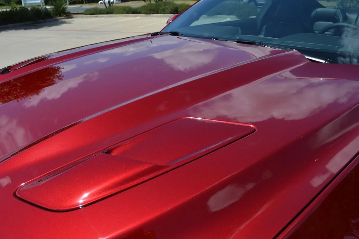

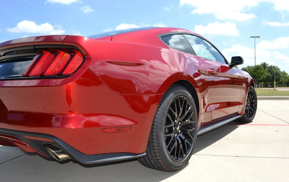

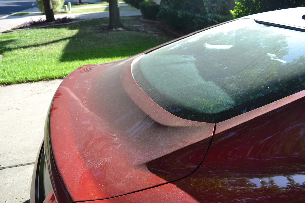

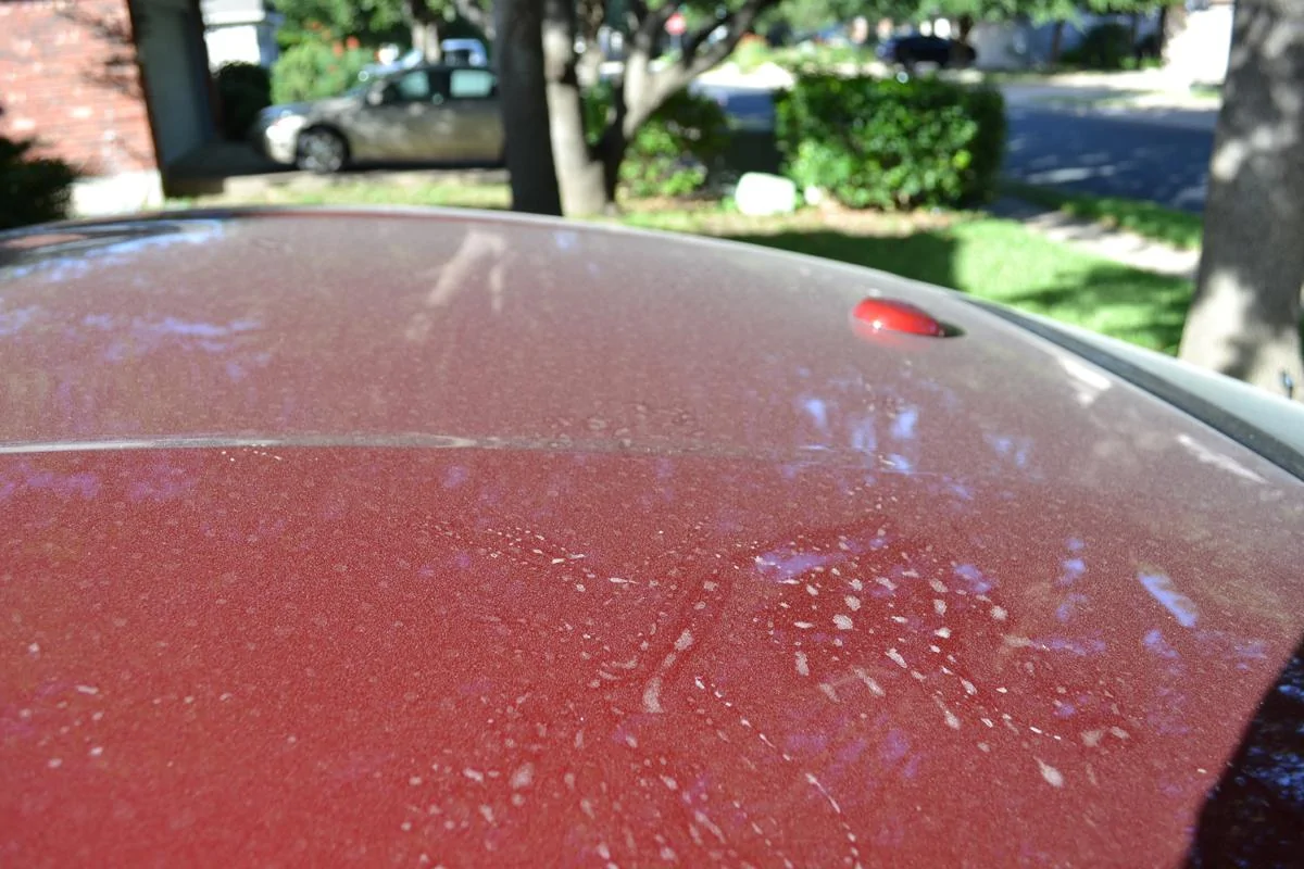

Some of you may remember my original full detail thread for my black 2015 GT: http://www.mustang6g.com/forums/showthread.php?t=19194
This time it's my 2017 Ruby Red GT
Car was delivered yesterday (7/6/2016) and I spent about 5 hours yesterday evening giving it the treatment on the exterior. As before I specifically asked that they not wash or "detail" my car - which they honored.
Different products this time I went with my old friend Zaino.
Process:
Wash - Chemical Guys Bug and Tar wash
Clay Bar
Zaino Z2 with ZFX
Zaino Z-CS
Zaino Z-8
Here are some before (as delivered) and after detail shots.
