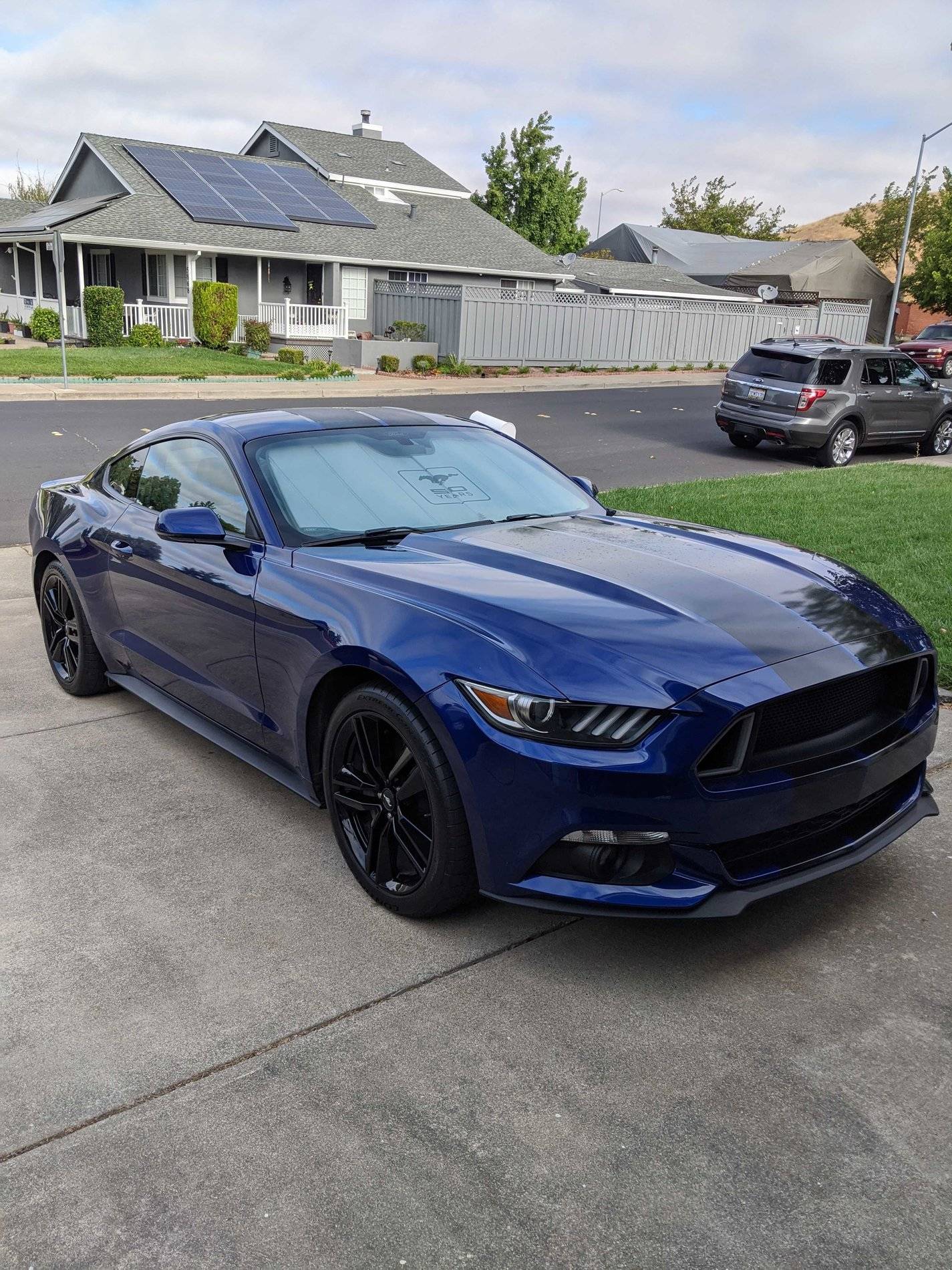

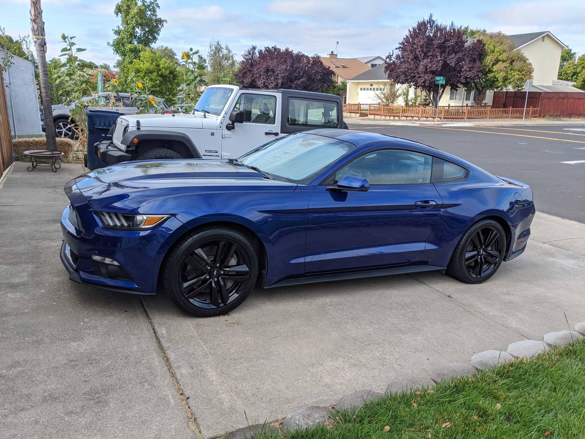

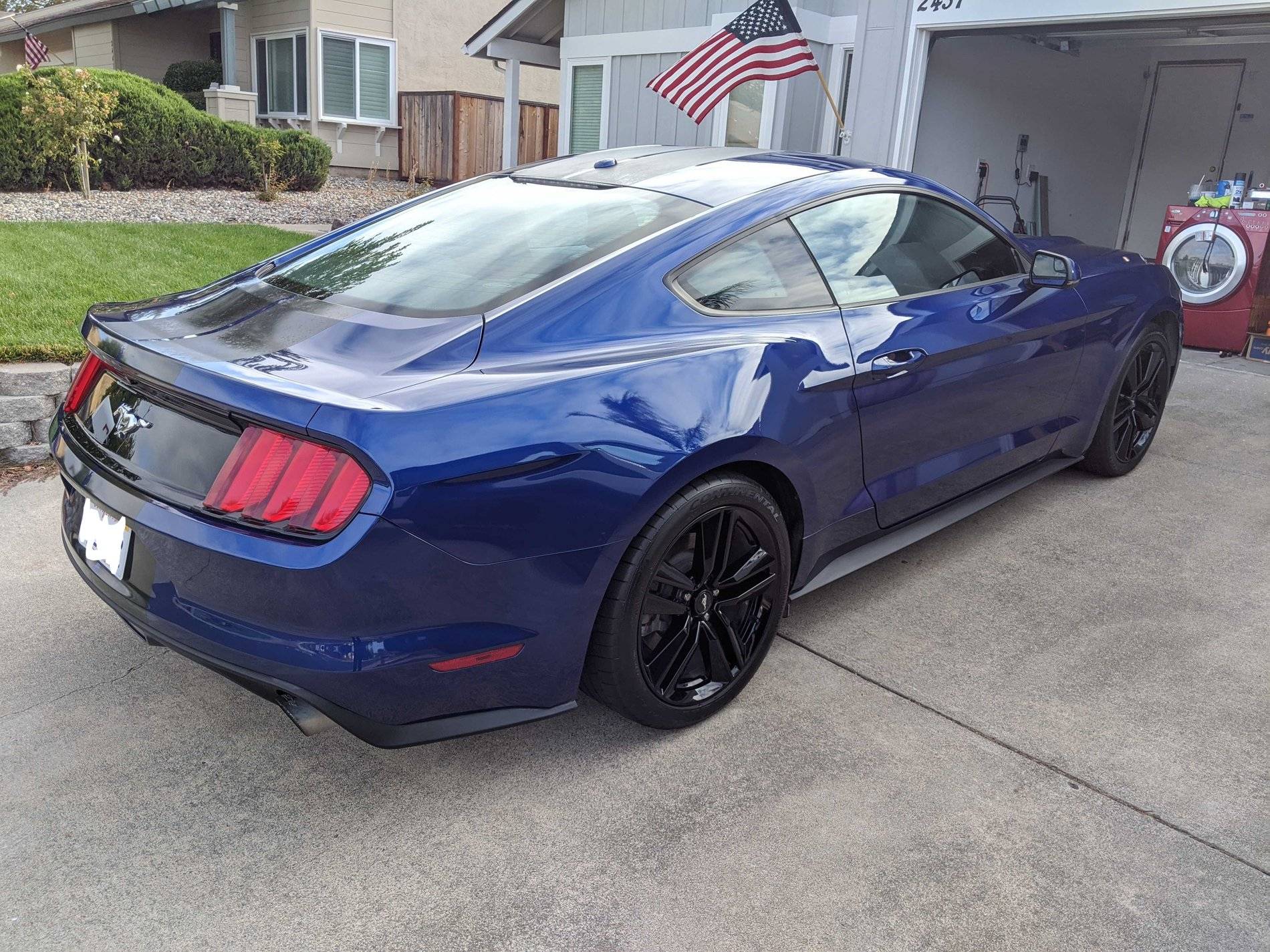

The previous post inspired me to document my detail process as well.
Started off with a pressure washer wash using Carpro Reset in my foam cannon (yes that stuff actually foams!!).
Followed up using Adams Iron Remover as my chemical decontaminate.
I felt around my paint and it did not require a clay bar. I probably should have just because but I do not have the funds for a machine polisher, so did not want to do more damage marring the paint without the proper equipment.
I opted to hand polish using adams revive hand polish to remove any remaining wax, minor swirling, etc.
I did a contactless wash with my foam cannon so get rid of polish residue.
Applied 2 coats of Turtle Wax Hybrid Ceramic Spray Coating (24 hrs between coats). Planning on maintaining with their Hybrid Wet Wax every couple washes.
Overall, turned out great! Obviously if I had a machine polisher, I could have done the full thing, but it looks great IMO.

Looks good. I've been using a clay towel (yes, it's literally a towel with clay imbedded in it) and I mar the paint less than with the clay itself. The secret of course is lots of lube. I should make a t-shirt that says that. LOL
IMHO spending the money for a good quality polisher is well-spent and it will (should) last you the rest of your life. You will spend money on pads and other consumables, but the polisher makes stuff so much easier, especially as the car/paint gets older and requires more work.
Just don't buy some cheap Chinese crap from Harbor Freight.

Yeah I do plan on investing in one, its definitely on the list lol

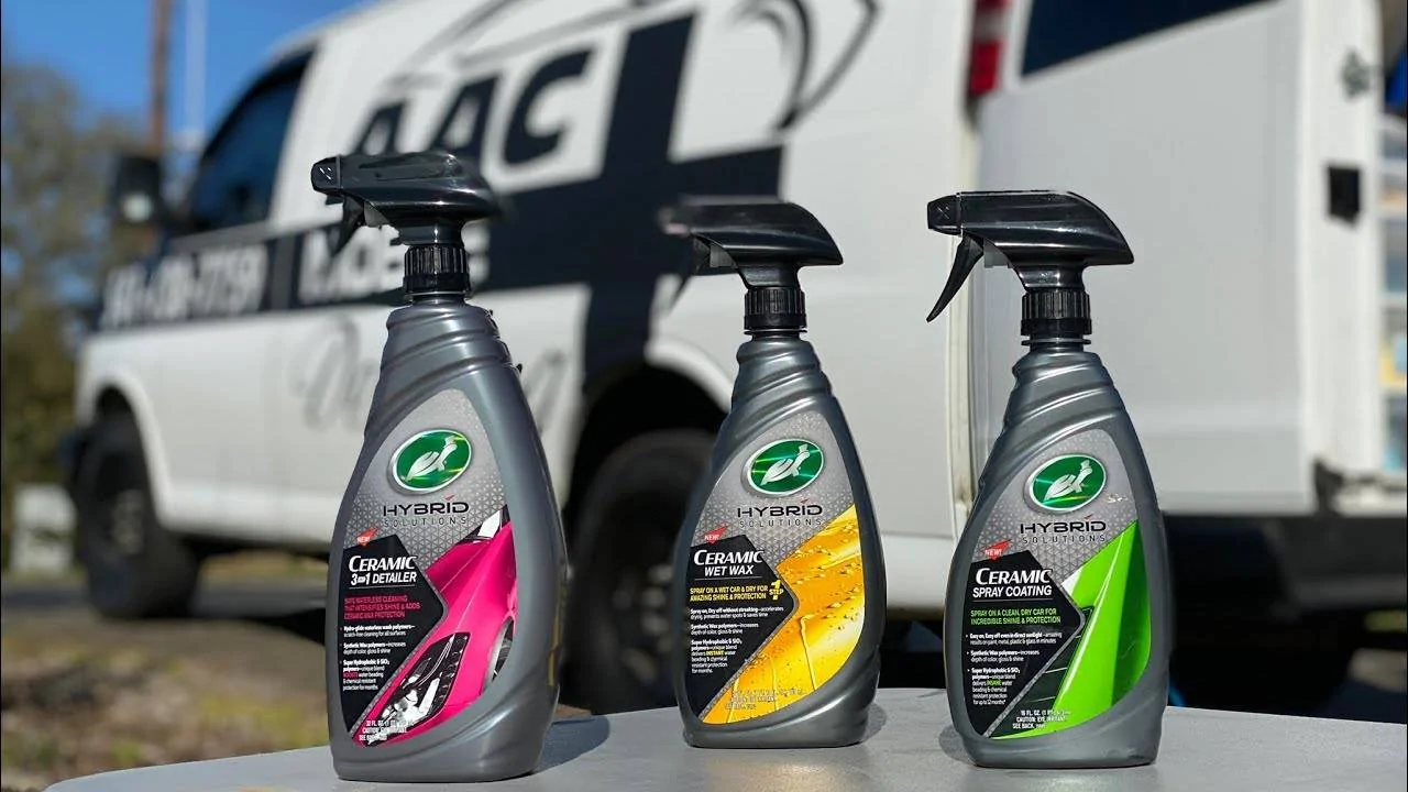

Here are the products I used minus the 3 in 1 detailer spray, might try that eventually for quick touch up in places between washes. Yeah to get the proper results from the ceramic spray coating, a proper prep is necessary which includes:
-Wash with a regular shampoo (no wash + wax combo), or a strip wash to help remove previous wax
-Iron remover (chemical decontamination)
-Clay bar (if the vehicle needs it) (physical decontamination)
-Compound + polish (removes previous protection, fixes imperfections in the paint)
-ISO alcohol spray (removes polish residue, I subbed this step with another quick wash since did not have this product)
-1 layer of Ceramic Spray Coating, 24 hr cure time
-Next day, 2nd layer of Ceramic Spray Coating, 24 hr cure time
-On next wash, before the dry step, 1 layer of Wet Wax, dry car as normal
