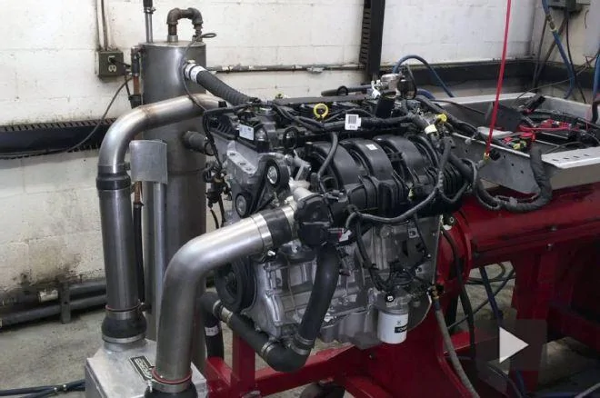

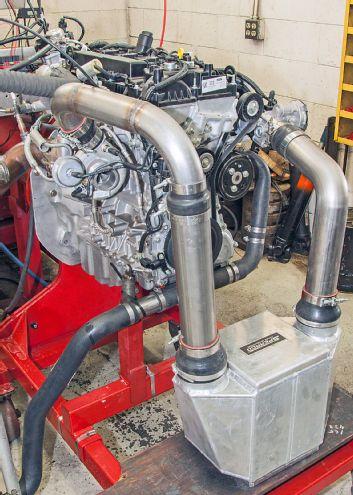

Ken Duttweiler has got the 2016 Mustang EcoBoost motor up and running on his dyno as of March 2016. The engine has balance shafts; you’d hardly know it was just a four. His dyno rig’s standard intercooler is up front. HOT ROD Readers are used to seeing V8s here, but Duttweiler has high hopes for Ford’s latest high-tech marvel.

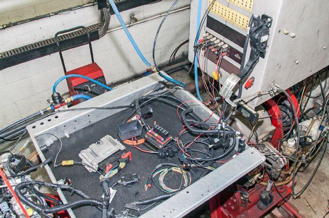

On a production car, the engine control unit (ECU) interfaces with the body control computer and various antitheft features, making it pretty hard to run as a standalone unit. Fortunately, Ford Racing sells an ECU and harness for its 2.0L standalone crate engine, and that’s what Duttweiler has adapted to the 2.3L. Note the electric accelerator pedal mounted at upper right that’s included in the Ford kit; it’s required to get the motor to run, even on the dyno.

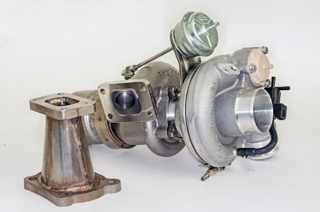

The first mod waiting in the wings is this larger Borg-Warner turbo. Duttweiler’s already built an adapter to bolt it onto the 2.3L’s integrated cylinder head/exhaust manifold assembly.
