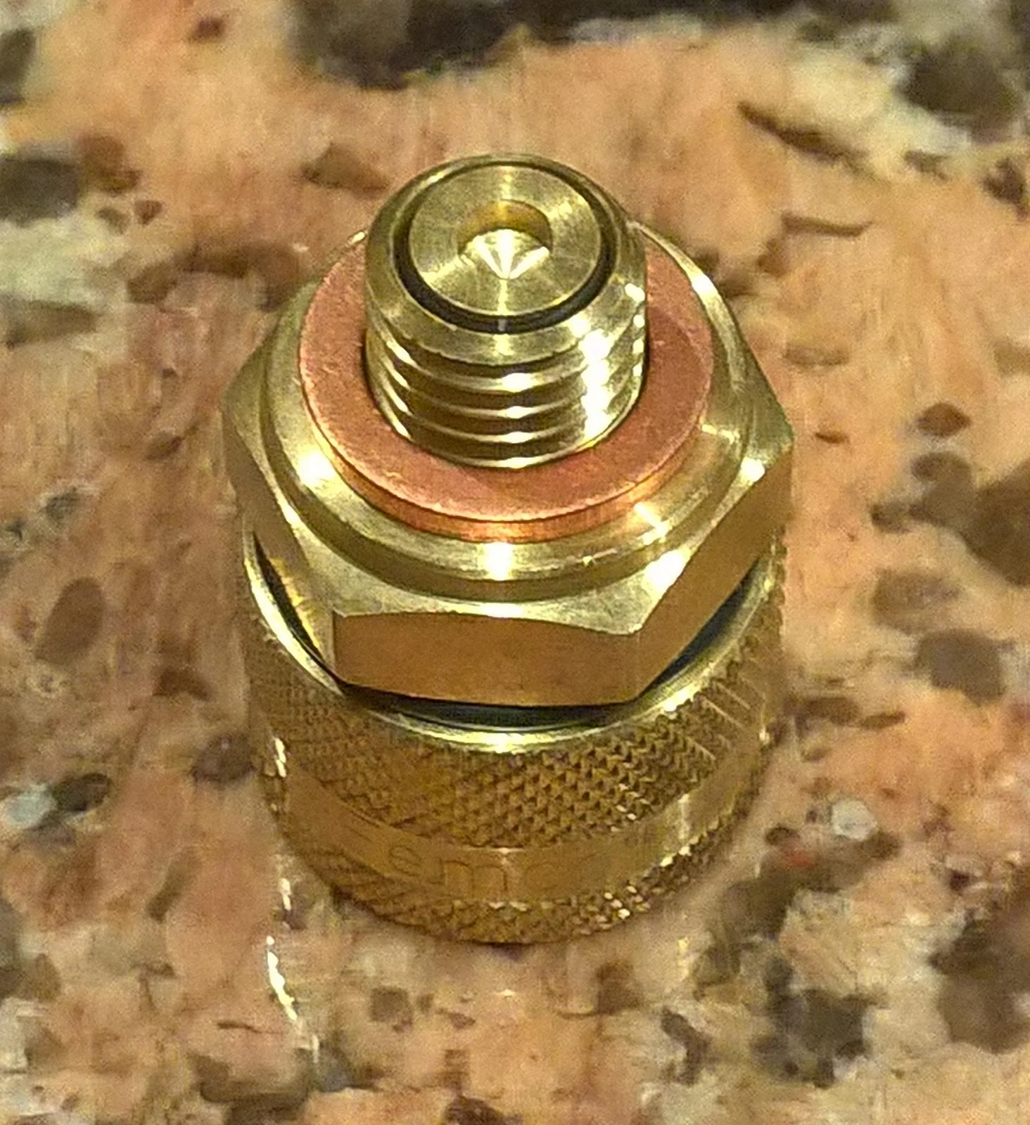

Below are some pics of my Femco valve for Mustangs. Coincidentally it is the exact same spec valve as the NoSpill in my Cadillac. Both are 12mm x 1.75 threads.
Here is the part that threads into the oil pan. The valve is closed. A later picture shows the valve open.

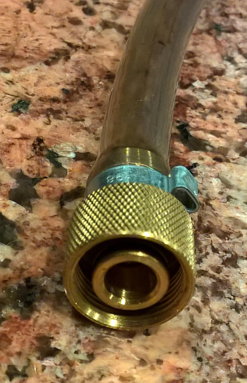

The following is the "drainer". To drain oil, you remove the knurled cap cap from the valve and screw this on in its place. As it tightens, it pushes the valve open. The hose spins free to make use easier. The same drainer is used for a wide range of valve sizes and virtually every non commercial vehicle will use this particular "drainer". But the first vehicle you equip with a Femco (or NoSpill) valve will involve purchasing a "drainer". Additional and future vehicles can all share the same "drainer". The seemingly large diameter of the drainer side of the valve is so that one "drainer" can be used with a very wide range of drain sizes.

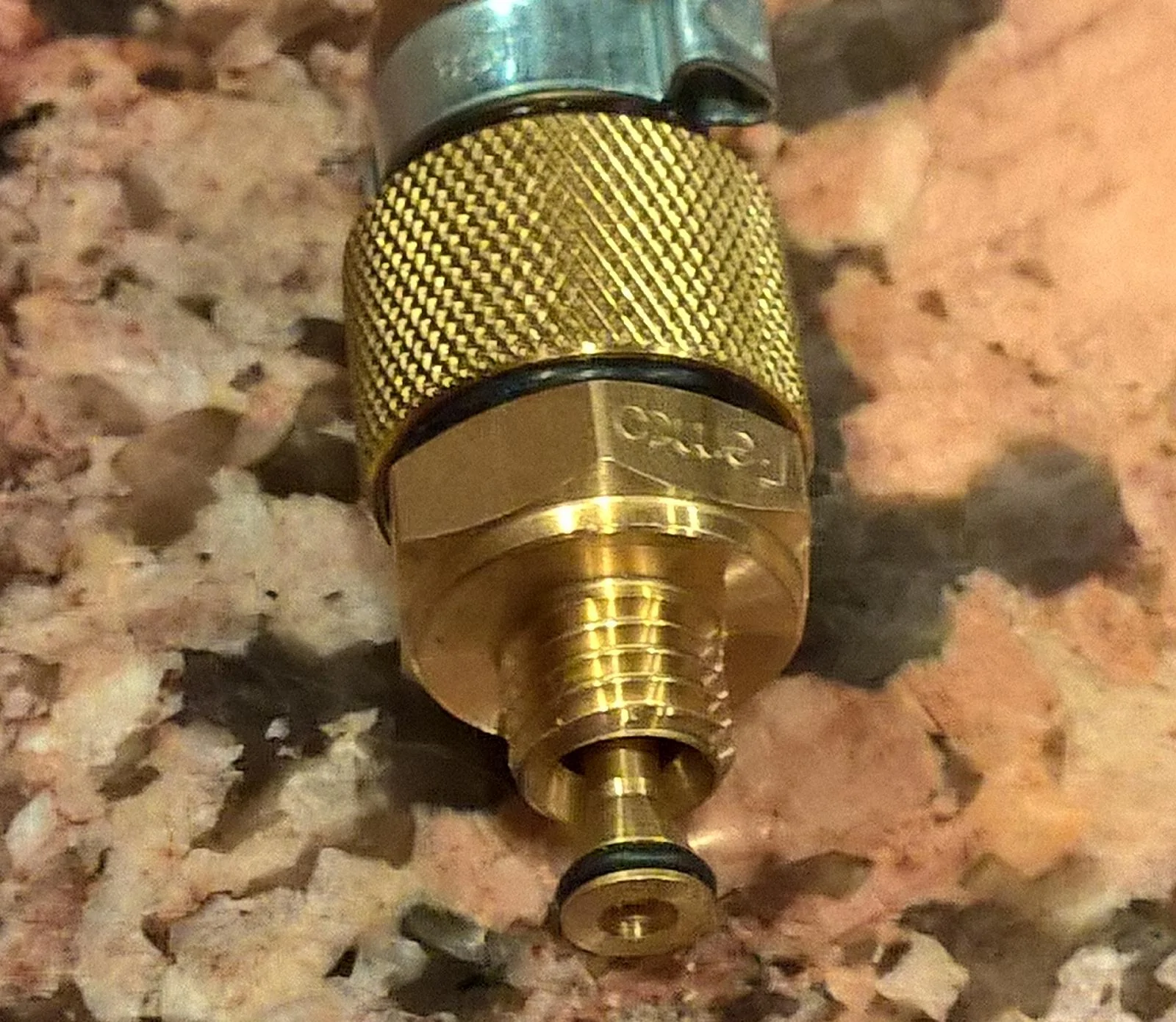

Here is the valve with the "drainer" screwed into it so you can see the valve in its open state inside the oil pan.

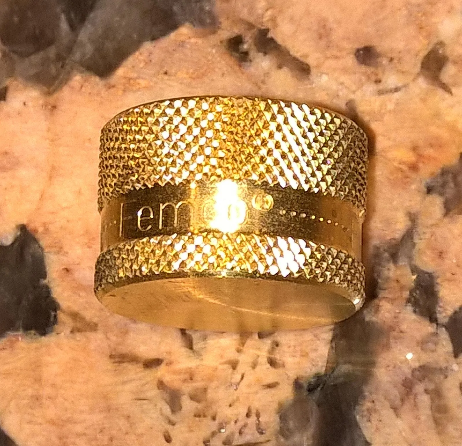

Here is the knurled cap that protects the valve mechanism from the elements AND provides a second barrier to leaks should any internal part fail. It is hand tightened against an o-ring so no tools are needed to drain the oil unless you think of the "drainer" as a tool.

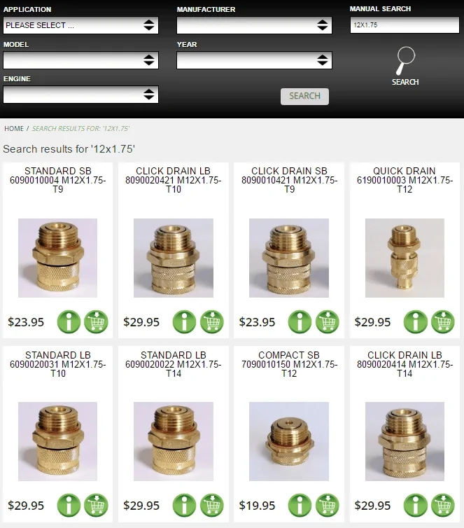

Can you post the name of the item since you say it doesn't come up in search. The name (Tn) tells the thread depth; n is the depth in mm.
Ground clearance isn't necessarily the most important aspect. The thread length also matters because the longer the threads the more oil will be left in the pan except for horizontal applications where ground clearance would be the same regardless of the style.
And its possible the SB/LB (small/large outside threads) designation is important if one is available for more vehicles than the other. The same applies to standard and compact since a drainer will only work with one combination of Standard/compact and SB/LB. Those matter to anyone contemplating putting Femco valves in multiple vehicles now or over time.

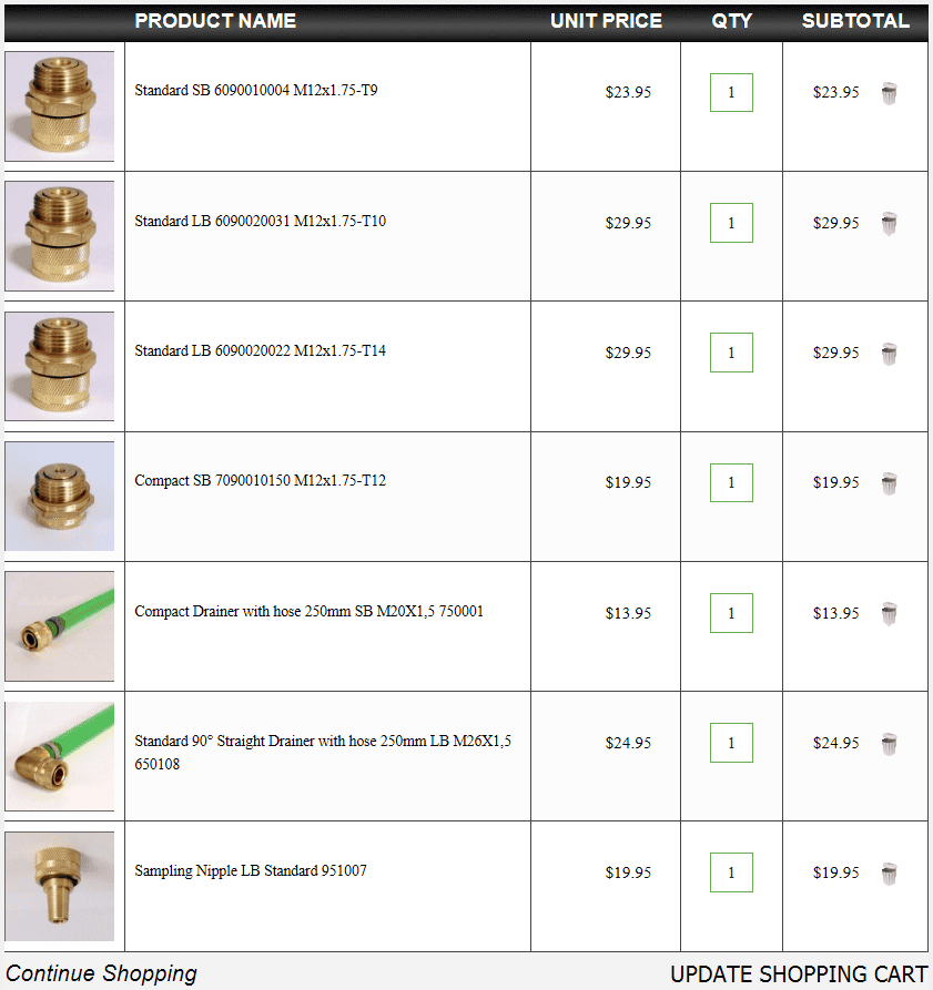

First image is results using your suggested search technique.
Second image is a shopping cart with all viable drain plugs and accessories that we might consider. (Clearly they are using some standard and not actual photos for similar plugs.)
Yes, the compact plug is 12mm above the gasket, but obviously shorter external to the oil pan. Latter feature wins, IMO.
My head is starting to hurt. :headbonk:
