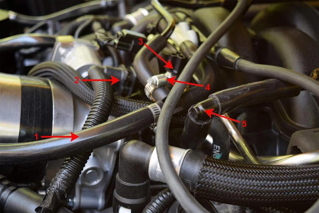

Step 12. Now were going to talk about vacuum lines. This is your to get list from a local hardware store. 1 Foot of 3/8th's " silicone vacuum line. and 6 inches of 1/2" silicone vacuum line. and 1 90 Joint with a 1/2" side leading into a 3/8th's " side. that is your list of things to buy. on a side note.. i did buy the JDM evac extension for the top clip which is ontop of the intake manifold right next to the TB you can see what im talking about in the photo two comments down above the number 2 arrow.. you can extend the stock one but i just bought extension from JDM. (the one good thing they did for this project..) as for the hoses you are going to delete: take a look at the picture below again. and see the Number 5 arrow. see the hose he has? well youre going to just take out the original one. it will actually be two hoses. (im going to post a picture) that you will just permanently take out. and you will replace those hoses with the things i told you to get. see number 5 originally connected into your air intake but now it just cuts down at that 90 degree angle and connects straight into your brake booster. and Number 1 then connects into your air intake.

Mikeiscoo2, nice write up. Sorry about the wrong adapter plate. I guess all good things are worth waiting for. ;)
This may help a little with the plumbing on the install. GT350 intake, throttle body, and an existing JLT CAI. Just finished up mine last Friday:
  1. I replaced the GT350 hose and end connector off the tee with a piece of 3/8" silicone vacuum line. The GT350 piece is pre-formed and was putting the clip-on connection at the JLT air intake tube in a bind. Removed the straight fitting from JLT intake tube and loosely placed in a vise to press on hose, then re-inserted into the intake tube. Hose clamped tee fitting end - was a loose coupling.
  2. Connected same as OEM manifold connection.
  3. Purchased a 6mm x 31mm long threaded stud from Ace Hardware along with a 6mm flange nut to use on the driver's side to hold down the purge valve. The GT350 factory hold down will now slide onto the exposed threads. A 6mm x 30mm flanged bolt will do for the passenger's side. The ones from the OEM manifold won't work - they're self-threading. The GT350 manifold has inserts with M6 x 1.0mm threads.
  4. Hose clamped tee fitting end that feeds the charge motion control valve diaphrams at the rear of the manifold - just to be sure.
  5. 1/2" hose from manifold port to 1/2" x 3/8" reducing elbow. 3/8" silicone vacuum line to existing power brake booster hard line.
All vacuum connections at the rear of the manifold were left as shipped.

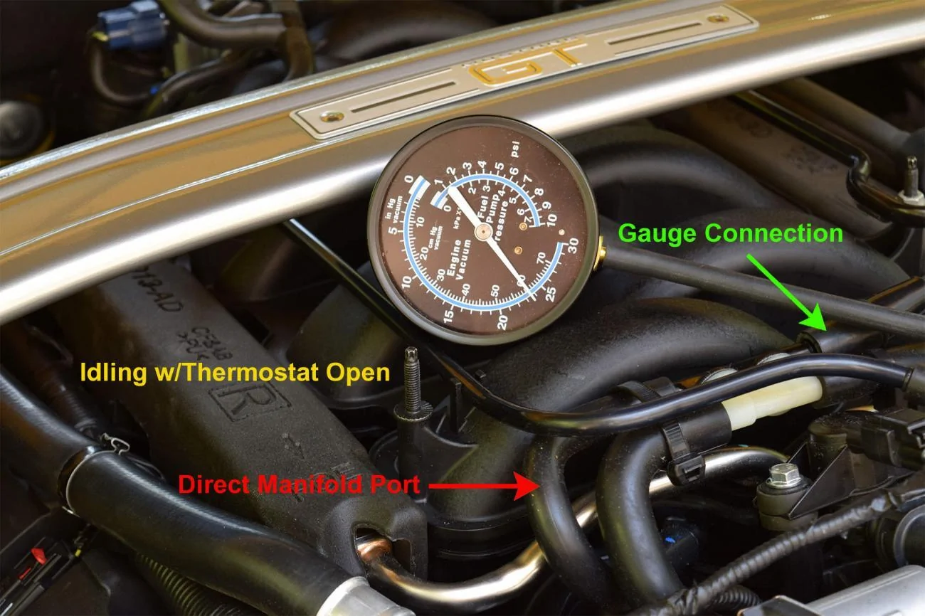

If any of you have the Performance Pack, pay no attention to the dash vacuum gauge. It will show a drop of about 4" vacuum at idle. This is probably due to the different manifold/throttle body. The gauge is electronic, and I believe it is being "fooled" by the new setup. Check for leaks and use a separate vacuum gauge right off the manifold tap. This is what I get off the manifold at idle:
I have had no problems with surging, hesitation, or tip-in. Put 600 miles on it since the install in traffic, on the freeway, and "down in Mexico". I'm running a JLT CAI with a 4" to 4" Vibrant
2718 silicone coupler to the GT350 TB. Tune is from Lund.
Can't stress enough about proper vacuum and checking for leaks. If that's what's actually happening... I don't think that it could ever be entirely tuned out.
