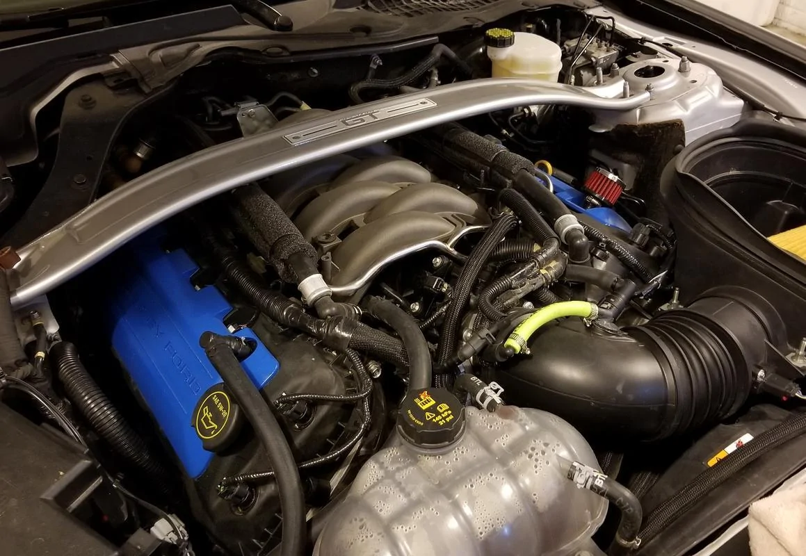

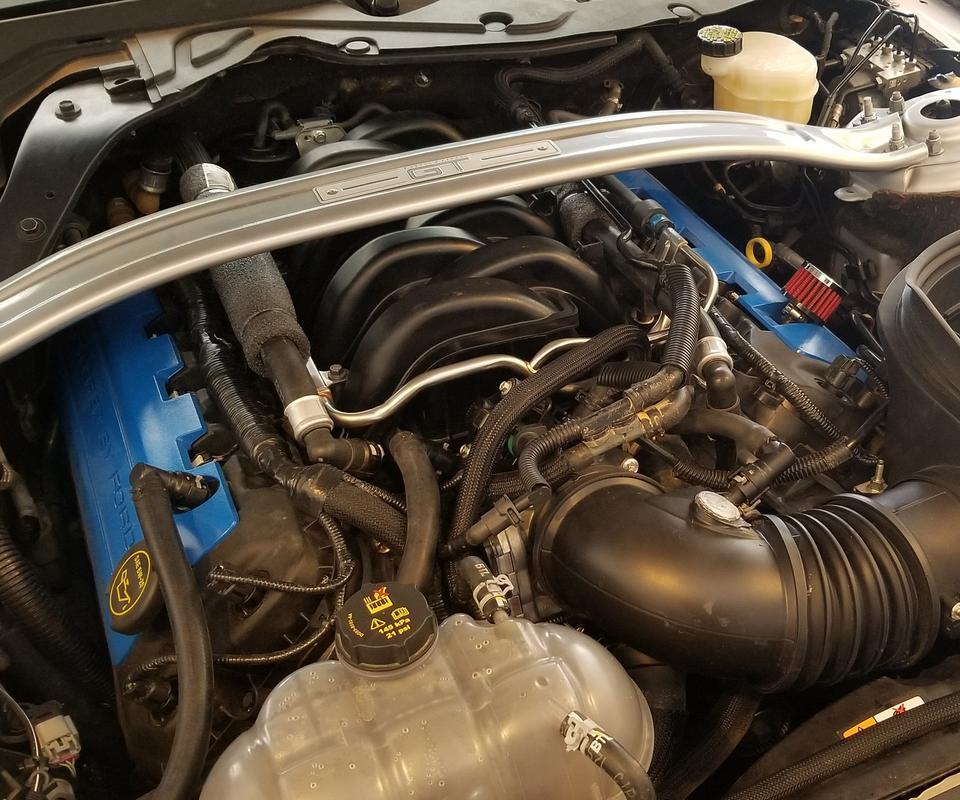

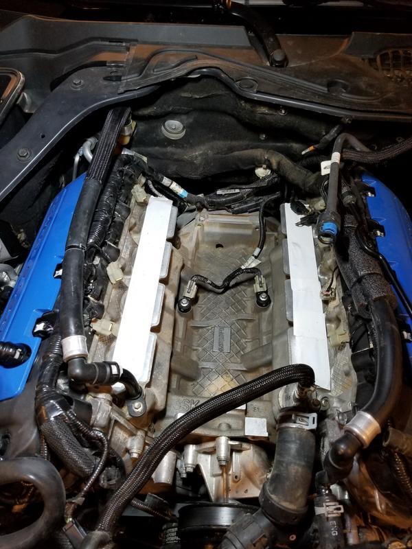

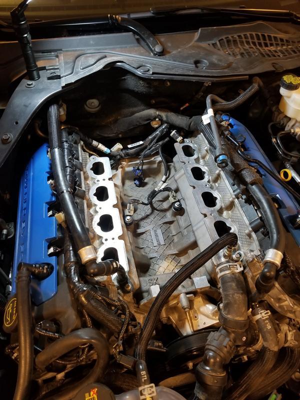

I also swapped an F-150 intake manifold on my GT, and it took me half an hour. Pics from my install below for reference.
BEFORE with stock 2016 GT intake manifold
DURING
AFTER with F-150 intake manifold

I recall having a hard time removing those metal clips from some of the hoses but was trying with an ordinary set of pliers instead of the dedicated tool for them. Also, the lines that run under/through the intake runners were annoying (1 especially as it had a plastic circular piece that required filing down to a smaller size to push through the F150 mani).
Either way, you need to be able to deal with situations as you come across them. It took me way more than half an hour btw but it was the first time and I have a tray with different compartments that I put parts and whatnot into with a piece of paper identifying where they came from for when it's time to re-install back so I try to be thorough and organized.
