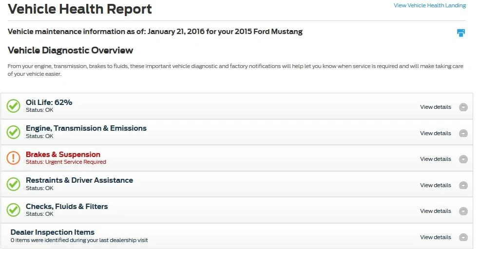

Hopefully I'm posting this in the correct area. Wondering if anyone has gotten this returned from their health report? I took mine into the dealer with this message and they told me 'not to worry about it, everyone has been getting that message, there is something wrong with the health report application.'.
One thing I do notice that is different... while in sport mode my traction control never kicks in any more. I can burn rubber all day. I'm going to take her back in but thought I would see if anyone else has been getting this also? Oh.. there is no light on, no warning light on, nothing looks out of normal on the dash lighting.

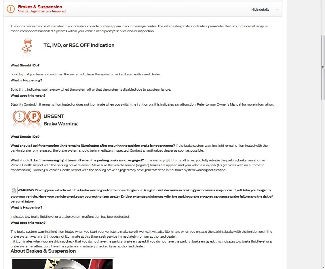

Make sure you are in normal mode with E-brake off during the reports else you will get the fault you did.

Hmm pretty sure I was but now of course. I must try it again. I've gotten it two times on my health report and so far as I can remember, I followed directions.

Latest update: Noticed there was an update waiting on MyFord site for the Sync application. So before updating I ran one more health report which still showed the same error. However after updating the Sync to the latest version and running a health report again, the error I started this thread with is gone.
Apologize for starting this thread but... maybe it will help somebody out in the long run.
I'm now on Sync2 - V3.8 after downloading and installing file EA5T-14D544-AD.
No mention of my warning issue being a fix or a known issue in the update documentation on the website.

Do not use your parking brake while running the report. It picks up the brake light being on so it throws the code.
