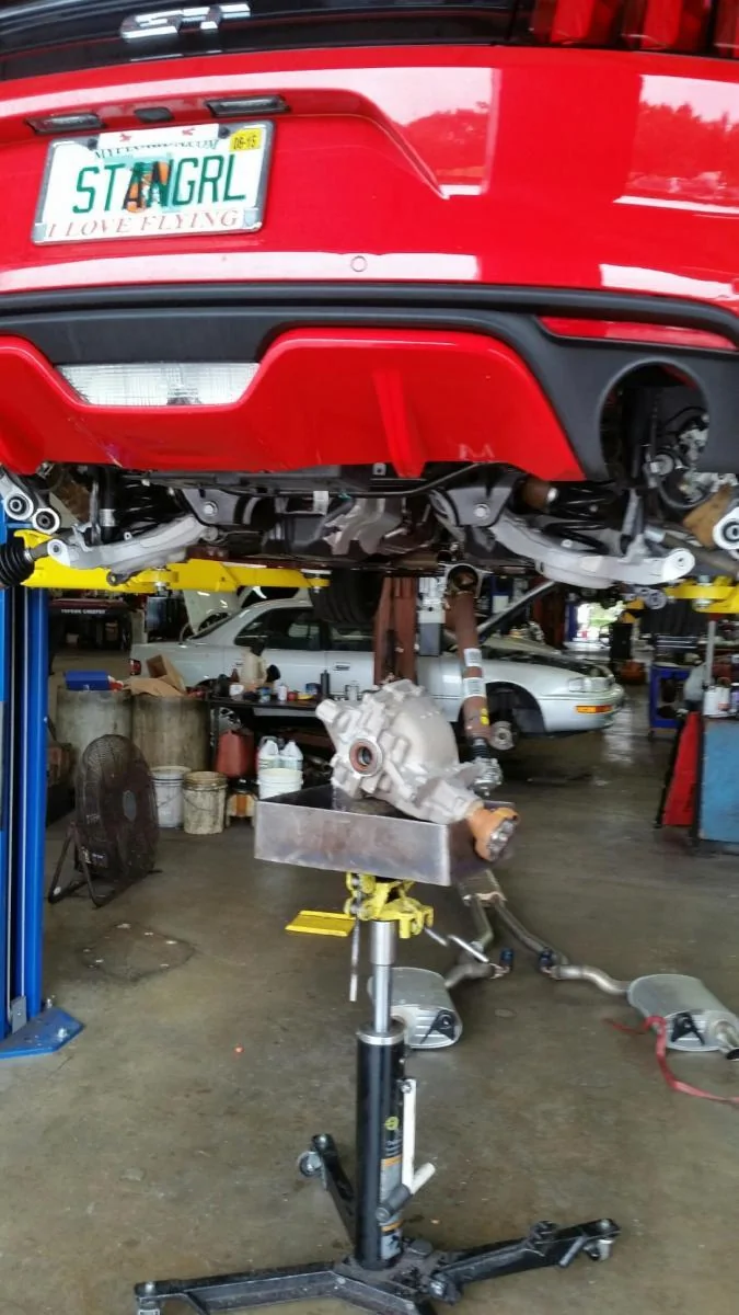

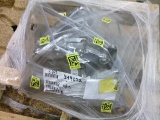

Here's a couple of pic's of the new 3:55 rear and the old 3:55 rear coming out of my Stang.. I am one of the unfortunate Stang owners with the vibration that starts at 50 mph... Hoping this new rear end doesn't have the same problem!!

Hope the new rear end has the pinion flange on it already and they don't re-use the old one. The flange is the one thing that fixed the problem on my car and a few others. Good luck!
This is her dad she is probably stalking the dealership right now :lol:I took the pic of the new rear end it has a pinion flange on it you can`t tell from the pic it was all wrapped up. Hope it solves the problem, she will let you know.:thumbsup:

Hi there! My build date was 2/15. I got my car back last night and no more vibration!!! YAY!!!
Thank you for making sure Dad!!! ;)
You probably saw my Dads (BOBS550) post, but yes, the new one included a flange!! Thank you!! ;)
