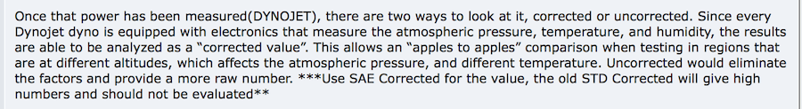

Here is the dynograph. The dyno tach signal is a little finicky sometimes so there is a small dip around 4.5K but that was false based on my datalogs.
Fuel is back on as we aren't on E30 anymore, so fuel is getting finicky but not 100% out of the question. We won't be making anymore power however until our fuel system is done, we are just pushing the limits now. As FFTEC stated the map sensor does need to be upgraded at this point and we will use whatever they sell unless we sort out a solution ourselves, but fuel system upgrade is priority at this time as we will be able to make more power with less boost in the future.
