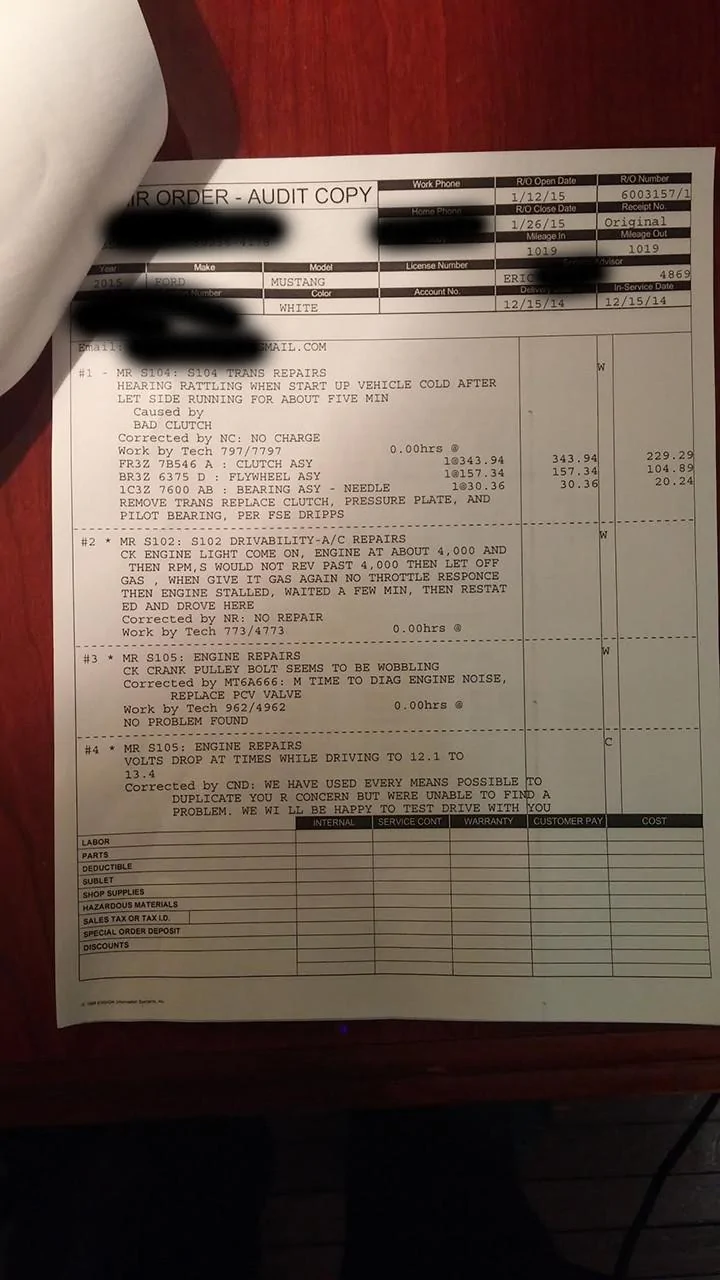

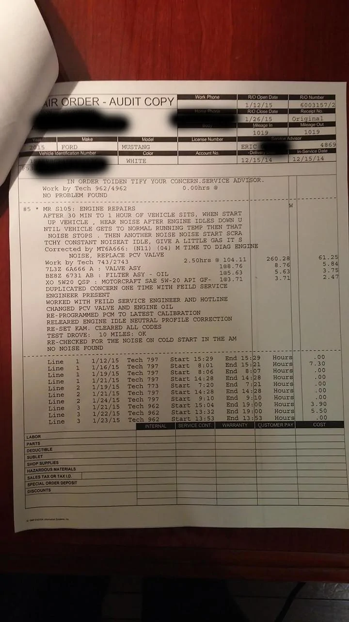

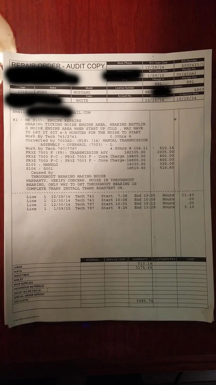

Posting these 3 Unsuccessful work orders for those that do plan on going in for service. Just something to look at when they say the problem is "fixed".
