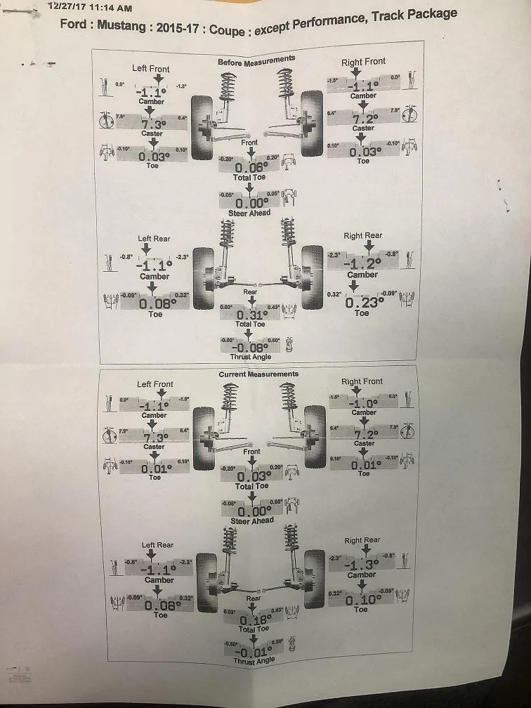

I noticed the car feels like it wanders in my lane, almost like I'm having to fight it sometimes. It's not the normal on rails feeling you'd expecting from a performance oriented suspension setup from the factory at Ford, so I thought, okay after 13K it might need an alignment. I paid the dealer to do an alignment and they said it was a little off, but it's all spot on now and they gave me the printouts so I could verify. Yet the car feels exactly the same.
