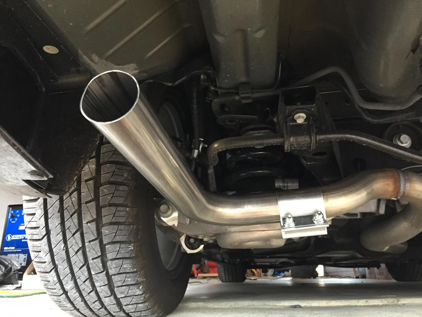

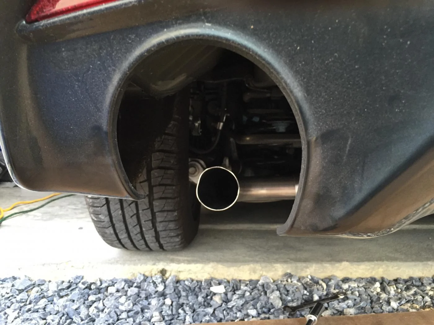

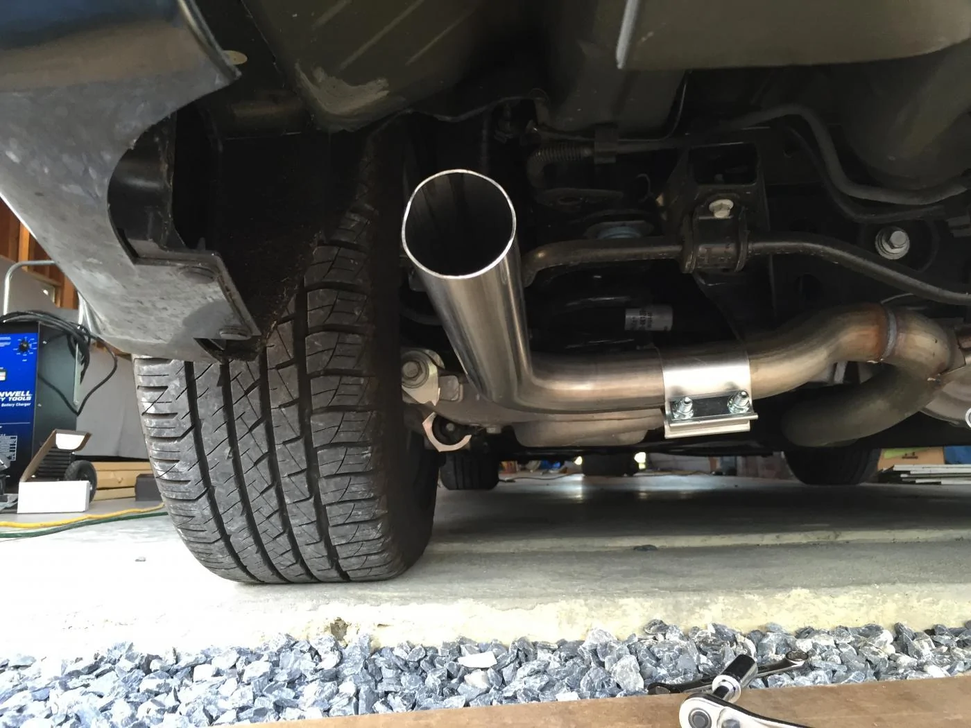

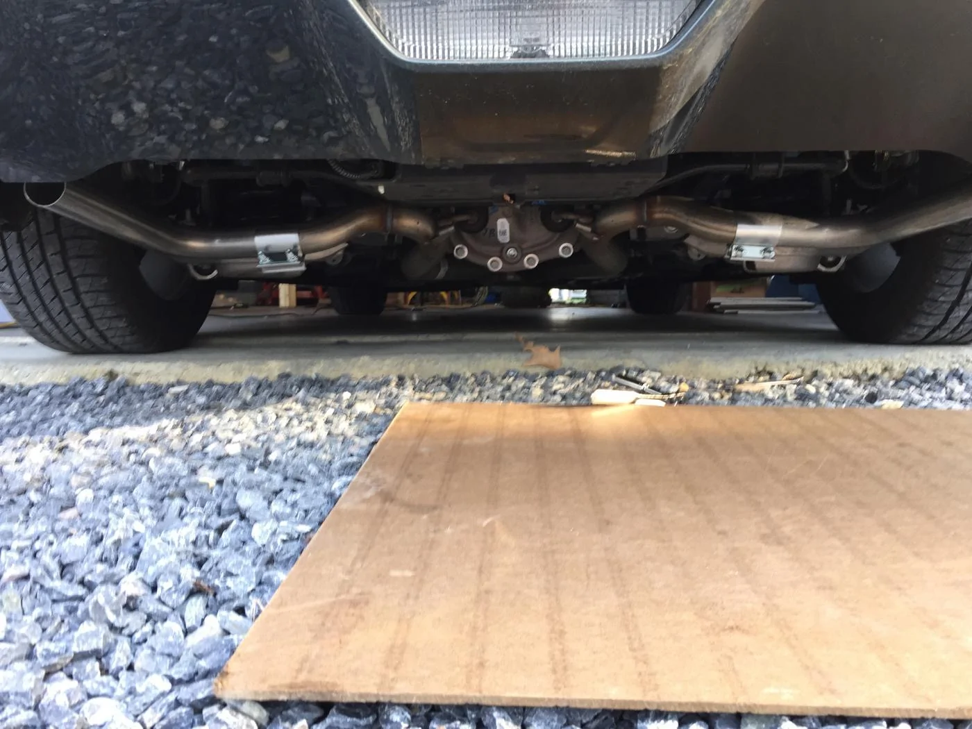

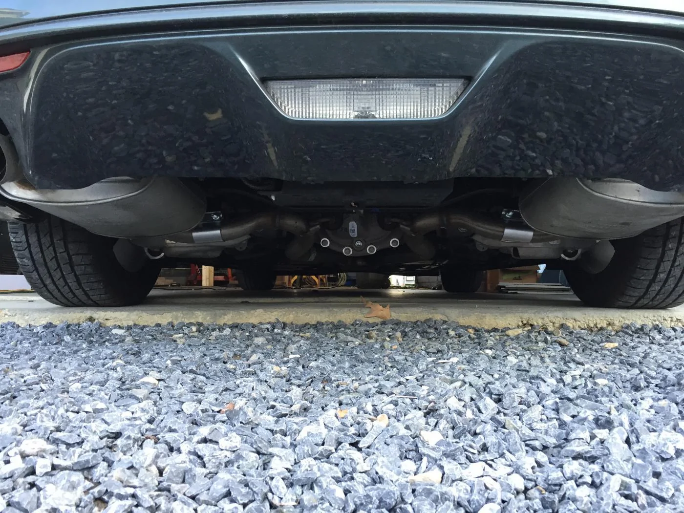

So I finally had some time to conduct my "experiment" today. This is what muffler deletes sound like for the 2015 V6. Drone is definitely present so I think some resonated tips or a straight through muffler like the race bullets are needed to tune the sound and remove some of the drone. This thing is quiet at idle though... Almost to quiet...
Idle and rev:
[ame]
Drone video:
[ame]
Pics of my setup (so far) with some 90 degree bends and band clamps. Now all I need to decide on is resonated tips or mufflers... Then I can complete my exhaust. As you can see in the last pic the OEM mufflers are back on for the time being.

Awesome, I'm going to do the same real soon. I'm anxious to see what you're going to put to complete your exhaust. Cherry bomb style resonator or magnaflow type muffler? It really sounds quiet even without a muffler at all. Would you remove the suitcase for more sound or would that be too much?

It would be interesting to see what happens to the drone if the pipe exit at the usual spot (without mufflers still) outside the car instead of in the middle of what is basically a fairly enclosed chamber.
All the walls around the exit of the exhaust give a lot of reflection of the sound and at some frequency / frequencies that is going to resonate / drone.

Well I just placed an order for some dynomax 12 inch race bullets. Basically they are a glasspack style resonator. I am then finishing it off with 3.5 inch conical walled slant cut exhaust tips. Your right about it sounding quiet though... Removing the suitcase would be an option to make it louder and I think at that point it would sound like the 2014 with a muffler delete. That suitcase is what is giving our V6's that unique rumble sound that isn't really present on the 11-14's.

I thought about this as well and tested it out.... Forgot to get a video... But what I can say is that it did help alittle but there was still a sizable amount of drone present. I think it would have been passible for most though.

The suitcase is that gigantic rectangular resonator in the center of all 2015 exhaust systems. This resonator also acts as a combination of a x and an h pipe crossover. This is what gives our V6's their unique exhaust "rumble" if you will that is not present on the 11-14's.
