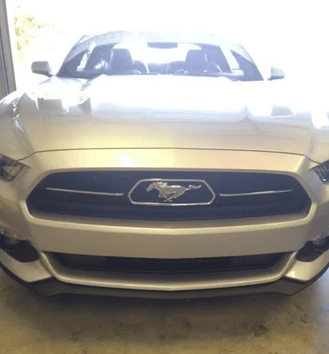

You can even see in this picture I posted yesterday that the gap was a little wide. But it looks better now!

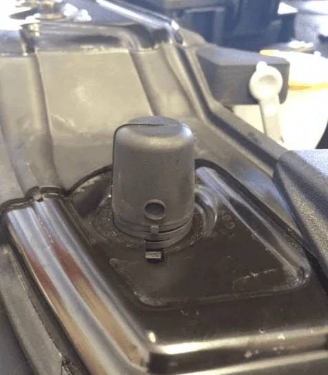

Here are where my bumpers ended up being (they were 2-3 turns out before). And a shot of the nose. The center was the same before (because the hood was latched), but toward the outsides of the hood, the gap was a great deal wider.

Yes. They will be hard to turn, but that's so they don't vibrate and turn on their own.
Turn them down quite a bit until they are too low. Then try closing the hood... it will probably be a lot easier.
Then you want to turn the bumpers back out until they just are touching the hood and putting a little pressure on it when the hood is latched. This is hard to do, since you obviously can't see the bumpers when the hood is closed. You just have to do a little trial and error - but you don't want the hood to move up and down when latched (this indicates the bumpers aren't touching the underside of the hood).
