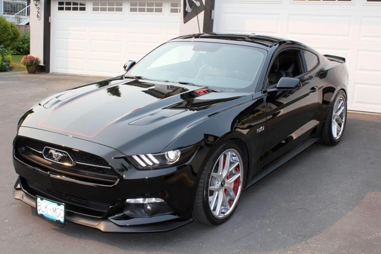

Right on the Money!
SVT-DADDY. Excellent write up! :cheers: why others don’t at least try this themselves is beyond me?? I did everything in the order you stated but... I wet sanded my car on and off for 3 days! A little at a time 2500-3000 grit then Menzurna 3000 polish then....you’re right clean, clean, clean! I love Eraser!!
I also used CQuartz...UK for out north western climate. Reload is excellent for the pop but....I also use their ECH2O....a detailed which adds an extra deep POP !! I did my wheels in and out and for all glass I used their FlyBy coating!
OMG....you wash the car, I’m a 2 bucket guy!! lol....and at the end I take off the nozzle and let the water flow....the result is a 90% dry car!! It is completely hydrophobic!! Amazing product!!
ALL THIS ON A BLACK CARlll. Thanx Bro, great write up !

An oldtimer used to tell me that the best black paint looks like a dead pond. I'd say you've achieved that!
I've actually been using reload mixed with ECH2O, thats the magic elixir. Not that your car can get any shinier but here is some info on it:
https://www.autogeekonline.net/foru...arpro-ech2o-reload-ratio-what-do-you-use.html
Good tip about the hose too.

Right on....I already had the Griots DA polisher...so with the exception of me going anal nuts and wet sanding..) the cost is around 100-150 as stated! All depends on what products you buy, how many nirofiber cloths do you really need?? (Can never have too many!!) just do it!!!! And post before and after pics!! I am forever getting compliments on the deep shine my Black Stang has....yesterday it was an older couple that parked beside me! She asked if it was special paint!!!!
