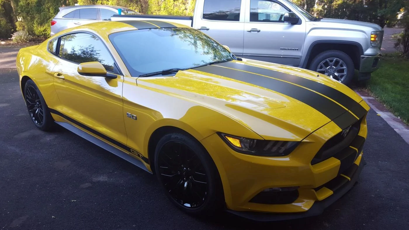

Step 1: Where necessary, 3M Trizact 3000 disc followed by 5000.
Step 2: Meguairs Ultimate Compound using a rotary polisher (agressive)
Step 3: Meguairs Ultimate Polish using a DA (Cyclo)
Step 4: P21S 100% Carnauba (coat 1)
Step 5: Wheel Wax
Step 6: Wait 24 hrs, second coat P21
The image quality has suffered when it was uploaded and much of the shine's impact has been lost...

Looks like you did a great job, thanks for sharing!
