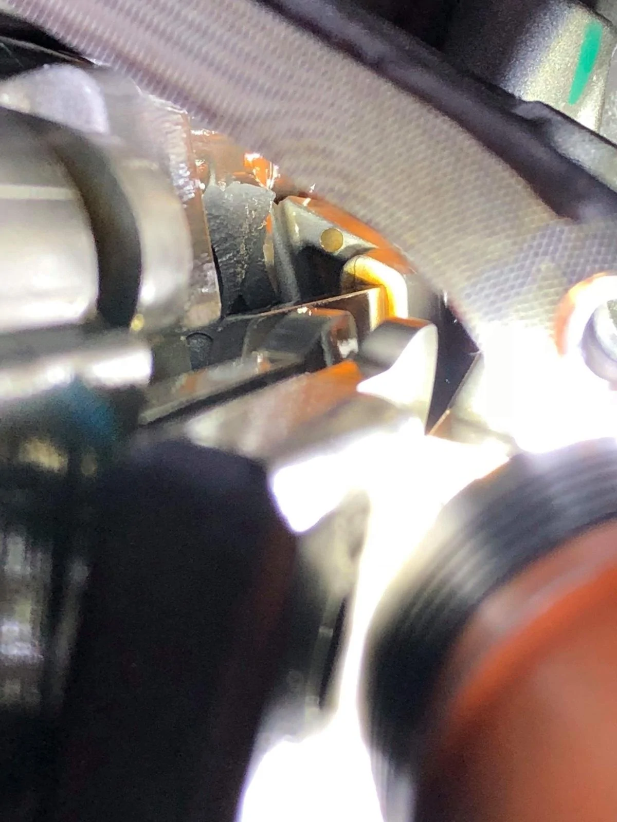

Welp, 7500 miles in, the MT-82 randomly decided to let go.
Was driving home after gas, went from 2nd -> 3rd at 40~ mph and just hit air, shifted to 4th, air as well.
(To appease others, YES THE CAR HAS BEEN TRACKED AND BEATEN ON IN THE PAST)
Both gears completely gone, no noise, no nothing, just gone.
Currently awaiting fords decision for warranty claim.
From everything I've heard its the "new and improved" aluminum shift forks in the 2018 MT-82's.
Anyone else have this issue?
UPDATE
3/4 Shift fork was found snapped, and laying in the Case, Master Tech say's its due to the aluminum shift fork design, as no other damage was found inside the trans Case.
Video for those curious : [ame]https://vimeo.com/271349925[/ame]

Haha, We shall see, the trans is out, and the issue was indeed the 3/4 Shift fork.
